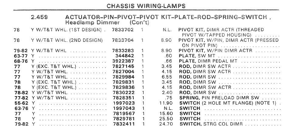

. I'm slowly building up a C3. I'm in the process of wiring it up and noticed that my steering colum (tilt) does not have a dimmer switch mounted. I have the lever and connector bar in the colum, but no switch. What is the difference between the various years models? I see there is a few years to choose from early 70s, 78-80, etc.
I dont know the year of the colum, the year of the car dosen't matter as nothing matches on the car and I cant match it as I dont have one to begin with.
thanks for any inputs/photos.

ON a 78 the dimmer switch is mounted down on the steering column and a lever connects the signal stalk to the switch. Pull back or push forward on the stalk operates the lights.

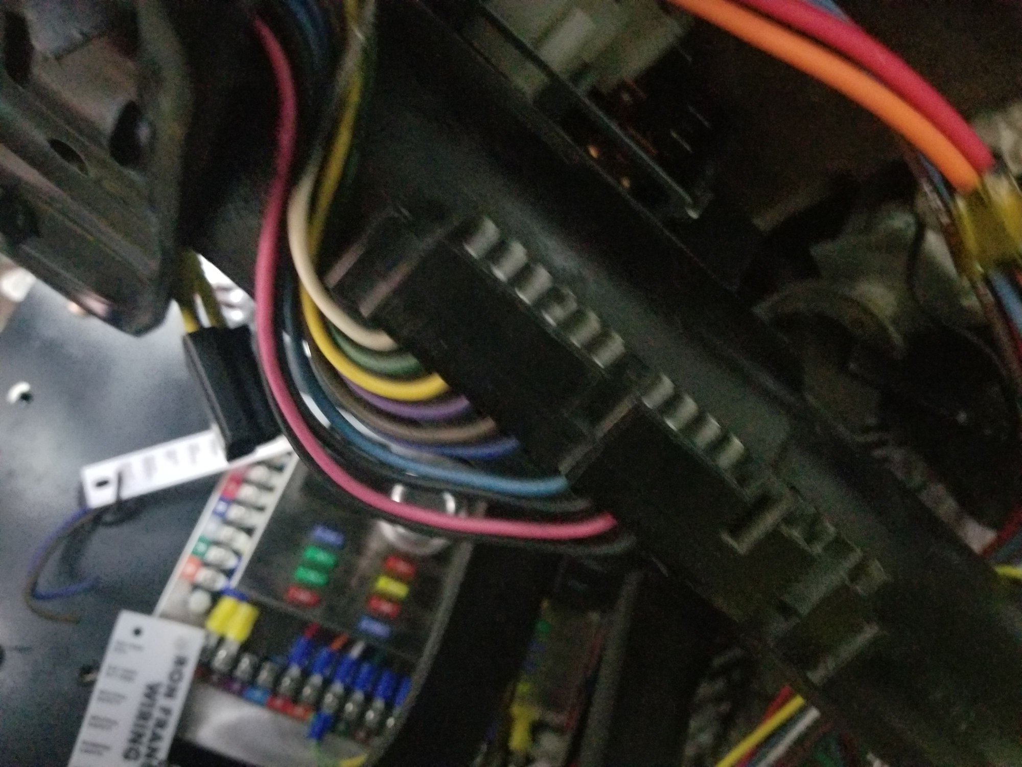

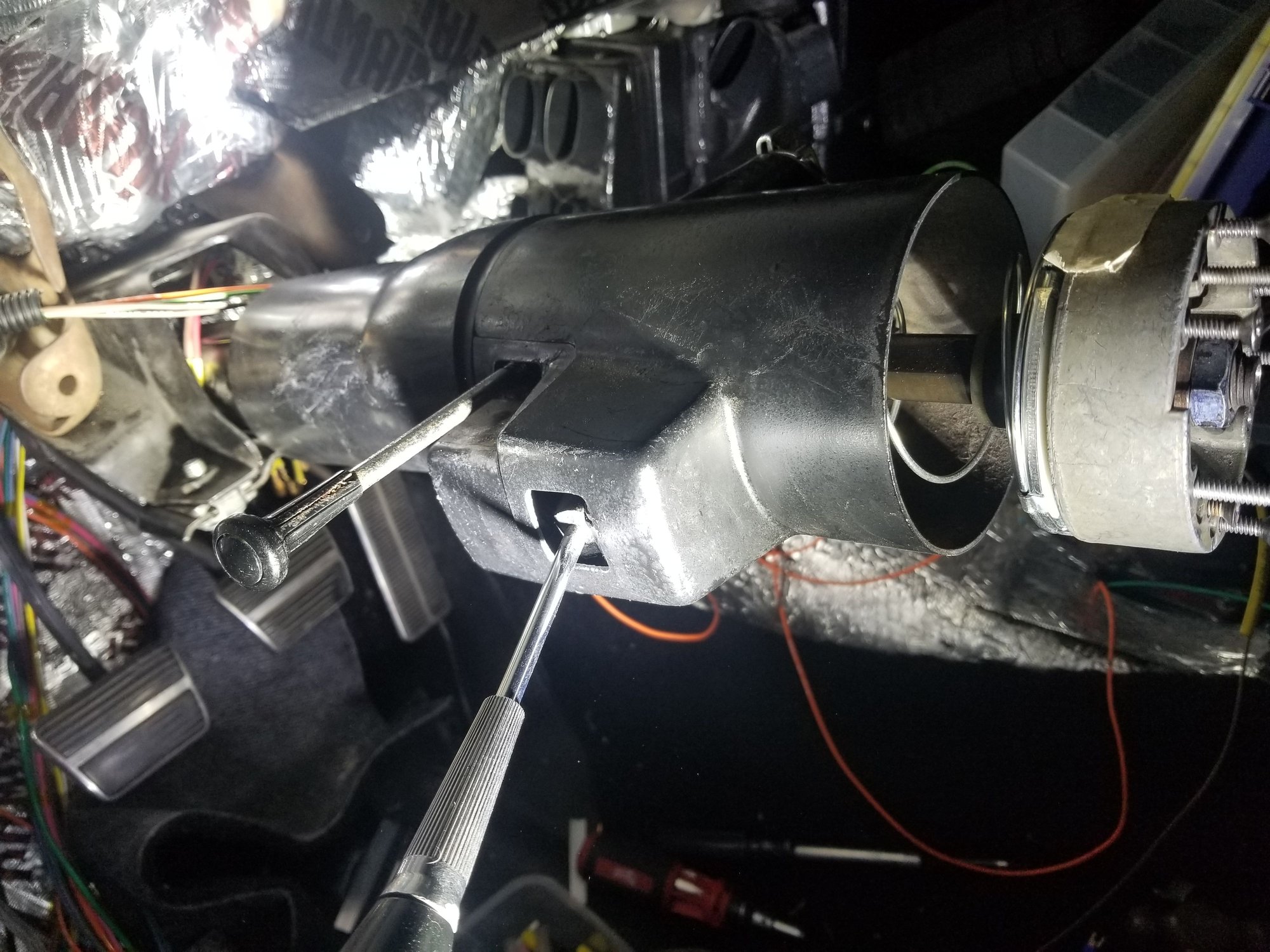

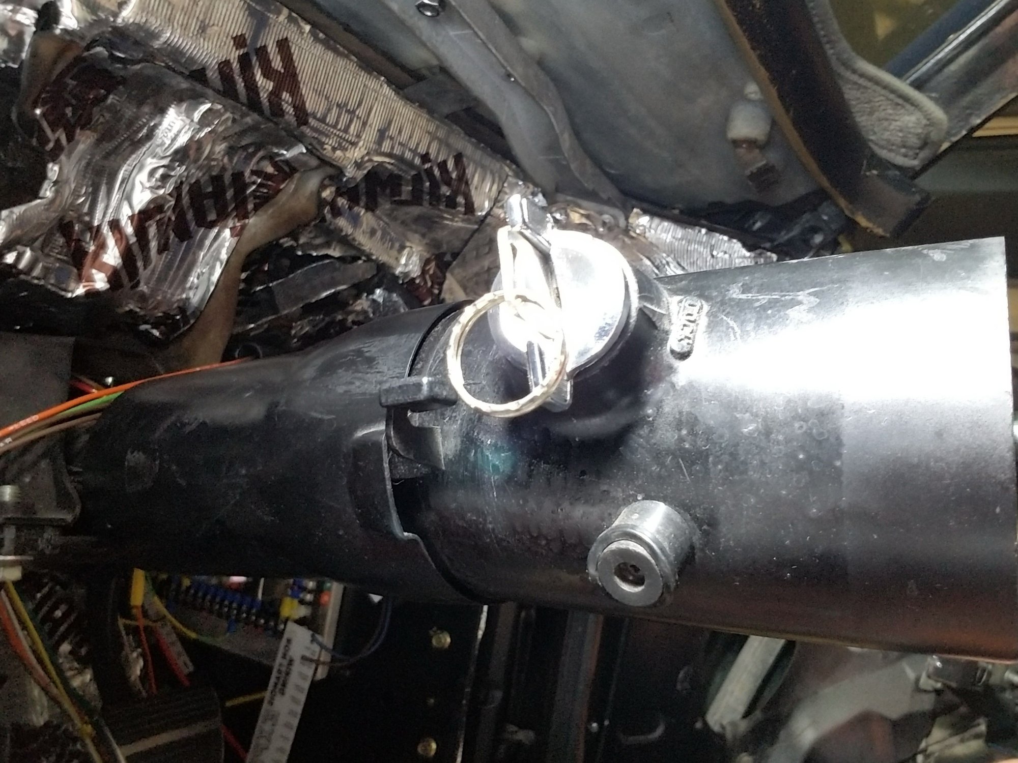

Thanks for any assistance,. Yes it's for the 68, but I think the only thing that's 68 is the frame. The body, judging by the corner lights, no chrome bumper and rear glass is more an 80-82.there is no spot in the floor for the foot operated switch.
here are a few pics, hopefully these are good enough to narrow down the year. Thanks for any inputs.
Driver side
Pass side
Colum connector, I still need to find/order other side as well.

There will be another switch along the top of the column next to the ignition switch. White plastic, and a small rod going into it from the top. That will be the high beam switch. Yours looks just like my ,78.

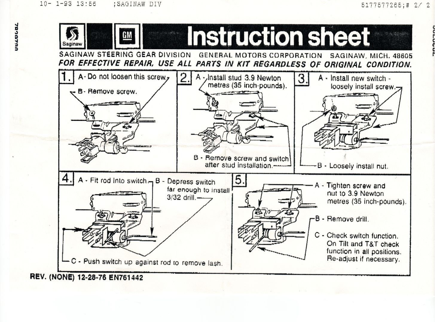

If you are sure it is a 78 dimmer switch it uses the same mounting hardware as the ignition switch.
Getting both the dimmer and ignition switches adjusted correctly is really important.
The turn/dimmer lever is mounted to a pivot bracket made out of pot metal.
If the dimmer switch is not correctly adjusted it can put extra stress on the metal pivot bracket and they do break.
Here are the mounting instructions you would receive with a NOS 7829781 GM switch.
A GM switch "Should" also come with the stud and nut shown in the photo below.
