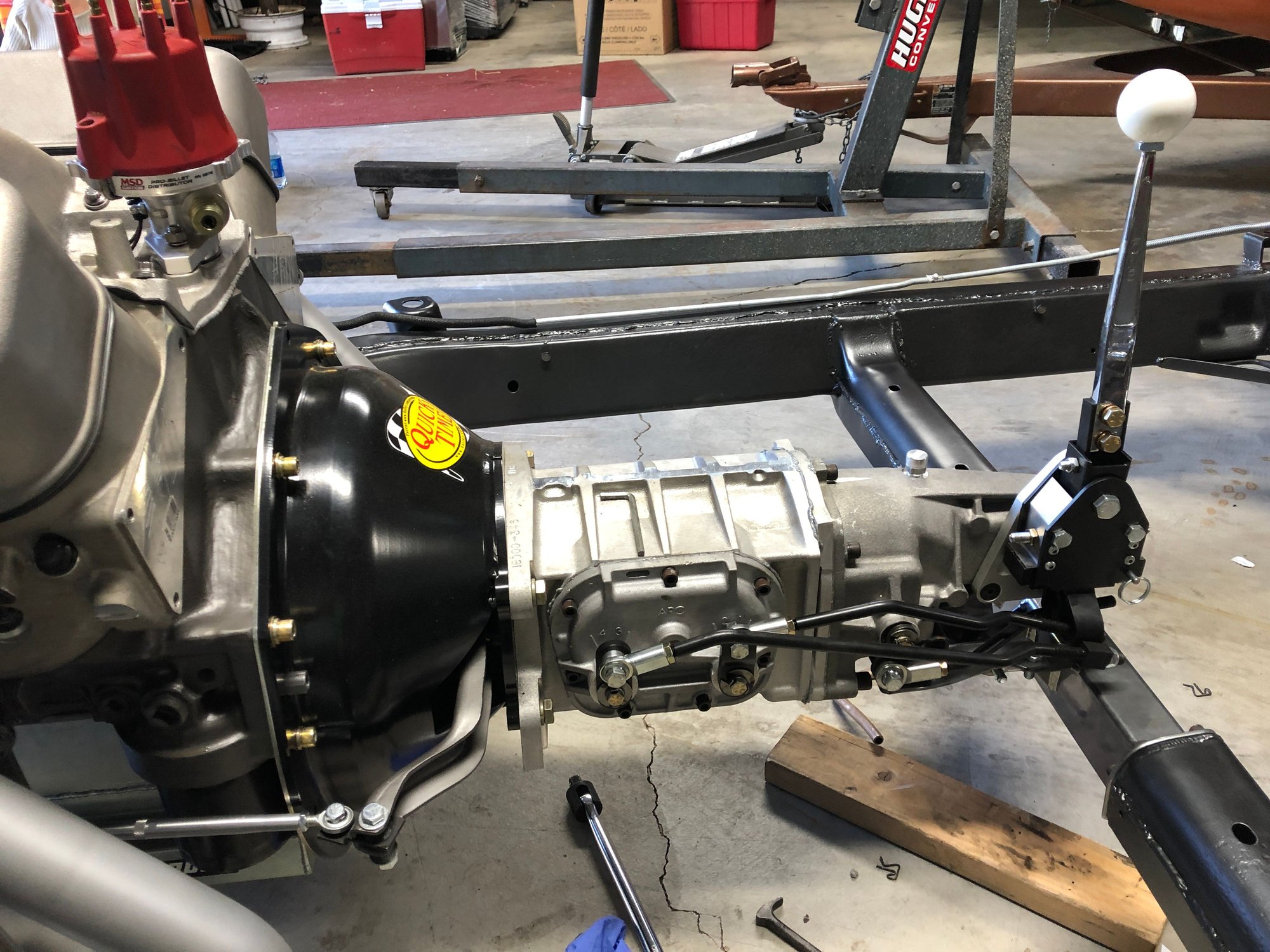

Yep... Let a little air out of the tire they said.... it'll hook up better they said.... goodbye trans and goodbye rear end

I understand what you mean the car has been built up over the years, fist by my father and now by me. Everything stock had held up to 600hp for 25 years! I recently rebuilt it and it came out at 650hp.... What happened from as far as I can tell is the driver side motor mount broke, twisting the drive train, this breaking the trans in half after that the rear followed.... Definitely going with a 6 link in the future.

Yup, seen it many times. Put an engine in a car that is double the power level the car is designed for, use the car that is designed as a road course car as a drag car or just abuse it and it turns into instant junk with the last dead hook or hard shift.
You have what appears to be a 68 or 69. The differentials in the 68 were worse than the 69's that were worse than the 72-79's, which aren't prefect since they had bad axles, ring gear bolts, and clutches. I don't even touch on the 80-82's since that engine would destroy the smaller parts in them very easily. There was no perfect stock differential made for a corvette between 1963-1982, they all had one or more issues. The only good ones are those that are built using the best parts and procedures and given enough abuse anything will break- 10 bolts,12 bolt, 9", aftermarket 9" IRS, so called racing diff's, all of them will break given enough power and abuse. We never thought 600hp would be commonplace back in the day of street 350-450hp cars.
The trans appears to be Super T10? cast iron cover and fine spline input, not a Muncie. They were both good street driver trans but rated at about 350 ft/lb of torque before the crack like an egg.
I doubt the motor mount caused the issue, the parts were already on their way to the junkyard, they just needed the final push. The cross shaft is bent, the spiders are 18's, the case was rough and sharp, the axles 17's.
The problem with "they" is "they" don't pay the bills, probably never built a diff or trans, and get all their info from online hearsay. "they" will tell you a 6 link will solve your problem it would not have stopped the carnage shown. "They" will say to use one of the Racers diff's because the websites are slick and most looking at them have no clue at what they're looking at. Some of "them" are outright conmen, some of "them" copied some of Tom's parts claiming they are better but failing to see the obvious flaw, and then "they" suck in all the cash they can when guys blow up their cars. I have plenty of pictures of the work of "them"

Good eyes. Yep it's a super T-10, I built it myself. Came out of a 700hp 77 Camaro Z28, I wouldn't exactly say it's twice the ponies...The rear I built myself. Ive touched every nut and bolt on the car! It's a 68 l89. Yes I have the original motor/heads and m21 trans, tank sticker window sticker etc. It was bought by the original owner (my dad) for the purpose of drag racing. It's been drag raced for 54 years. Has lots of Baldwin motion parts...I'm using it the way it's always been used....boy some Corvette guys sure are touchy.

Were the motor mounts solid or the sandwiched interlocked rubber bushed ones....do you have pics of whats left of those? I drag race mine but I dont let the air out of the rear tires so they dont hook as well as yours did obviously.

They were sandwiched interlocked rubber bushed ones. The salt flats is a dream of mine....rained out this year
