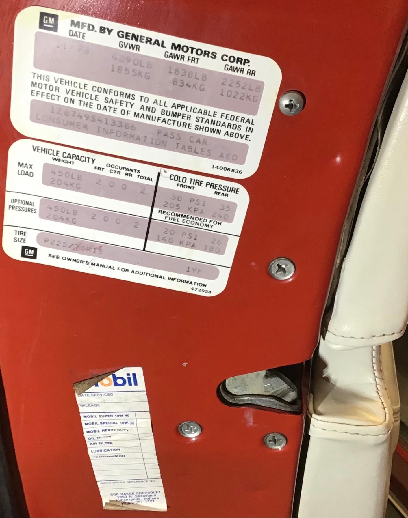

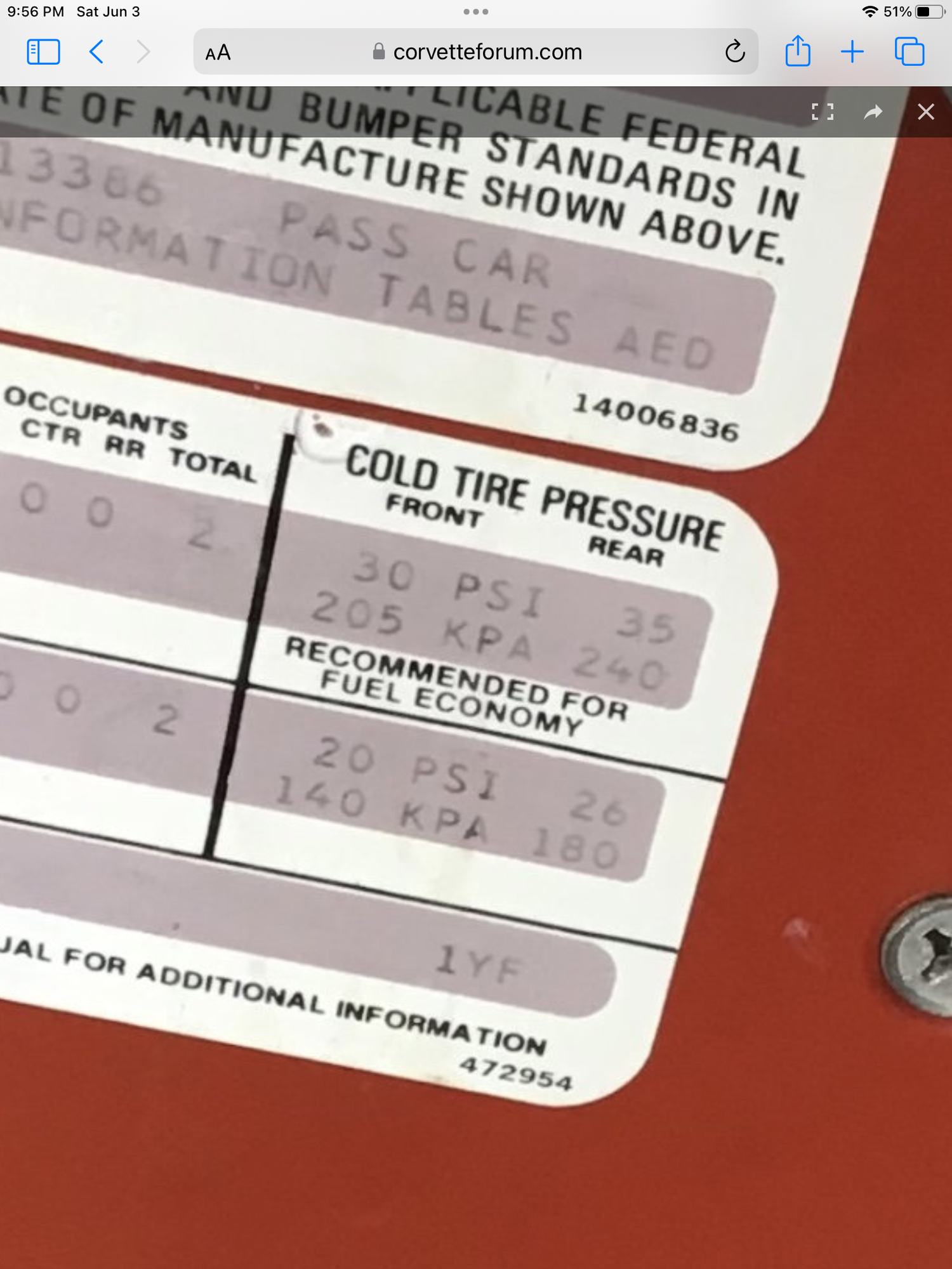

I used to run 20..i just upped them 2 psi 22/28 COLD so i don’t go below. I like the ride and no odd wear at all.
I put about 4-5000 miles a year and bet the tires still age out before any wear..
i wonder if the epa fuel ratings were the 30/35..
