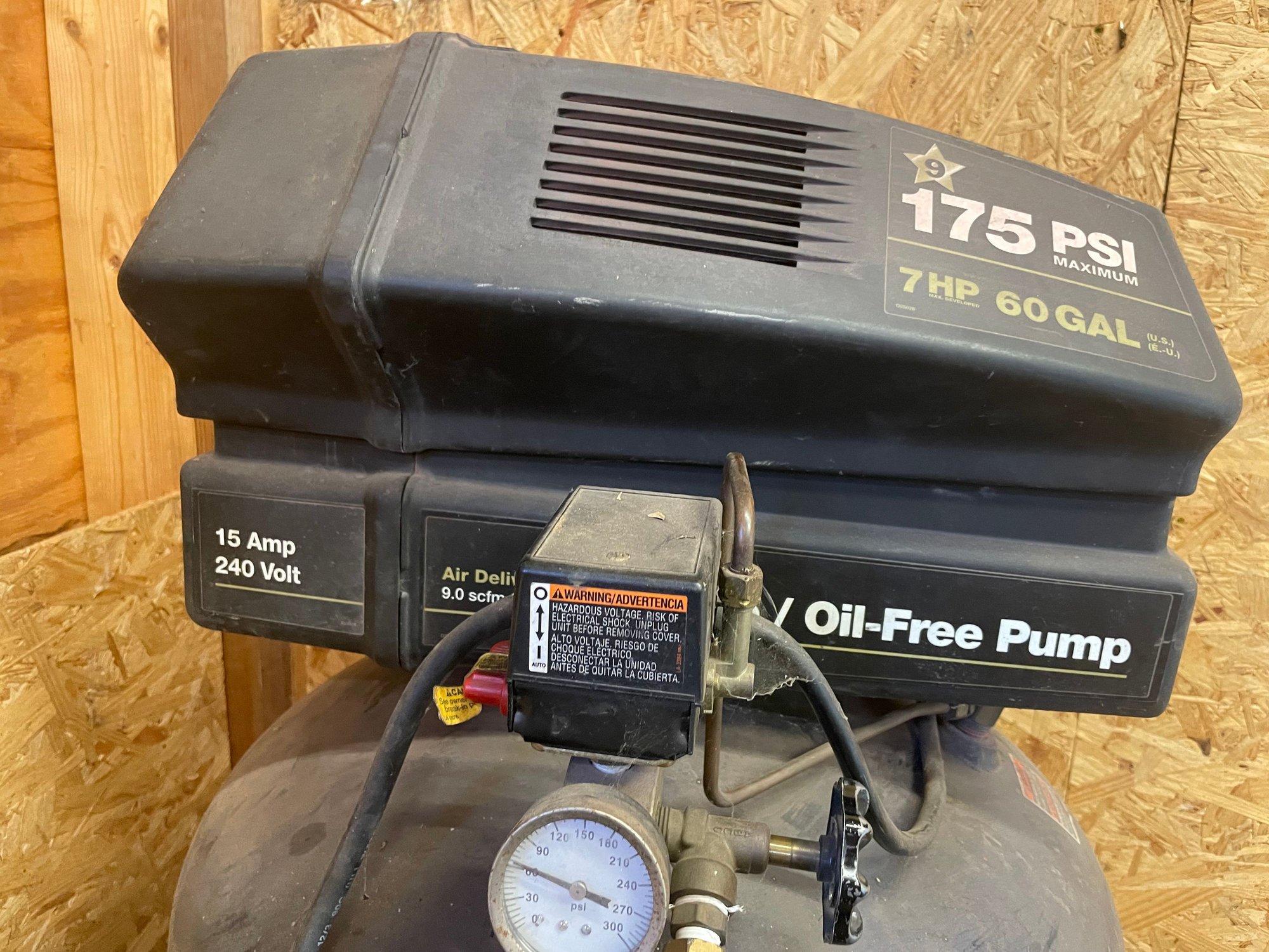

Forget repairing the pump you have. Chance of finding parts is slim to none. You need at least 12 cfm, and preferably a bit more, to spray paint. Forget the quiet oil free compressors as they're very inefficient as compared to standard pumps when judged by cfm per hp. And, when based on dollars per cfm, they aren't cheap. For example, you'd need 3 of the 2hp California Air Tools compressors to have enough capacity to spray paint reliably.
Since you have a 60 gal tank, it would be an ASME code tank. Regardless of brand, any compressed air tank 30 gallons or more sold in the US must be, by law, built to ASME code and stamped as such. That 30 gal start point is why you see a lot of compressors with 26 or 28 gallon tanks. Stay under 30 gal and you can market most anything as a compressed air tank with no requirements for construction or testing..
Next step is to determine the real hp of the motor you have. Forget the 7 hp rating as that's just a part of the lying that goes on in rating consumer products. If it is a 5 hp motor, the full load amperage rating will be somewhere between 22 and 25 amps @ 240 volts. If your existing motor is noisy, its most likely the bearings. Not difficult to pull it apart and replace the bearings. They will be standard metric ball bearings and a pair of electric motor grade sealed bearings would cost you less than $20. Check the amperage rating of the motor and post it here for guidance.
The HF 2 stage pump is $229 rather than $299. I replaced an old Devilbiss pump with one of the 3 hp HF pumps about 3 1/2 years ago and it has performed just fine. One thing you can do to lengthen the life of any compressor pump is to lower the operating pressures. Although my pump is rated for 150 psi, I have the pressure switch set to cut in at 95 psi and cut out at 125 psi. The pump will run much cooler, and there's no point in running at max pressure. At my shop where I make a living, I have both 10 hp and 5 hp compressors. Both are 2 stage and rated for 175 psi, but I have both set to operate between 105 and 135 psi. The 5 hp is a home shop grade compressor I bought at an auction 25 years ago, and it was at least 5 yrs old at that time. It stays on 24/7 and has never given any problems. I'm sure, if it was set to pump to 175 psi on every cycle, the pump would've been worn out long ago. Pressure is no substitute for CFM, and this is especially true when painting.

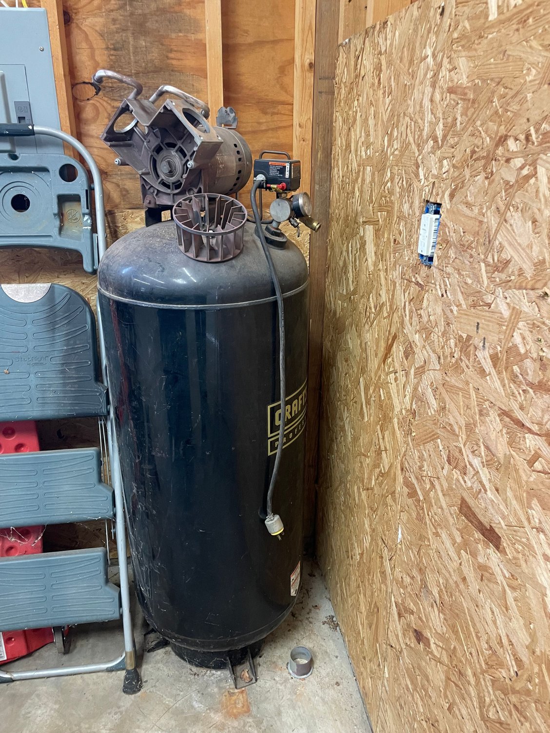

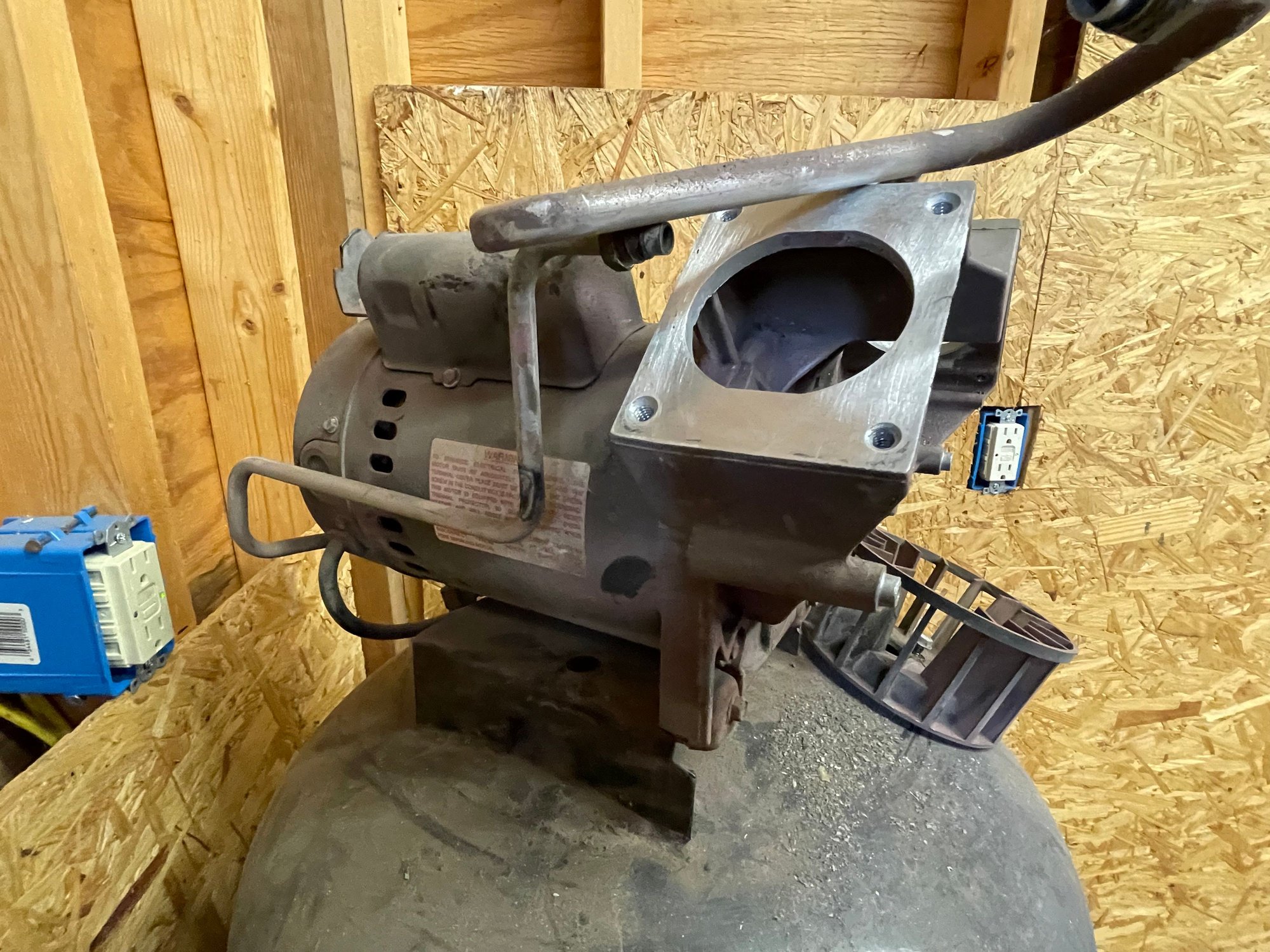

Old Feb 27, 2024 | 05:40 PM
ImBatman's Avatar
ImBatman
Joined: Oct 2000
Posts: 4,282
Likes: 172
From: Lake Wylie, South Carolina
Hey guys! Sorry I have been working a lot and not on things I enjoy!🤣

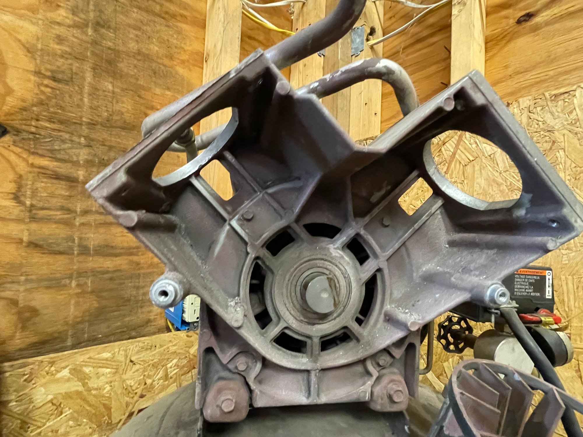

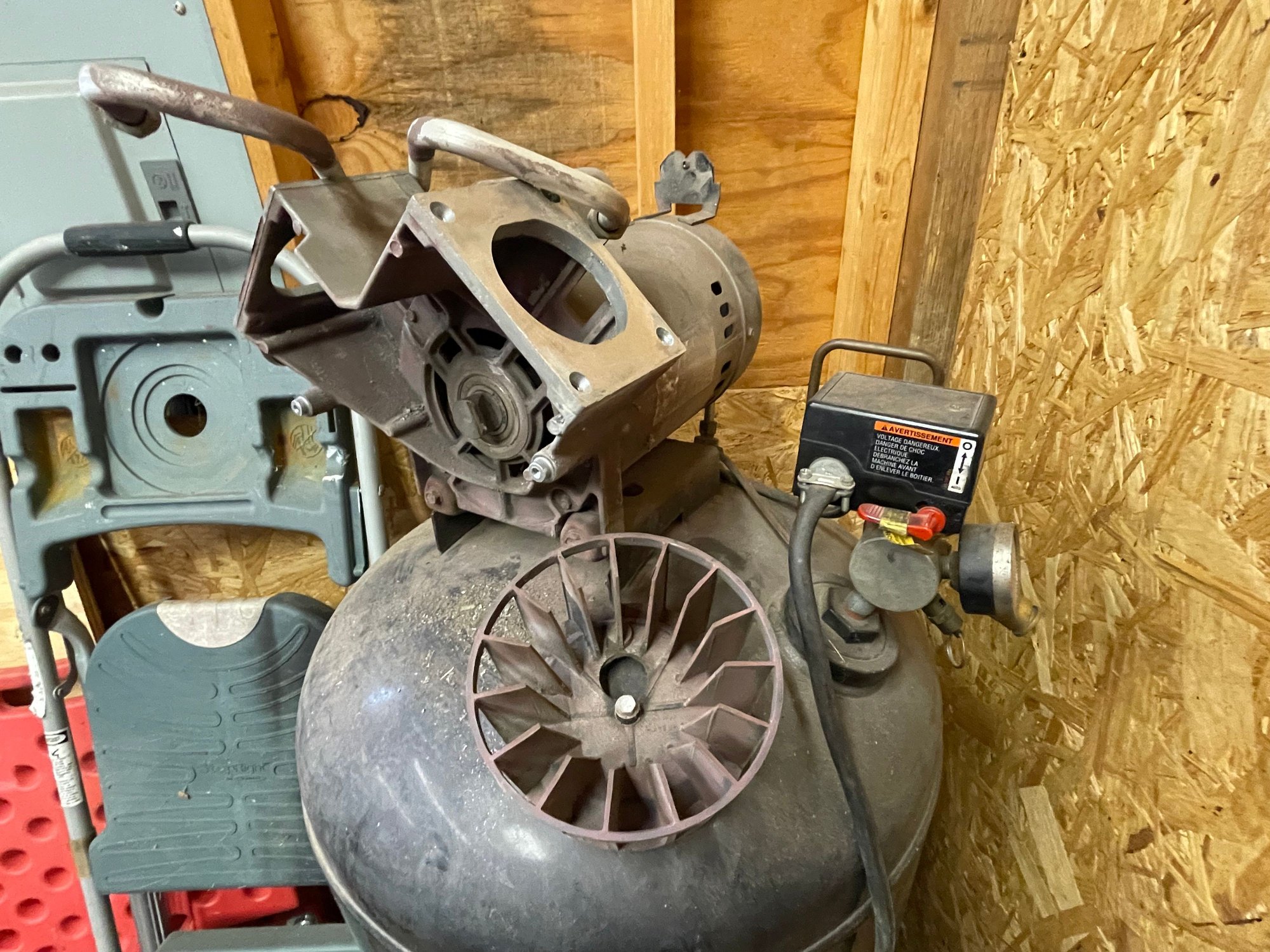

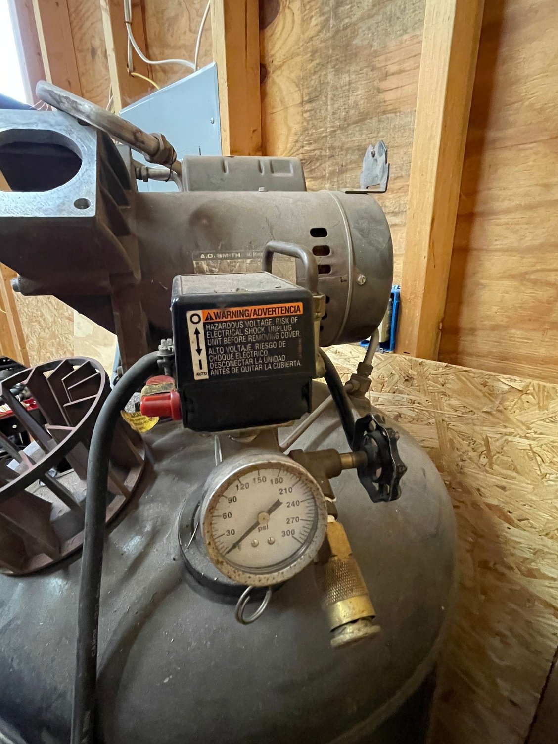

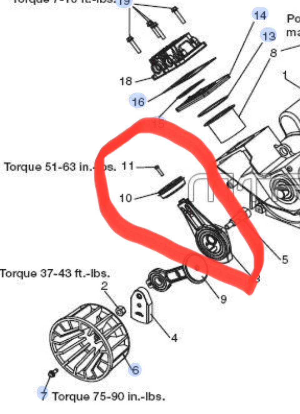

Here are pics of what I have. I know I cannot repair the pump because the ring I have circled is not available.
so after reading all the comments I’m thinking that I could take a chance on one of the HF pumps.
https://www.harborfreight.com/5-hp-1...ump-59672.html
Any idea if it will bolt up or need to be modified?

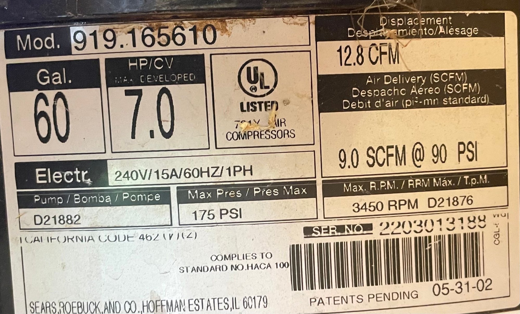

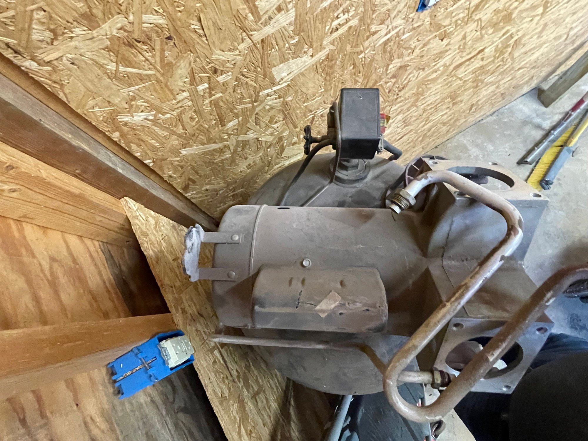

Welllll.... for starters, 15 amps at 240V is 3 hp. Those oilfree pumps are typically coupled directly to the motor, so it depends on the shaft configuration of your motor whether you can reuse the motor with a sheave and pulley for a belt drive setup. If the motor can be used in a belt drive setup, it should run the 3.7 hp single stage HF pump if you set up the pressure switch for 125 psi cutout. They're rating the pump for 3.7 hp at 155 psi, so it should be well below that figure at 125psi. Without having the cover removed to see how it is set up now, its sort of a guess as to what you might do with it.

I have the cover off. I can get more this afternoon and post them. If I can fix this thing I would love to.

I can’t find a direct replacement pump and the only parts still available are the sleeves and the non ring gap piston ring.
i hate to trash it if I can get a new pump. The motor runs fine and I know the tank was drained regularly and in good shape.
