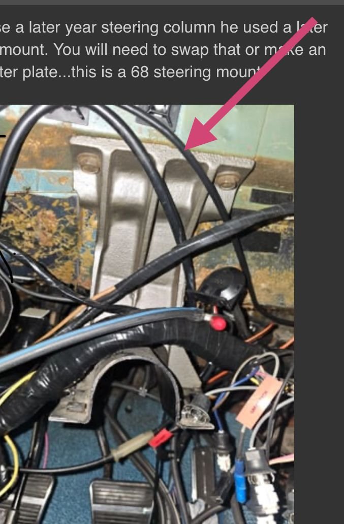

To use a later year steering column he used a later year mount. You will need to swap that or make an adapter plate...this is a 68 steering mount
I am almost certain I. We’d to also change out this bracket as even though I got the one from EBay things still don’t line up, that upper silver mounting bracket is too wide!

A better picture showing how the silver (upper) bracket in mine does not line up at all with my new 68 lower bracket.
Guess DUB replaced this too to accommodate the 77 steering column or am I missing something?
Any way to rig this to make it work??? Any other issues down the line to foretell?

Looks like he put this upper support in there and now I cannot source a 68.
can anyone telL ME WHAT ALL HE would have had TO CHANGE TO TRY TO put IN 77 steering column?
Obviously the supports, how far down and did the rag joint or anything else have to be changed?
Thanks for any input here.

Had hoped changing out the lower bracket would suffice but apparently the upper need to be changed too.
Now I’m “gun shy” that there are lots of other items that had to be changed to get that 77 column in there. I know none of the electrical stuff had been changed over yet thankfully.
But : is rag joint the same for both? Are there other mounts or fittings that had to be changed. If just those 2 bolt on mounts (assuming o can source) no problem. But if rag joint etc that’s going to be a big deal.

Thank you. No need as we know that they are totally different. The top 2 bolts onto the upper dash are the same but further down they differ. The later one is wider at the lower half and the 68 is narrower.
This is for 68. You can compare to the one below.

The splined shaft on the late 69 and up steering columns as well as the late 69 and up steering box shafts had a machined flat in the splined ends. 68 to early 69 steering boxes had round worm gear splined ends and the columns did also. As a result they used different rag joint flanges than those later with the flat. That 77 column of yours should have that flat. I guess there is a chance he changed the steering shaft in your 77 column but I would doubt it. Check your steering box too in case he changed that and see if the rag joint you have works with both your steering box and your 68 column. You would be able to see the flats on your rag joint flanges if they are late 69 and up.
