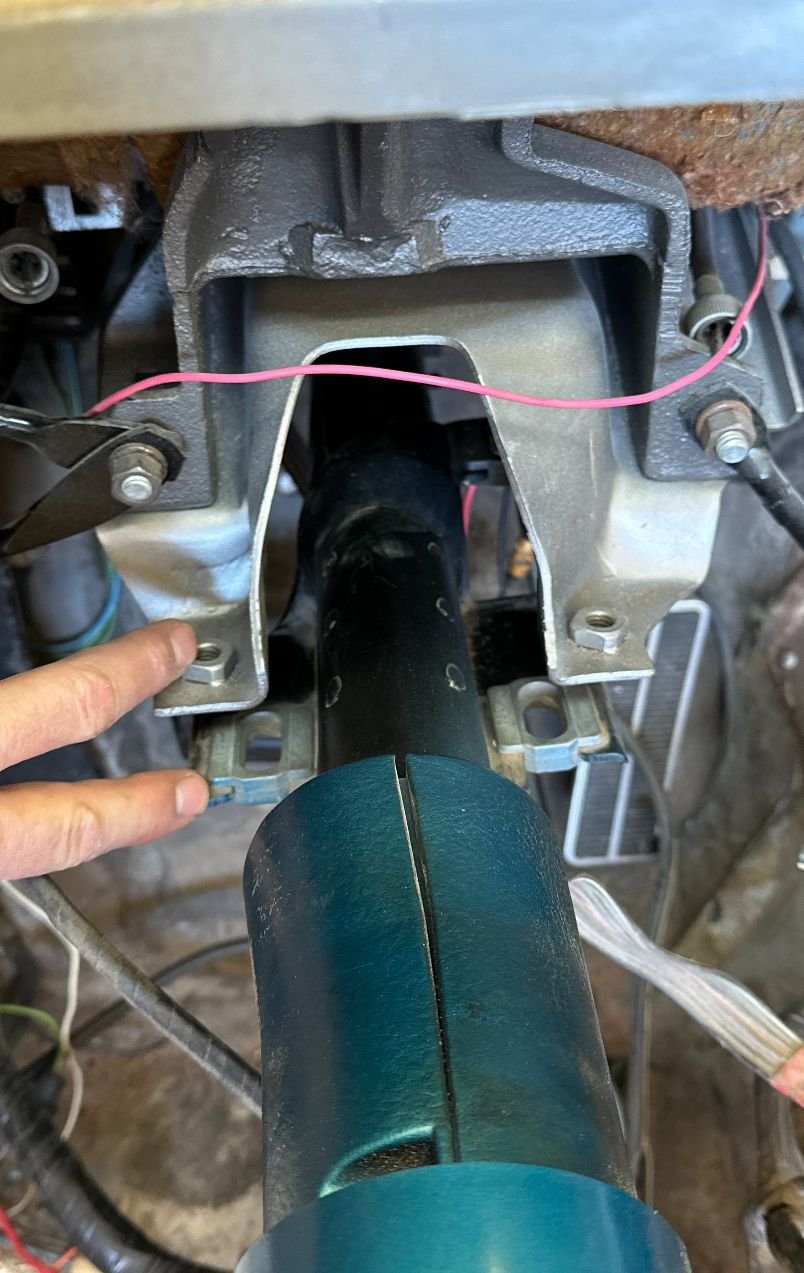

Need direction. DUB did some modifications and my original steering column is not fitting. Can someone help me determine what needs to be changed to revert back to original please. Picture is my current set up.
What parts are needed to make this work?

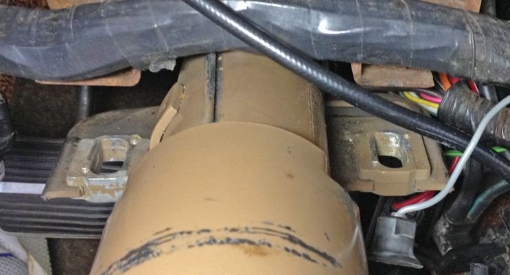

Mine is a 69, but I don't believe that there are that many differences in this area. It appears that a PO either narrowed the mounting location on the column or replaced the column with something else.
Here is a picture of what my 69 looks like, and it appears that it would bolt right into place.

Was original but DUB did modifications that I cannot ask him about as he has passed away. He had a totally different steering column on it and I am just trying to get it back to original. 🙁. Since I didn’t do it I have no idea what is altered or what is original.
To use a later year steering column he used a later year mount. You will need to swap that or make an adapter plate...this is a 68 steering mount

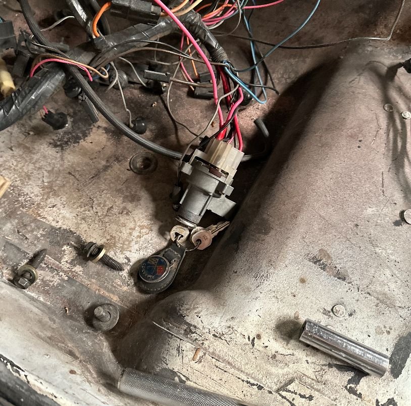

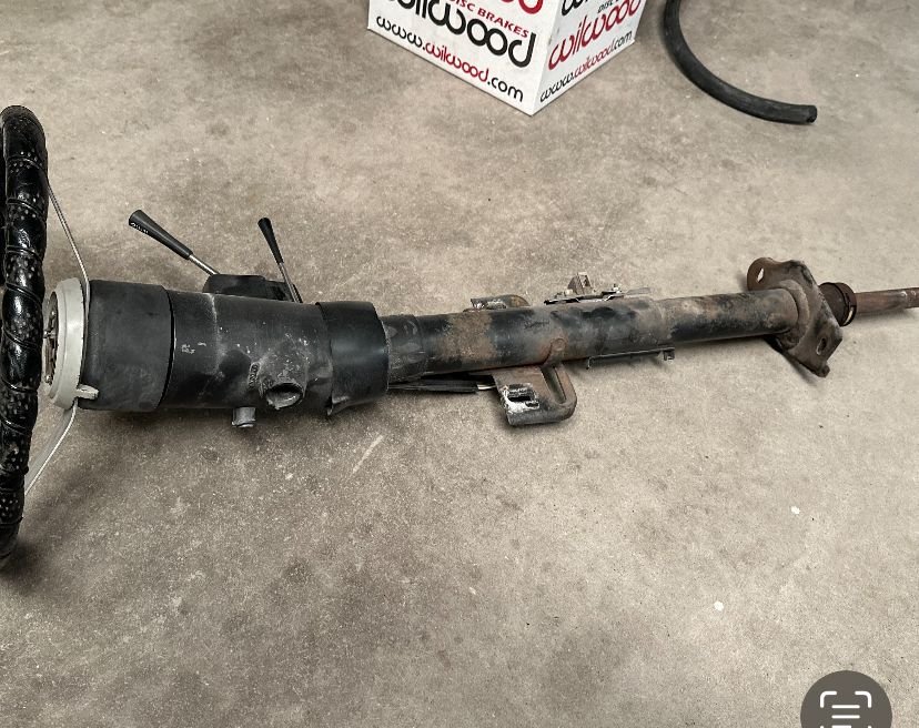

To provide more info: This was the steering column DUB put on my 68. No idea what year etc.
The key is on the column and not dash so not sure how this would be converted/modified.
Any input here would be appreciated.
Easier to put original mounting bracket on (have to buy one as mine lost) or modify to work with this newer column.

I guess cost is what ever you have in parts.....68 column needs a 68 dash with the ignition switch on the dash....plus wiring for that. And the 68 rag joint would be different at the end of the shaft and steering box.....so you need to figure out what he did down there. Ive been told theres a lot to swapping out the columns so I never looked past that.If DUB just swapped out the column and didnt change the wiring behind the dash, you could use a 69 column and remove the key switch and lock assembly and smooth it over so it looks like a 68 column.
Was the later year column you had working with the turn signals, high beam indicator and ignition switch? What does your dash look like? How far into this swap was he is what Im getting at to figure out what parts you need
No idea what’s working as no lights are installed either.
I’ll take a picture of the rag joint to see what is there too. I’ll have to get that and post up.
So lost trying to figure out what his plan/vision was. For some reason he was keeping things a “secret” to surprise me…. Count me surprised. 😮

That column looks to be 77 or newer. As a tilt/tele it definitely has some good value no matter the condition. I would definitely say at this point it would be easier to get the piece to mount your original column to the car and sell that column and 69 up bracket. I believe that rag joint is 69 up as well as I think I can see the flat on the top of the splines. That rag joint would have some value as well as it looks in good shape and the new ones aren't made the same. Do you still have the left side dash panel with the cutout for the ignition key?

I see the original switch and wiring so he may have just had it mocked up and didnt start cuttingnintobthe wiring. I think the rag joint may be 68 as well. If you can find the 68 mount and dash pad you should be fine. I would put the 68 column in, ground it, plug all the wires in and ground all the harness grounds. If the motor is in and the wiring connected to the starter, alternator voltage regulator and hornbrelay everything should get power.
Ground the light switch and Turn on the light switch. Your dash bulbs should light. Then turn the key to run, not start. Test your turn signals. Check voltage to the coil. If all that works your all set to start assembling the dash and column without wiring surprises

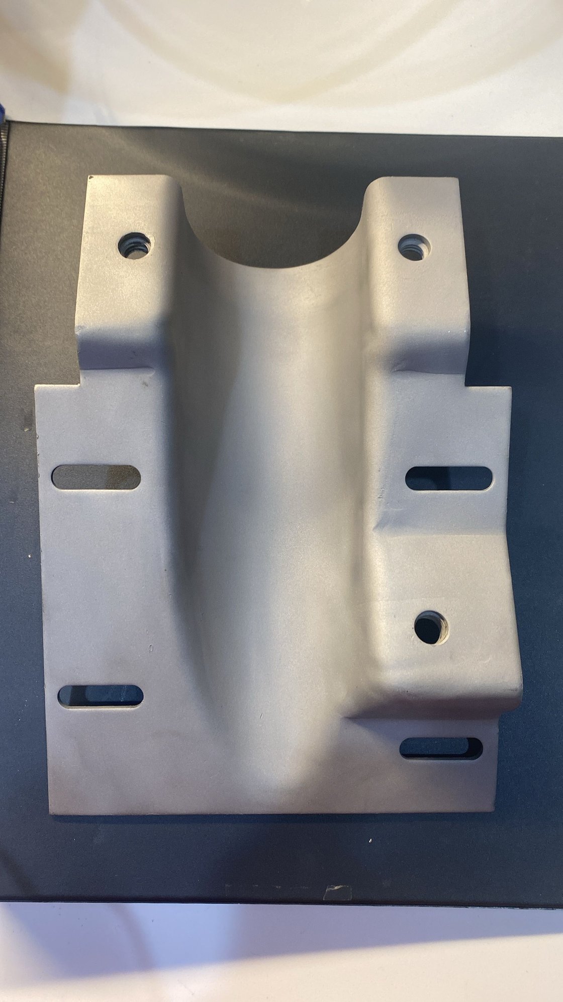

Thanks for the eBay find guys.
Got it in the mail yesterday.
Sandblasted today and plan to paint tomorrow if warm enough.

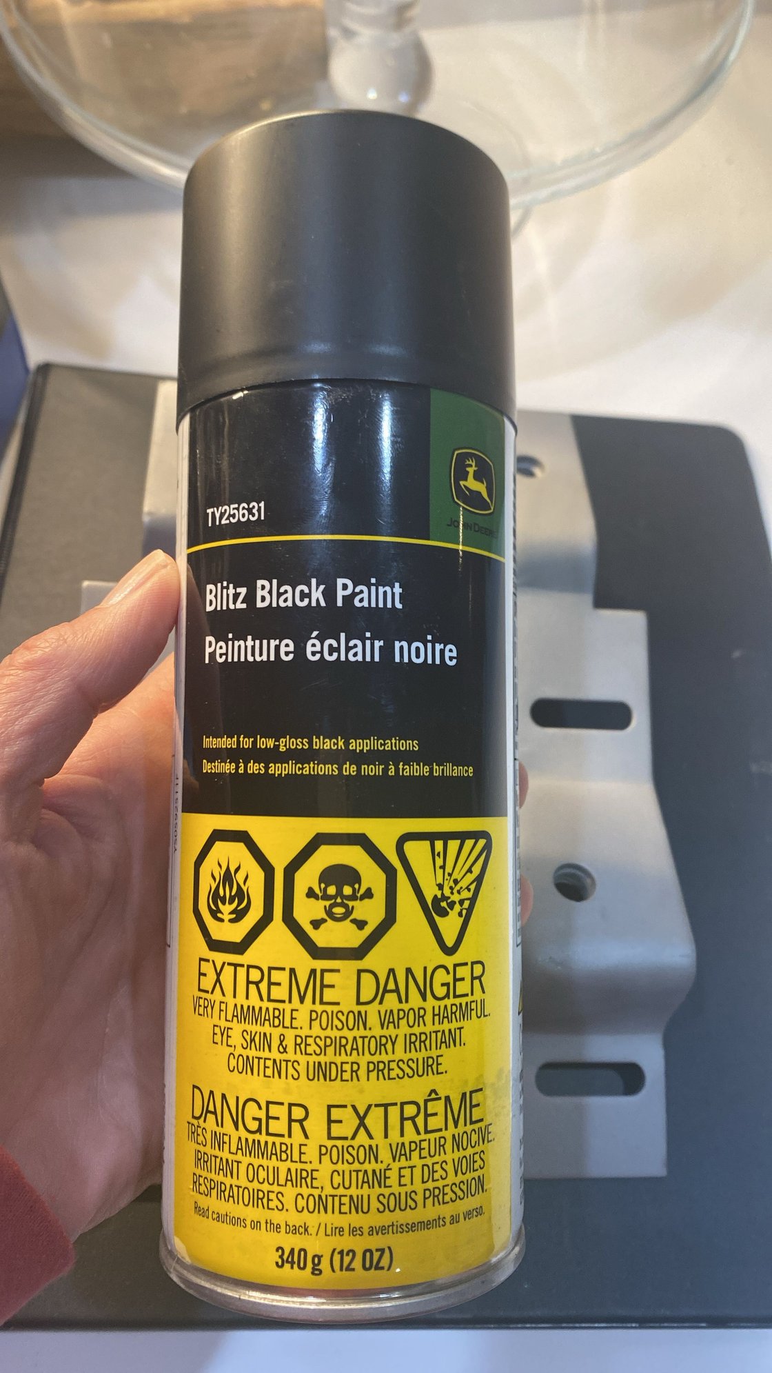

Thinking John Deere Blitz Black.
Can anyone confirm this would be a good choice?

Plan to sell the 77 steering column to help recoup cost of all the work and parts needed. Thanks for the input.
