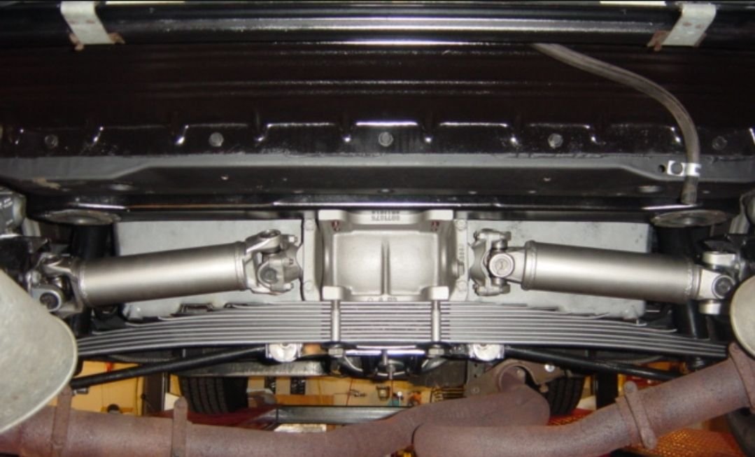

If the rear spring has the car weight on it and its arching up at the wheels, the spring is shot. At normal ride hight the half shafts should be almost level. And spring slightly arching down. Bolt length may very from 6" to 8" depending on history of suspension.
This us a sample picture for reference. The exhaust is disconnected in this pic.
