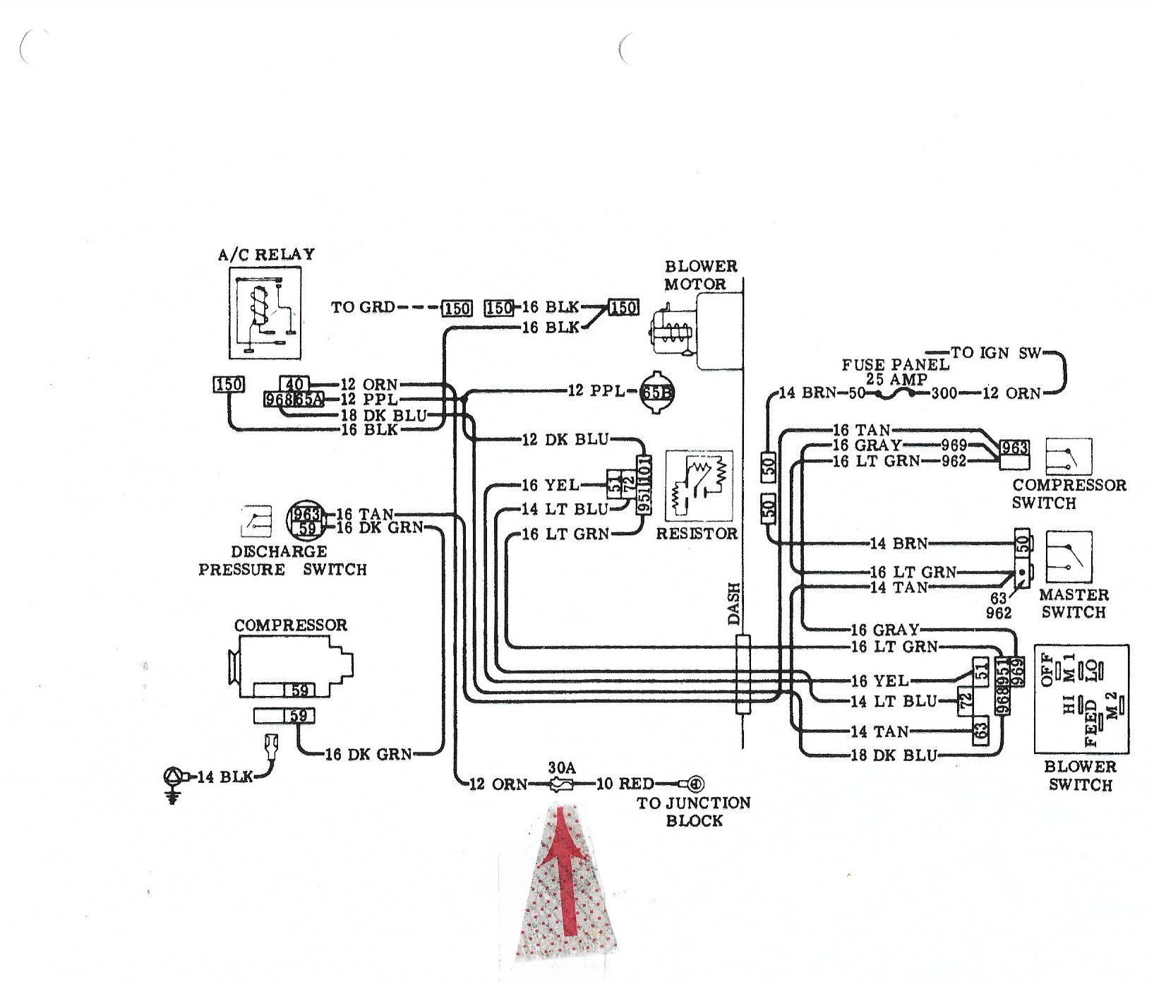

Default Is this the wire you're asking about?
The red wire comes from the Junction box (12 volts positive) and connects (at the in line-fuse) to the ORANGE and brings power so the fan can run at hi speed.

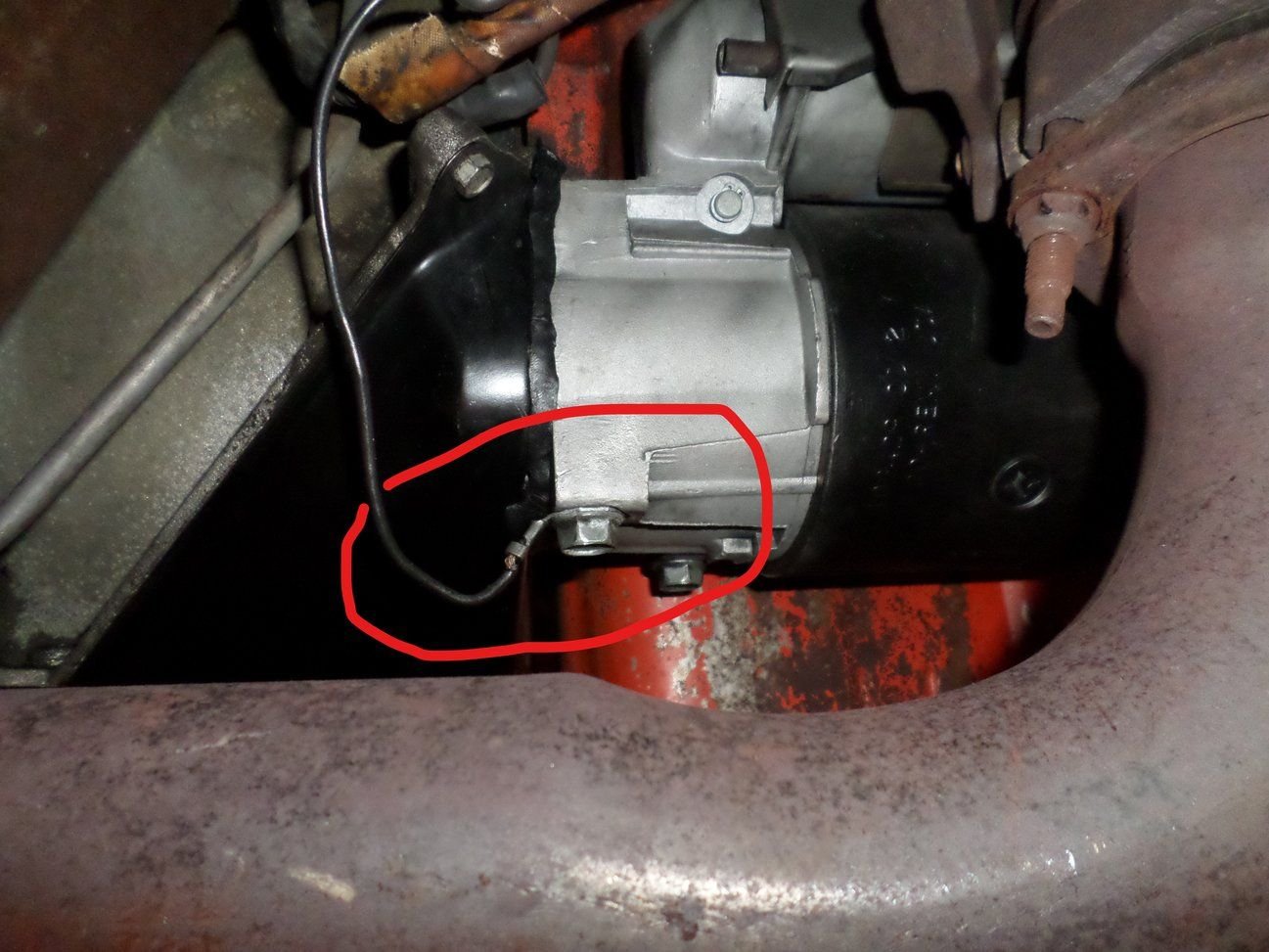

The blower motor ground wire comes from the starter motor.
It should be connected to a starter or bell housing bolt.
Did a PO splice your mystery orange wire into the black wire for some unknown reason?
