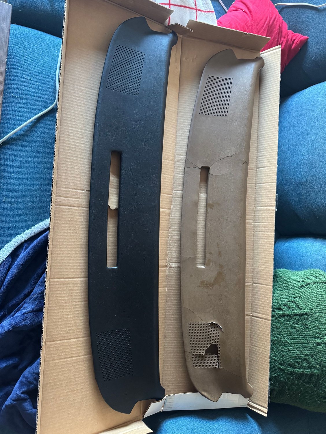

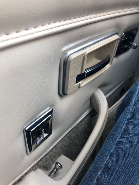

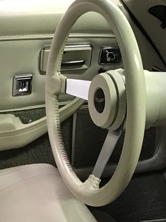

i have redone my whole interior with SEM color coat made sure i followed all directions and put 3-4 coats on everything. when it came time for the dash mine had cracks in it so i posted here asking who’s better and i went with Al knocks. i called Al knock and ordered it to be sprayed in the SEM paint code that i was using an got off the phone happy an excited. well after 6 weeks an a phone call i finally got it. one it showed up not sprayed to color and was very light in some areas to the point where you could see the black showing through and some scuffs. called them sent it back and sent them a picture of what i was using. well yesterday after two weeks later it showed back up with scuffs and still doesn’t match looks like they did one quick coat with little prep. i has dust specs in it and just at a loss for words. $758. was the cost shipped an now i have to re-spray it myself. i would be embarrassed to put my name on something of this quality. gonna call them on monday but what’s the point they already messed it up twice. very let down!

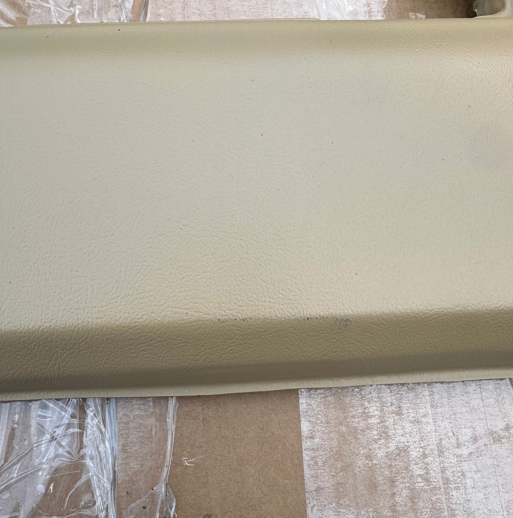

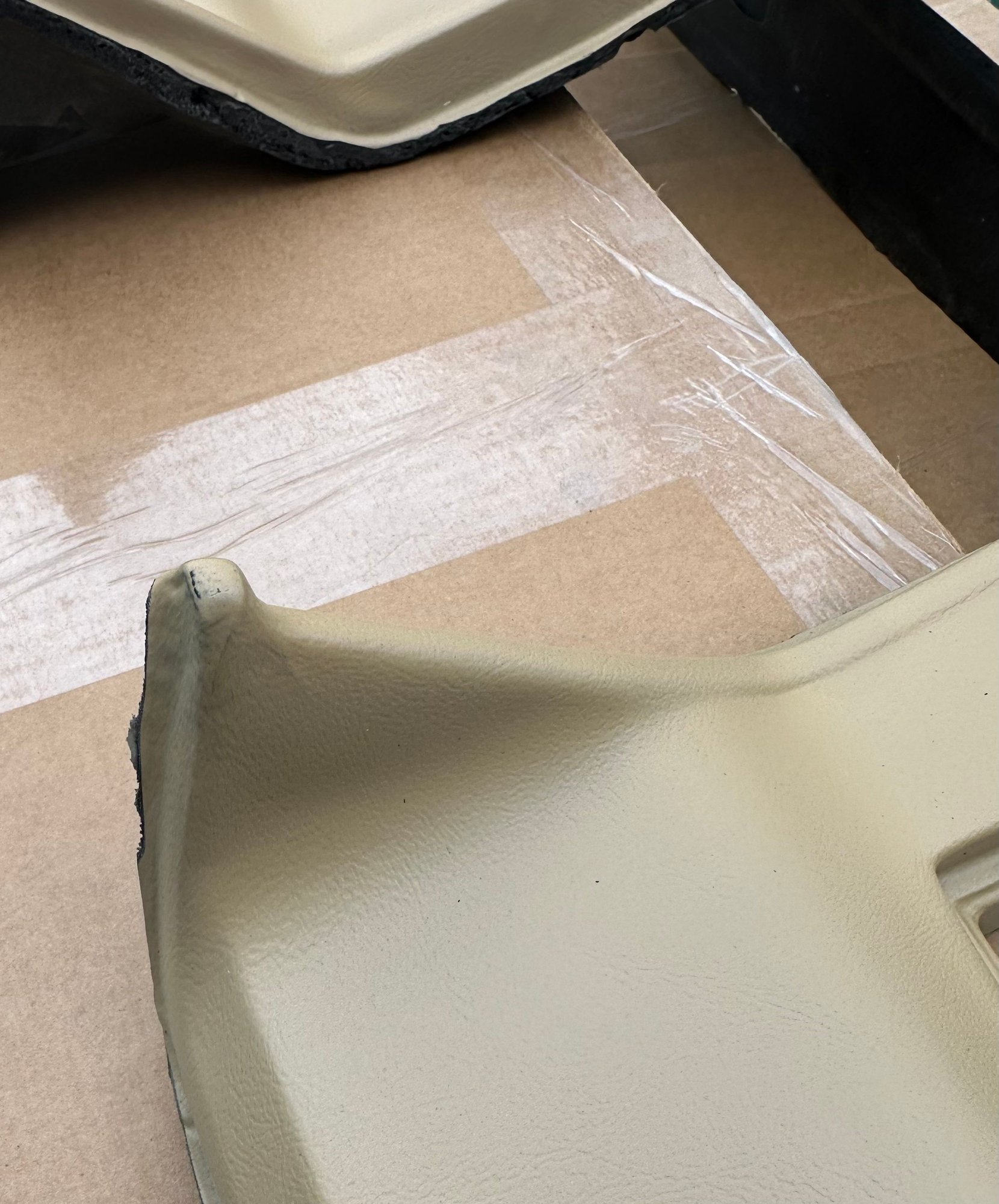

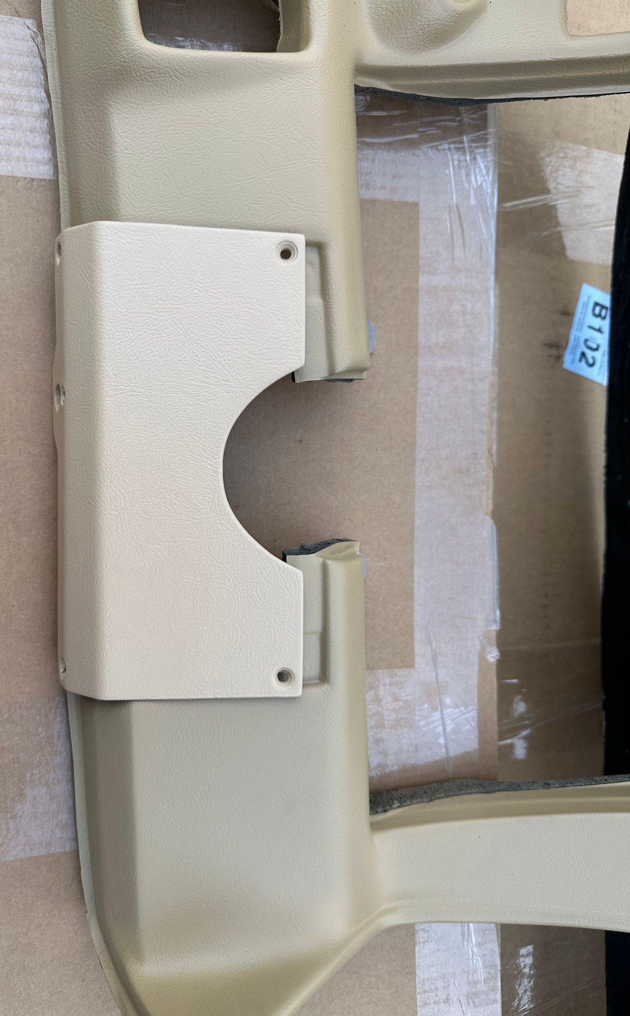

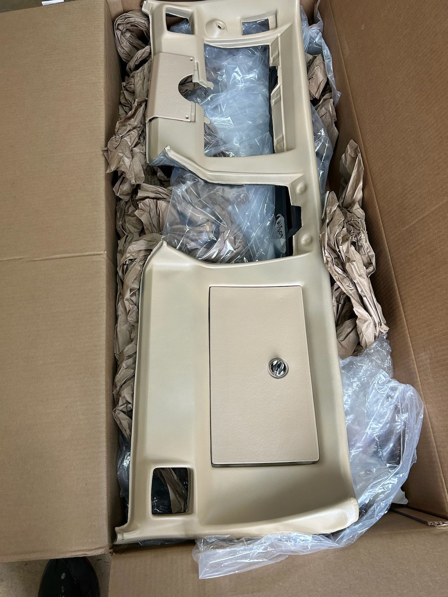

these were from the first time it showed up
more pics to come

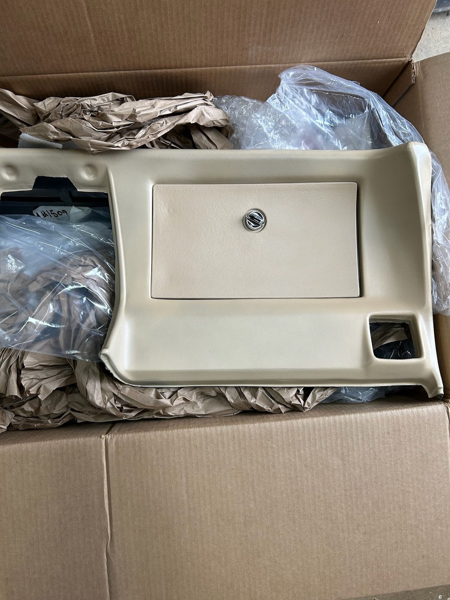

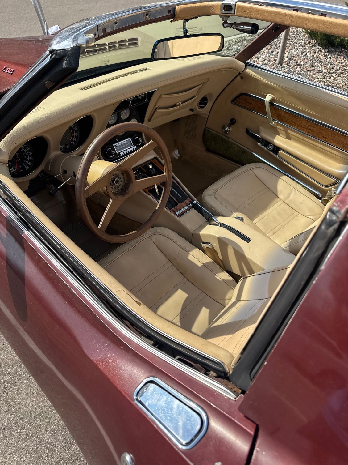

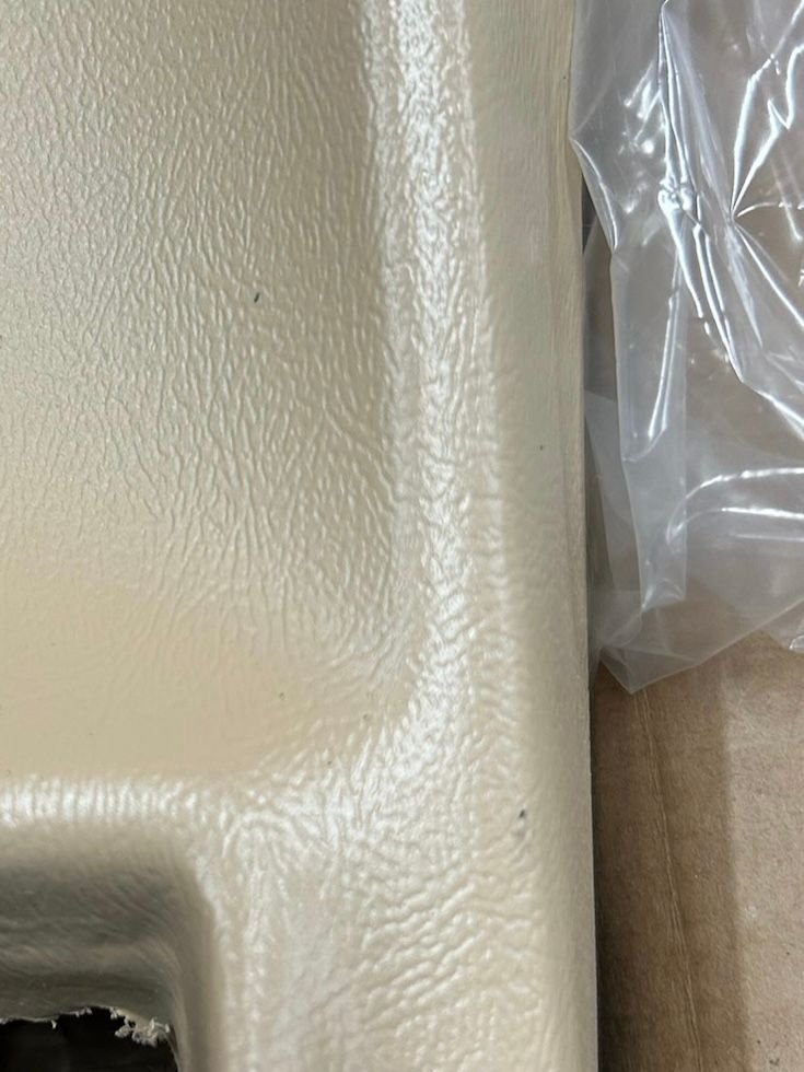

there second attempt
it’s close but not a 100%

It would be near impossible for them to perfectly match the color to the dye you are using.
Even in mass produced cans, the spray dyes can be slightly different from lot to lot.
I’m surprised they agreed to attempt to do it.
Second, depending on the color you are spraying over and the color they are spraying over could drastically change the end result color.
It also seems possible that the dye was stuffed some during shipping.
I would have ordered the dash as they produce it then dyed it to match it to my interior after I received it.
Just my opinion.

Sorry to read this. I've been happy with the quality of all the stuff I've bought from Knoch. Particularly the leather seats he redid for my 68 and 70. I bought head rests for the 68 that he made with the original OEM tooling.
Your panels look beautiful...from a little distance. The core problem is that the panels were originally black and they're being essentially painted over to the light cream color. The panels should have been fabricated with light cream color plastic substrate in the first place to avoid repainting. I think that would have cost a lot more. Have you ask if some custom panels can be made for you with native light cream plastic substates? There are high end interior shops that will cover the panels with leather....or a "leather like" modern substitute. I think this gets into the stratosphere of expense....something you'd see in a car at a SEMA show.

Scuffs are either not letting paint dry long enough to pack, packaging in shipping, or both.
not sure your year but it almosts looks to me like Oyster.
there were 2 Oyster shades.

I think OldCarBum hit it on the head.
The scuffs were likely due to shipping. Packages get jostled around a lot. Just daub some color from your spray can on those rubbed-off areas ...with a foam brush. Then re-spray on another coat of your color on the entire dash to get better color match and coverage. If you want to de-nib the dust, take a little 1200 grit in those areas before you spray on your final coat. Problem solved. Spray a fine mist of enamel reducer on it before painting ...if you think you need to soften the previous coat up...for better adhesion. I'm sure A/K didn't make any money on the deal ...seeing's how you sent it back for a re-do.
Note: I don't want to be the one to tell you there's no Santa Clause ....and hopefully you know this ...but eventually the "Dye" on your dash (and door panels/seats/whatever), is going to rub off anyway in certain places given enough abrasion. Just like your dash pad was in certain spots. Be prepared and don't let it frustrate you. Just have some touch-up 'dye' on hand so you can touch up worn-through areas as needed.
The truth is you're not 'Dye-ing' anything. Dye out of a spray can is a misnomer. Its a bad word, but sounds good. Dye implies, I think to most people, that the substrate is somehow being permanently 'infused' with the color, like would be the case of a natural fabric. It's just PAINT. Whatever gets rubbed on enough on your interior will also rub the 'dye' off eventually, exposing the base-color below. If you took acetone on a rag ...you could rub it all off effortlessly. You must have seen a 'dyed' interior 10 years old where there are rub-through areas all over ...haven't you?
That said, it's a quick and easy (and cheap) way to change the interior color. As long as the dyed parts don't get disturbed much it'll look good. But be prepared to touch-up as needed and you'll be ahead of the game. Including the corners of the dashpad. But overall your interior looks great.
