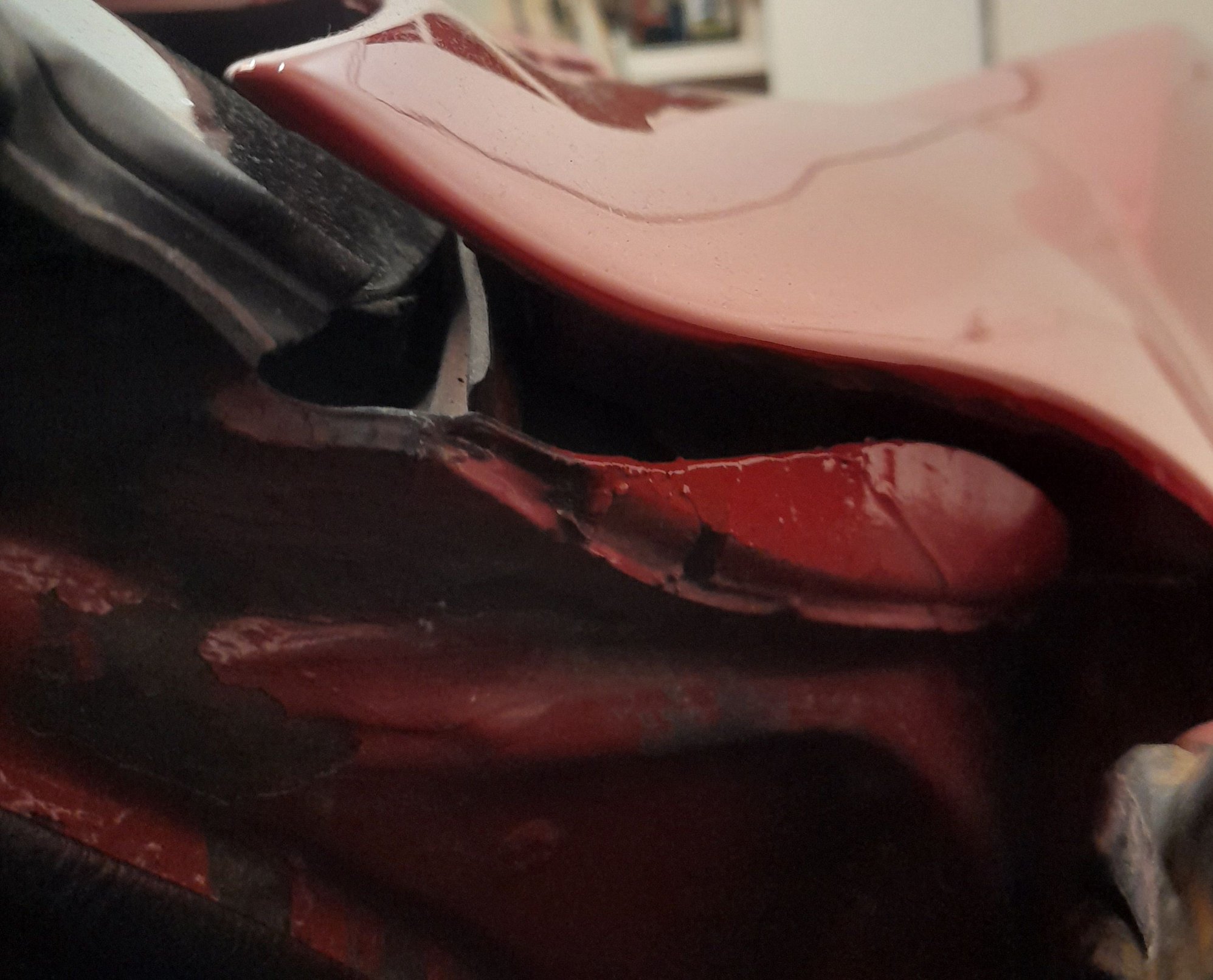

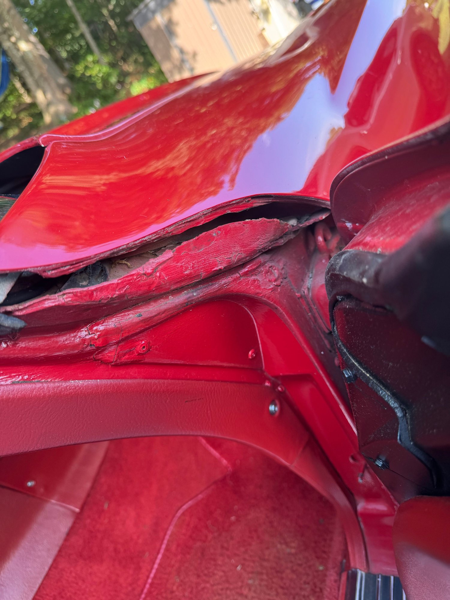

The area at the top front of the door under the fender is bottle and part of it is broke off. Is this area made of fiberglass and just filled?

Looks like someone in the past tried to close in that area, normally it looks bad (and is supposedly from the factory that way), but this looks like someone tried to improve the look?

#1 Remove all the debris. Use a vacuum or compressed air.
#2 Clean area with Simple Green (or similar).
#3 Sand the surface rust area or use rust inhibitor.
#4 Once clean and dry, apply epoxy primer to prevent future rust.
#5 Now apply flexible catalyzed seam sealer.
#6 After the seam sealer dries, apply body color paint.

Very typical for our cars. If you are OCD-prone, do as @Peterbuilt suggests. If not, close the door and enjoy your car.
