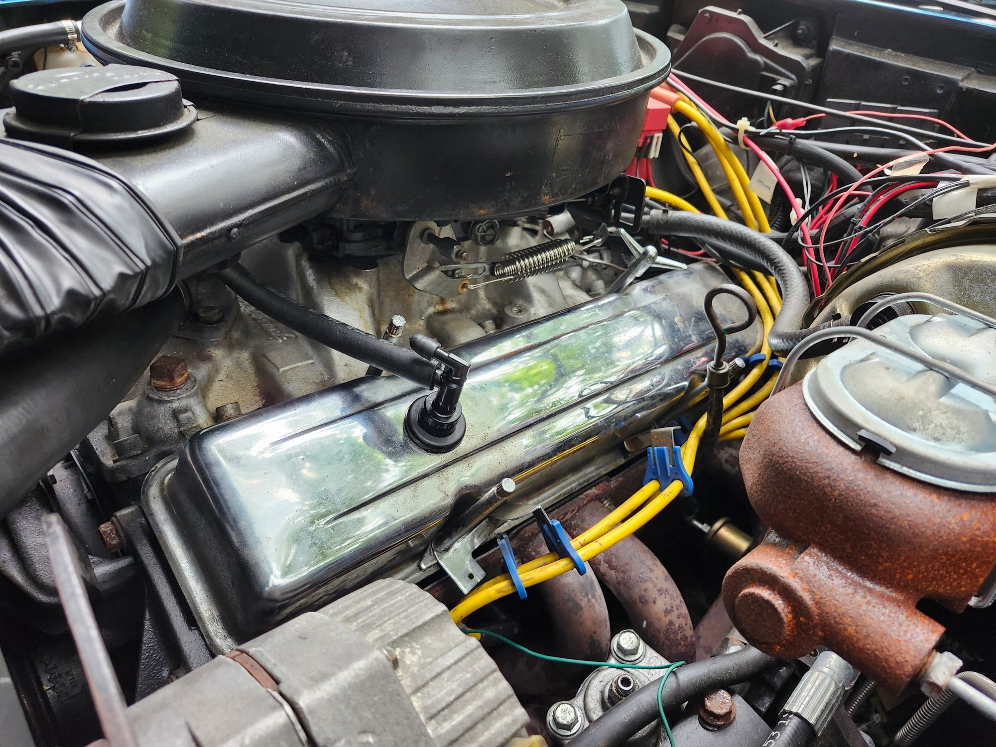

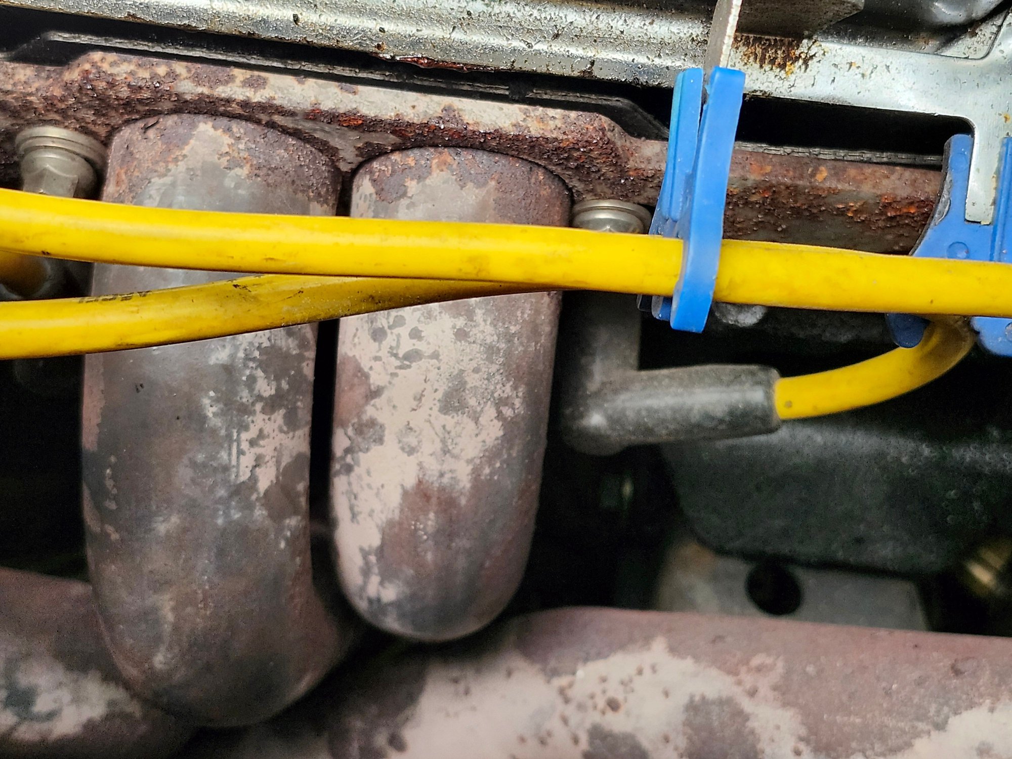

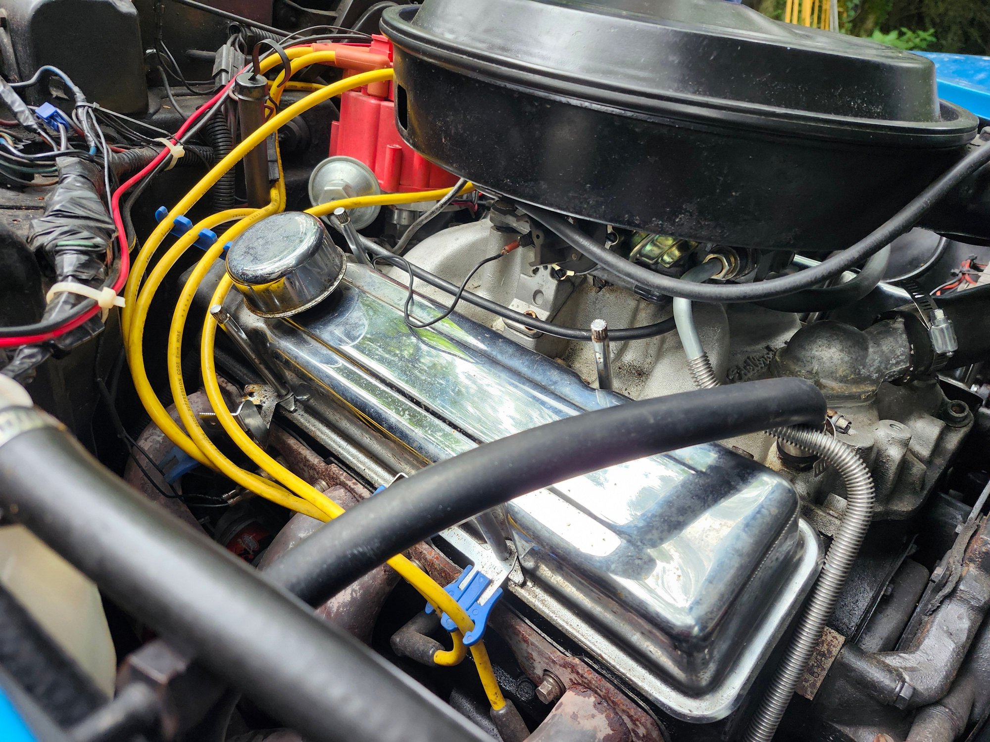

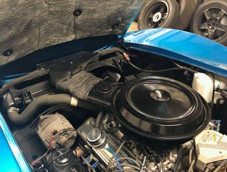

1977 Corvette with a 1996 or 2006 Targetmaster 350 (gm performance engine) made in Mexico. Chrome valve covers are soaking the headers on the passenger side with oil. Jegs has a kit.... 2 covers, spreader, hardware, gasket and breather for $250 shipped (coupon). Any reason it won't work with my set up?

They’ll fit just fine. You’re correct about your valve cover mounting years. 1955-1958 small blocks had a different staggered perimeter bolt cover. I can see why they changed it.

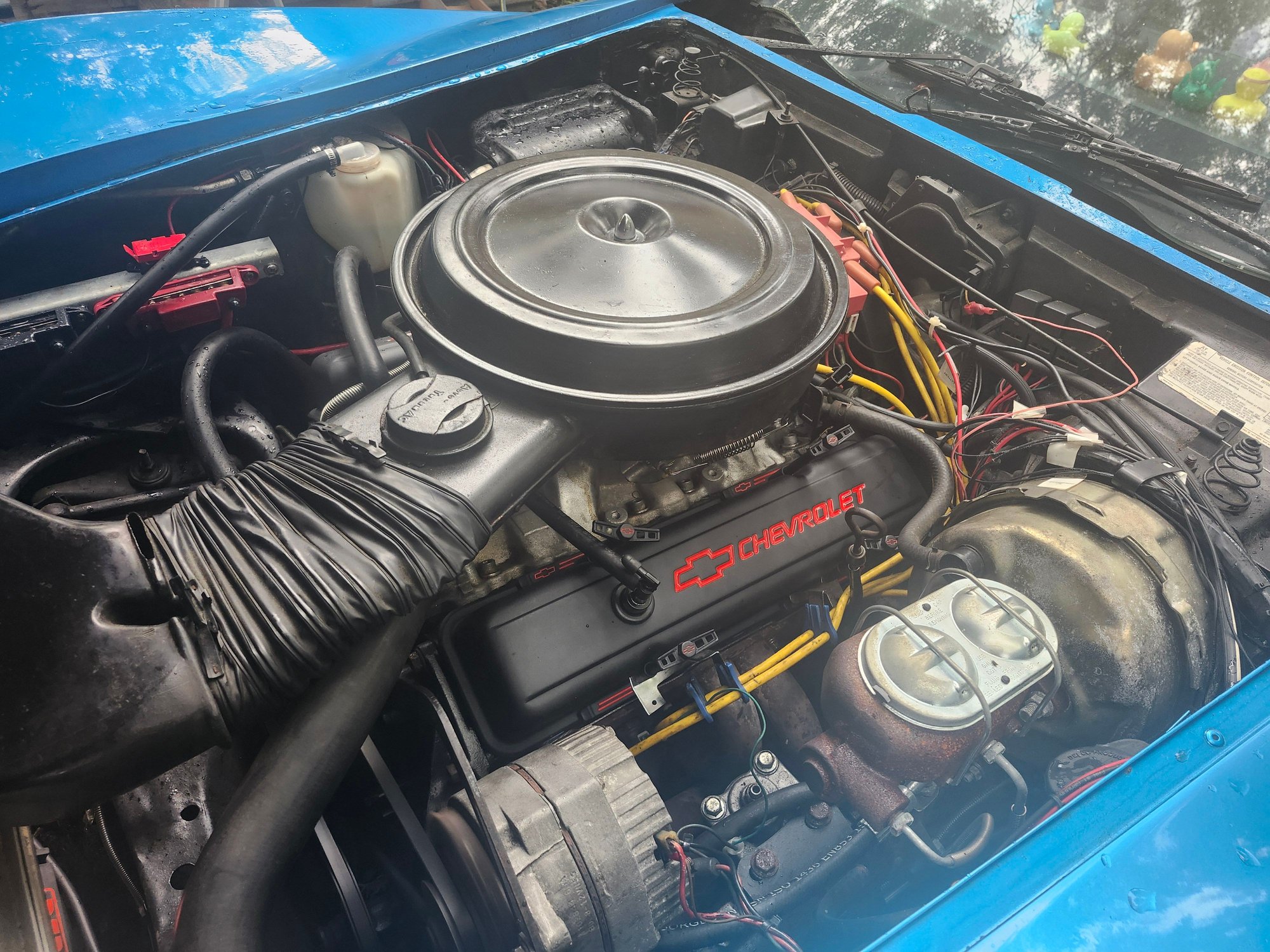

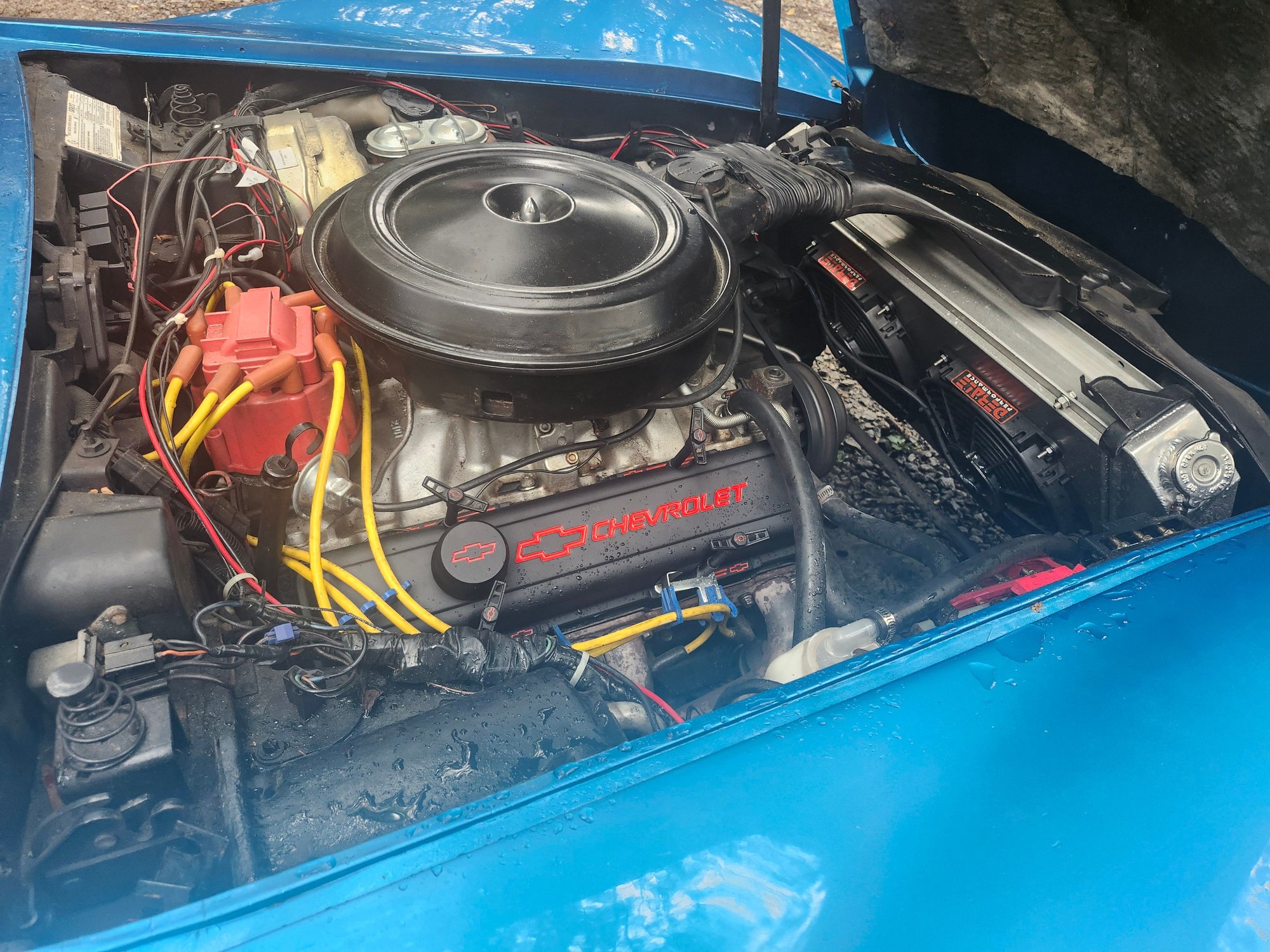

My valve cover kit came in and I installed it today. The valve covers feel modest, I wouldn't say "heavy duty". Definitely not flimsy. About the same as the chrome covers that I removed. Great finished, no scuffs or scratches during install.
The spreaders are super heavy duty, gotta be at least a quarter inch thick by 4". Great quality.... didn't scuff or scratch during install.
Wings were greats. Threaded the stud into them a thread or two, then install on the valve cover. It was rasier to align that way.
Breather felt good. No scuffs from rubbing against the wing nuts.

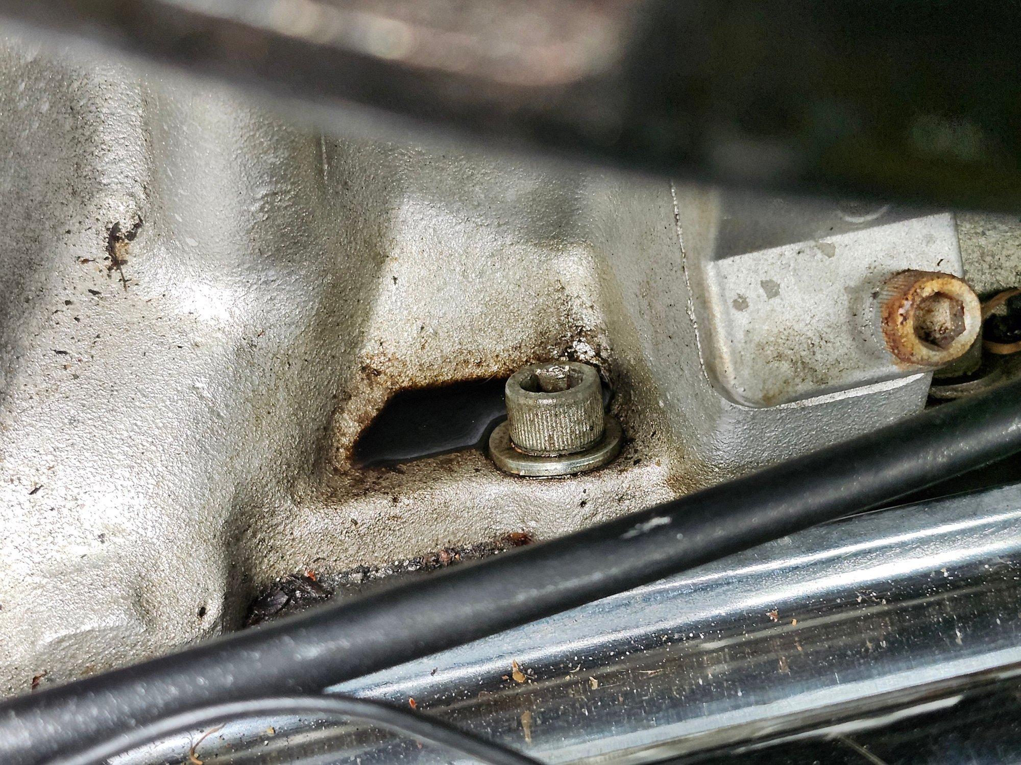

Intake bolt leaking. I gotta reseal the threads. Wiped clean and it pools up within 5 minutes at idle.
Previous owner installed covers
Oil running down (far right) by motor mount
New covers

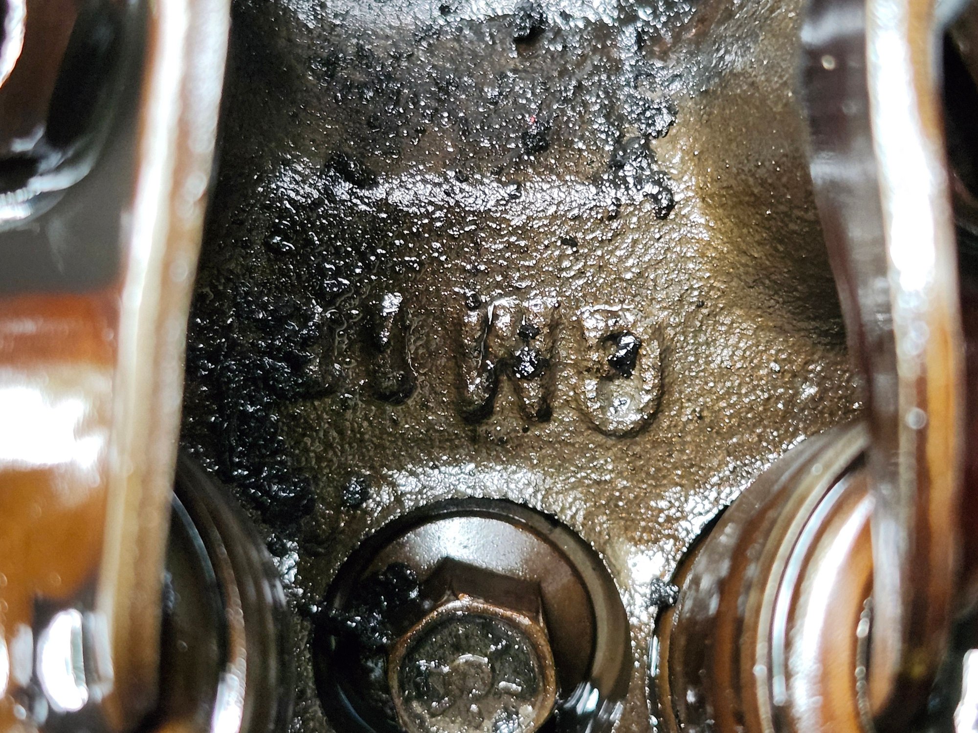

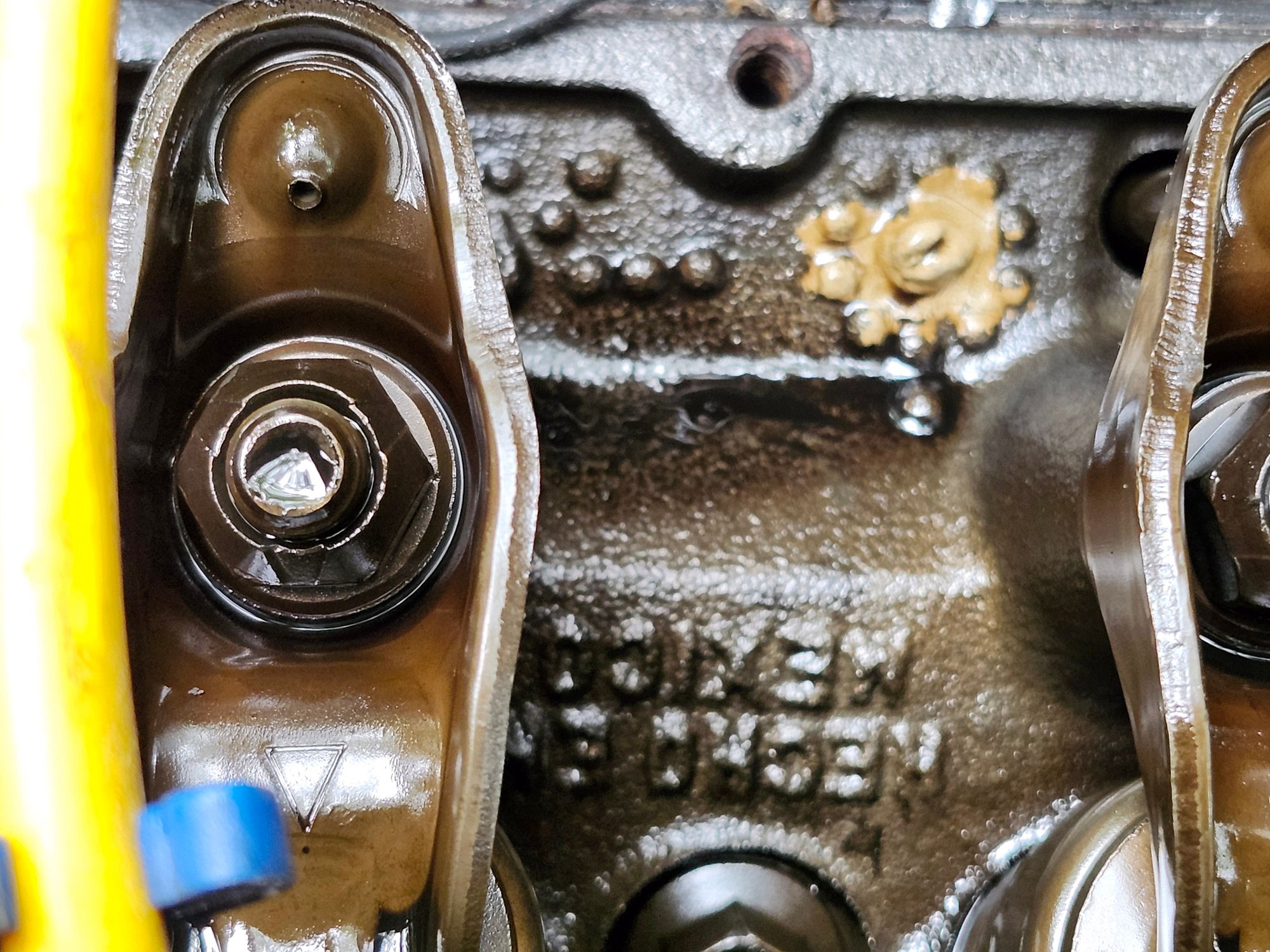

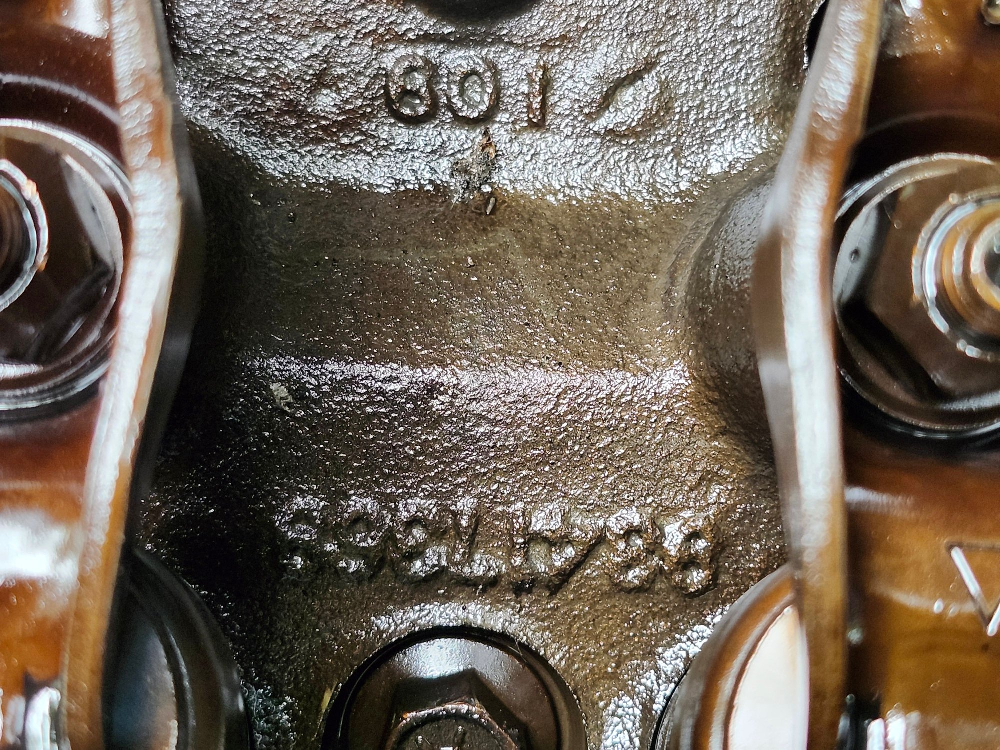

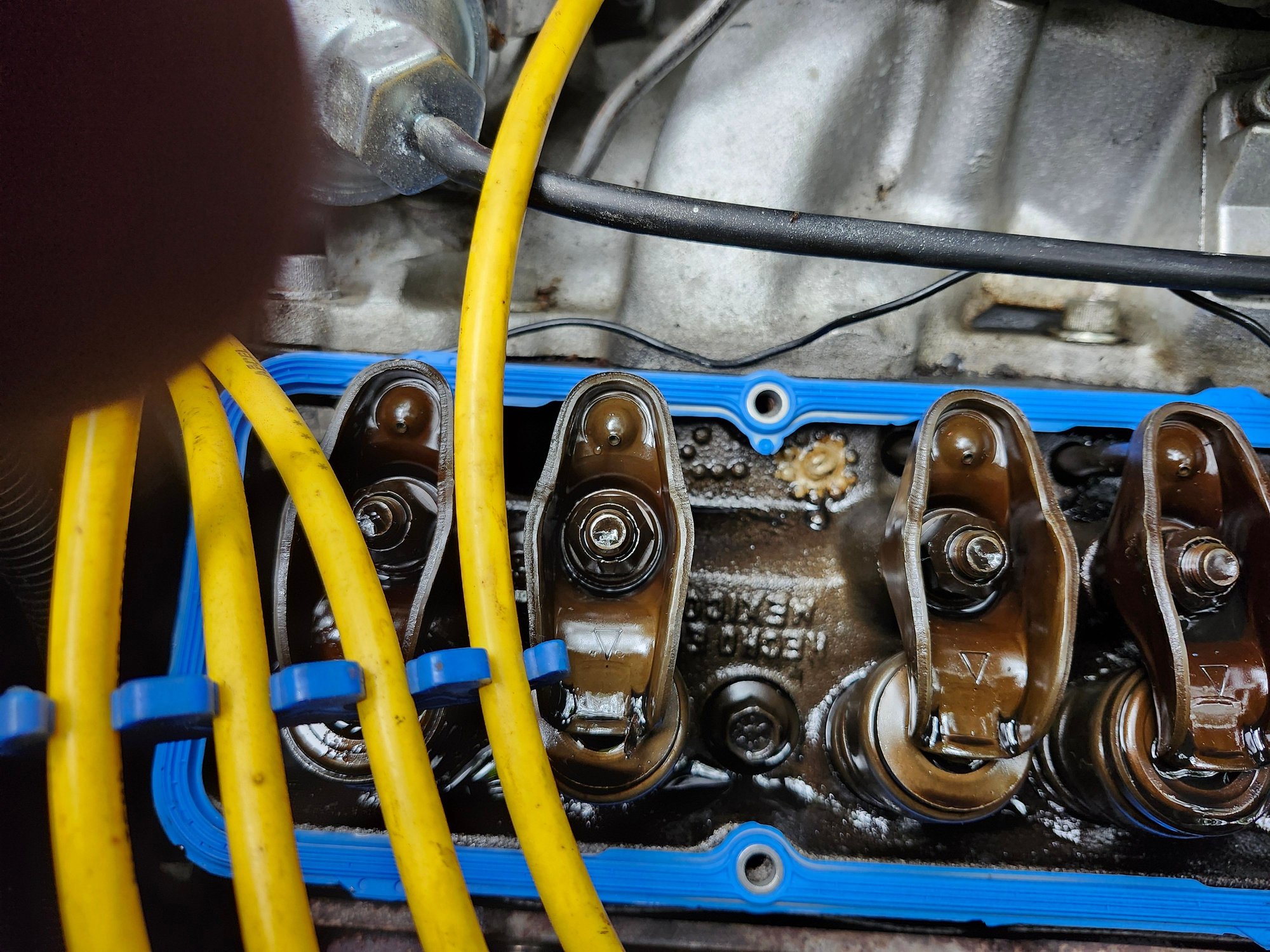

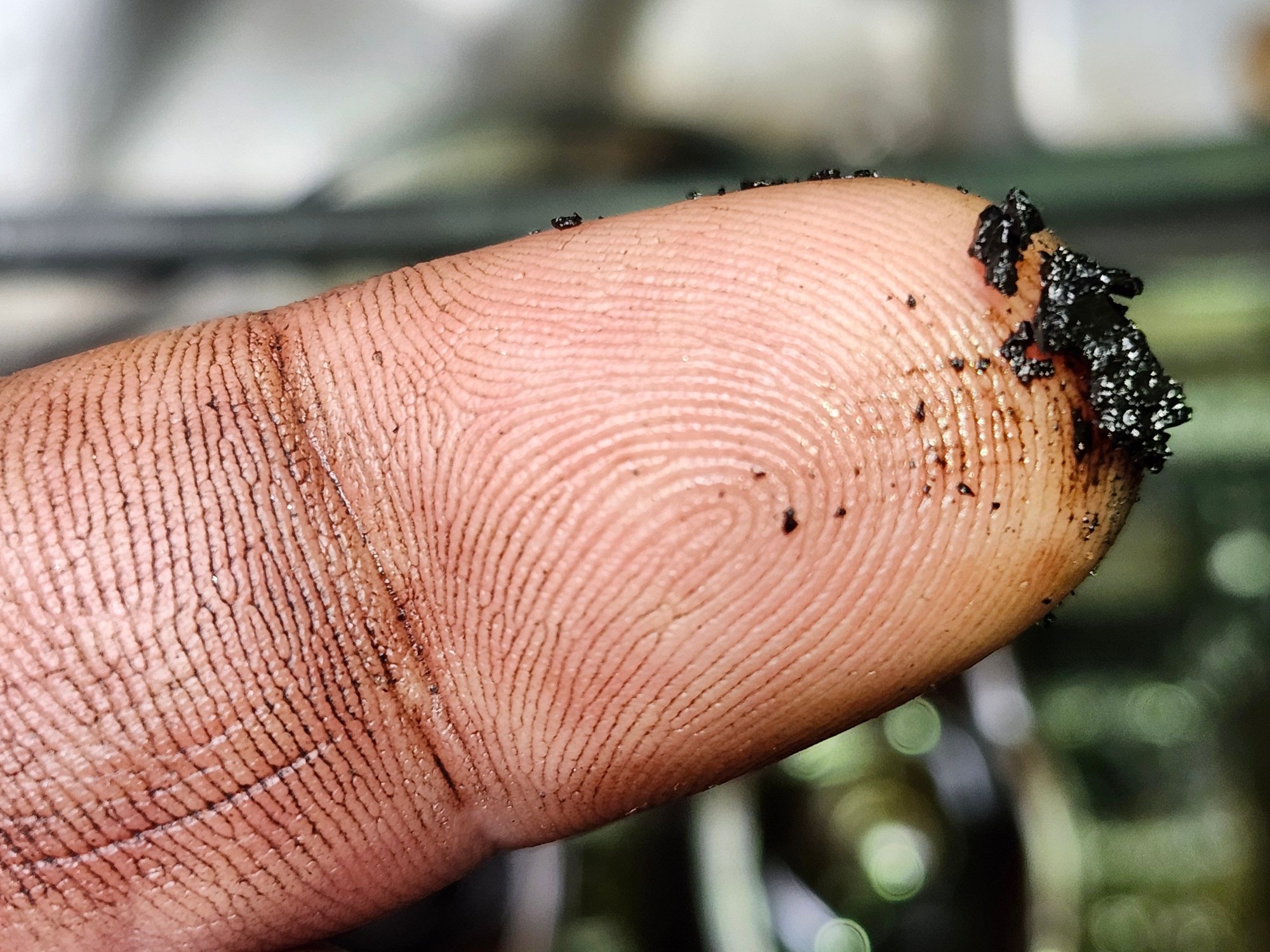

Looks like stock Targetmaster (predates gm performance motor) heads "made in mexico" 1996 or 2006. No sludge... tiny bit of crude in one spot. Some springs are tighter/looser then others. Is this dued to their position of stroke?

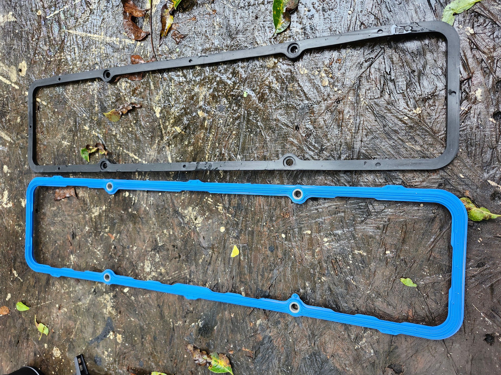

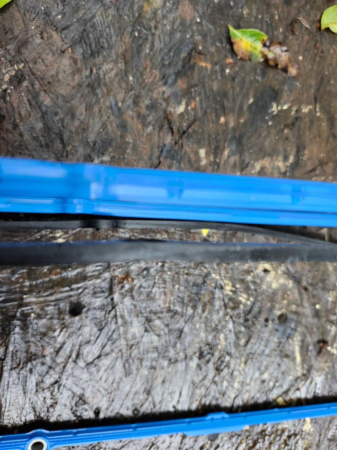

Felpro vs Jegs valve cover

Different rocker arms might have more side to side play when the valve isn’t being opened. As long as you’ve got no up and down movement you’re good.
Not that it’s difficult, but here’s an article about fixing a leak from the intake manifold bolts.

Shouldn't be any valve springs looser or tighter than others.
I assume you meant "rockers". That is normal.
ARP makes a thread sealant for that stubborn Intake bolt.
You should remove it, wire brush the threads first.
Some of those bolts go right into the lifter valley, full of oil.
That is what you are seeing.
Easy fix.

I have the Edlebrock Performance Intake. Previously all bolts were wicking oil. I used Permatex high temp thread sealant. Wire brushed threads and sealed it. It eliminated 90% of the wicking. I'll try that Teflon tape method. Thanks!

I dont think it had any up/down movement. Mostly side to side. Im not hearing any ticking. Just my first time under a valve cover.
