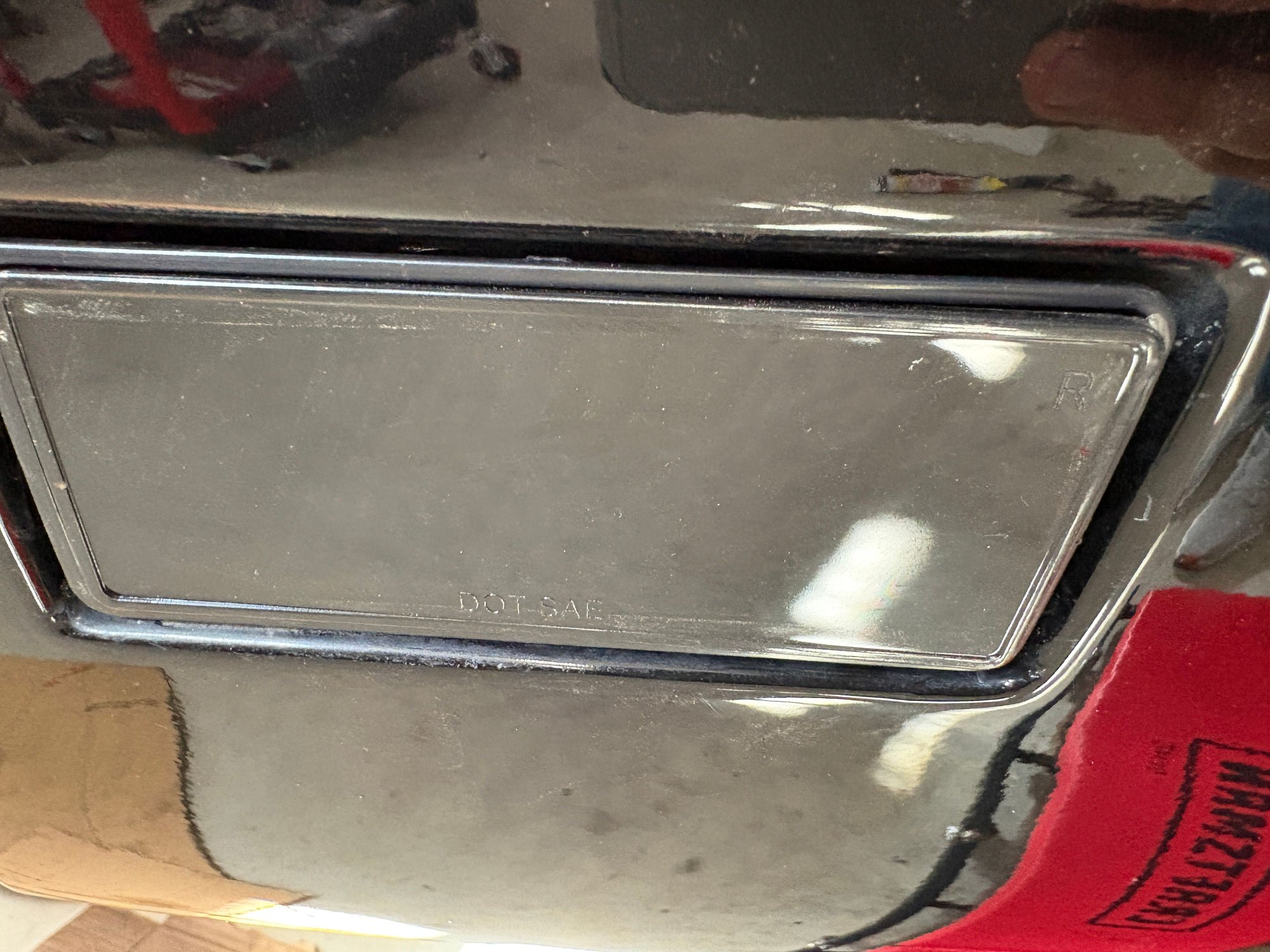

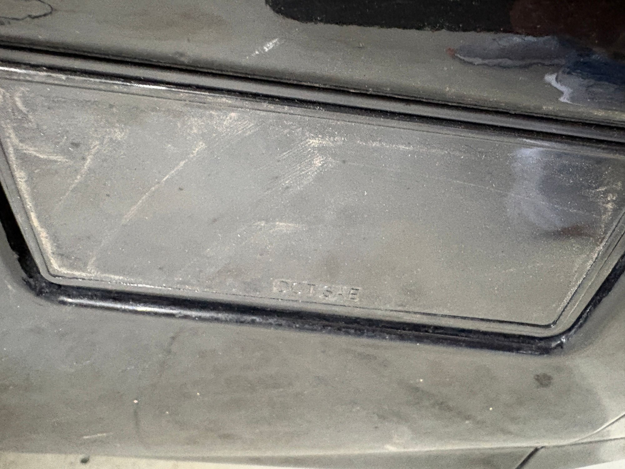

Do these replacement lights have the required DOT or SAE markings on the lens?
Old Jan 18, 2026 | 01:28 PM
Nickb1907's Avatar
Nickb1907
7th Gear
Joined: Jan 2026
Posts: 7
Yes, see attached.

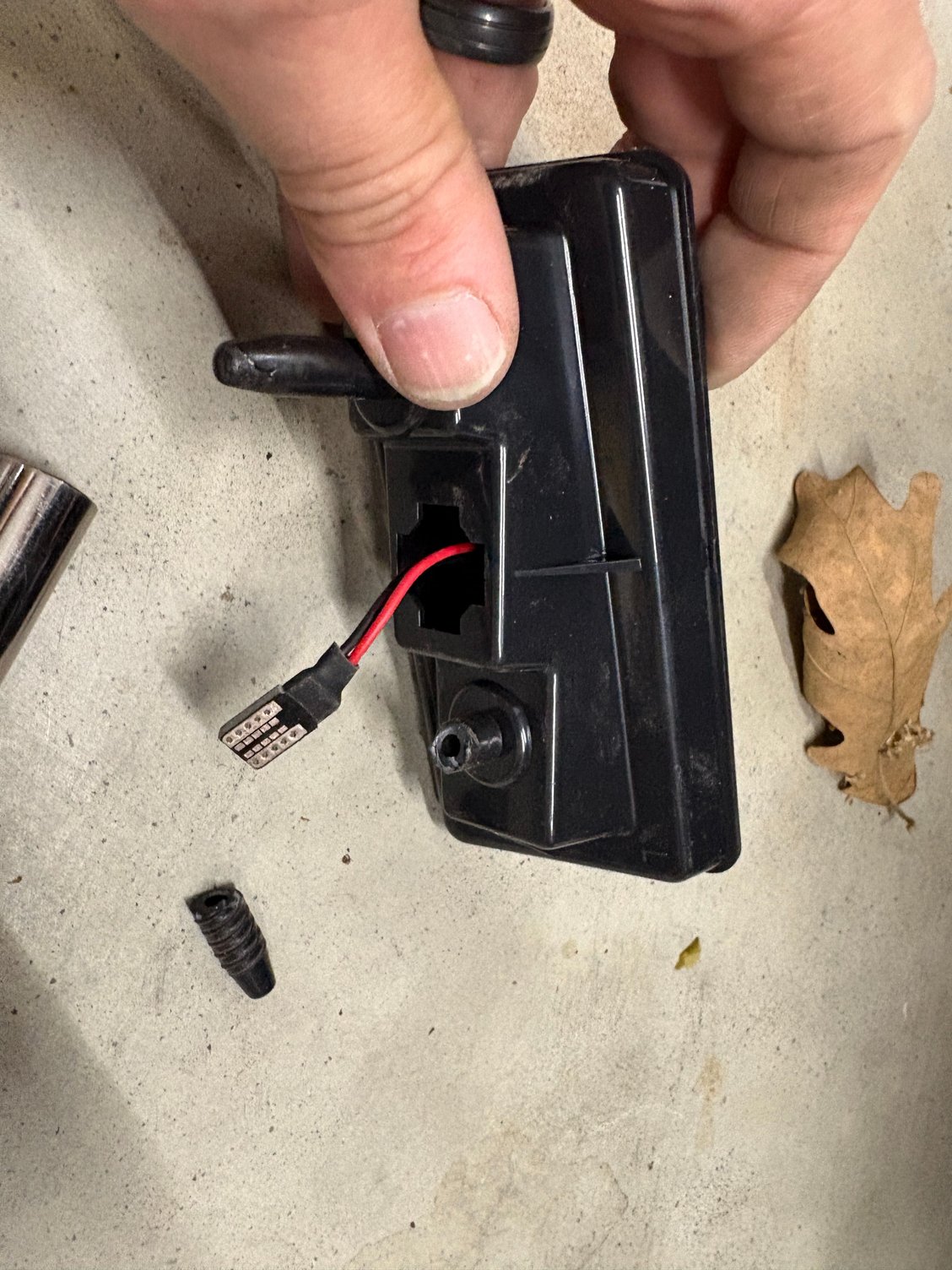

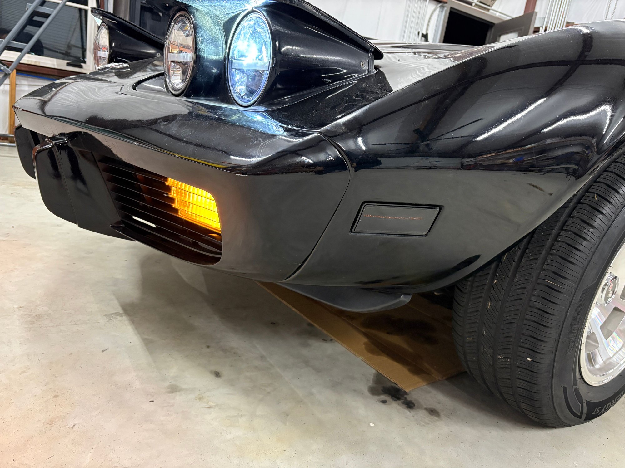

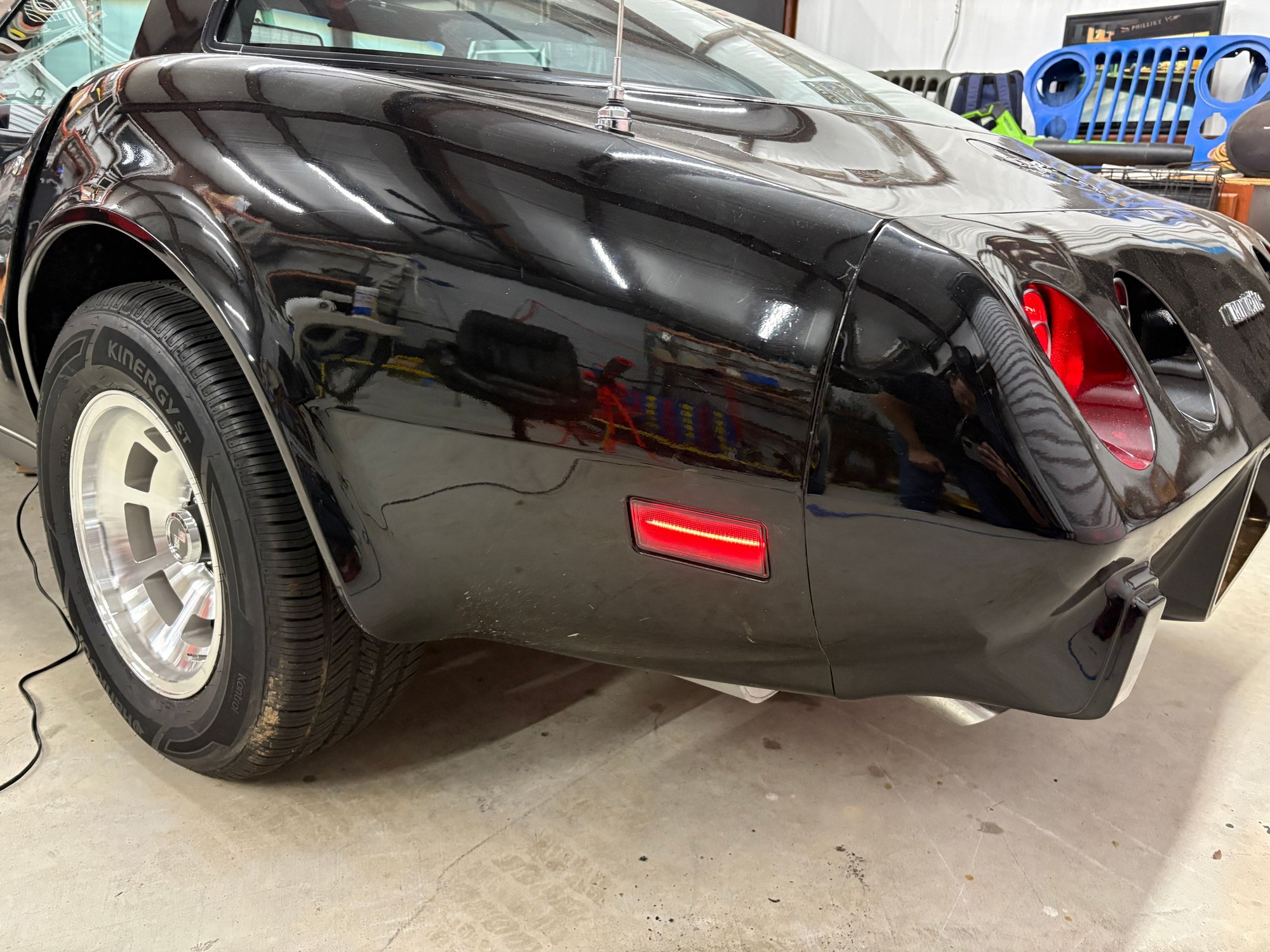

Got them installed. They act just like LED bulbs and do not have a circuit board to make them act like normal. I need to order a blinker genie to resolve this now.
  • They are not sequential like the 80s version posted above.
  • I get dim light with running lights and headlights on.
  • It kills my turn signals when running lights and headlights on. So I get nothing out of front turn signal lights or tail lights.
  • Also they are CHEAP. I had 2 posts snap off when installing them. I had to rig them with some metal screws.
