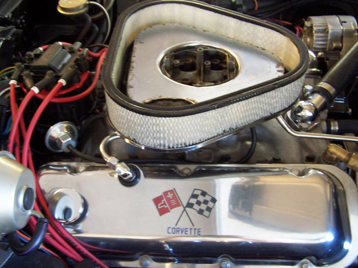

I know these air cleaners are hated on this site.
But other cars use them all the time, its not going to catch on fire on my car because my timing is perfect and my carb is new so without wasting every waking moment day after day wondering what air cleaner to run I choose this one and am done with it.
If conscience bothers a person buy a replacement filter every year for $10.
Well, they are about the lowest of the low profile air cleaners, ran one on my Roadrunner years ago, never had a problem for a couple of years, then one day it caught on fire. Burned out pretty fast and didn't spread, but was still scary. It's better than no air cleaner at all, I'll say that much. The filter element is pretty flimsy, I would clean or replace it frequently.
Tim, you gotta do something about that master cylinder and vacuum booster, seriously. The rest of the engine compartment looks so nice they stick out like a turd in a punchbowl.
