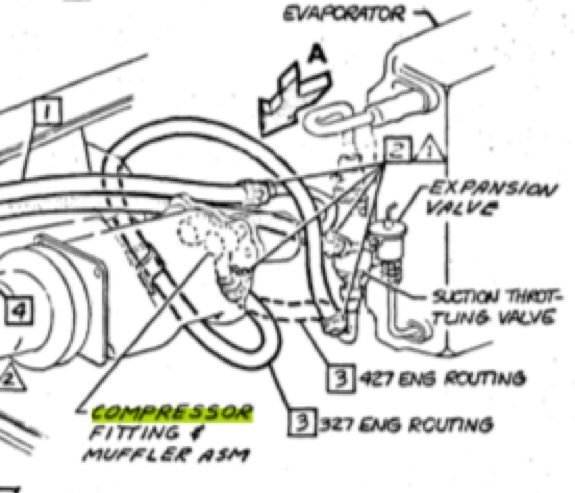

Updating an old useful thread. I am replacing my hoses and measured them. I don't know if they are original, but they could be. NCRS judging guide says hoses are to be installed with little to no slack or bends; in one case that is contradictory to the 5/8" hose as indicated below.
5/8” – actually ~50" - muffler suction to bottom of POA - as Doc’s says, there is a ‘long loop behind compressor’ - perhaps to ease installation
AIM Excerpt - 1968
1/2" – actually more like ~31" - muffler to condenser
13/32” – actually more like ~35" - receiver dryer to expansion valve
