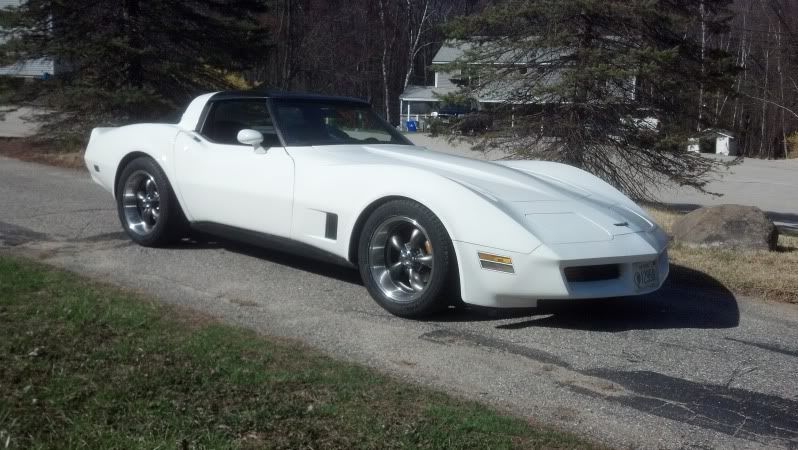

17x8 -12mm offest Rev Classic 100. bolt on, no spacers.
255/45ZR17 (26'') Continental ExtremeContact DW
(I don't recommend this tire size on a stock height C3 the wheel gap will look ridiculous)
stock front springs with one tight coil cut off
8'' bolts in the rear
1 1/8'' front sway bar (stock)
7/16'' rear sway bar (FE7)
stock fiberglass leaf spring
Bilstien Sports

Looking good I like the shot next to the C7

thanks. that shot was to show ride height compared to the C7. Same with the pic next to the Blue C3.

The C7 overall height is 48.80 in. Stock 1980-82 height is 48.0 in. I have my overall height at just under 47 in. Have you measured yours?

no, where are you measuring to, the top of the roof?
I would think mine would be a little taller than yours, maybe a 1/4'' or so because of our tire diameter differences.

Yes, top of the roof. I had mine down about a half inch lower front and rear, but felt it was a little too low, so brought it up to where it's at now.

That really looks good! You might try lowering the rear just a bit to nail it.
