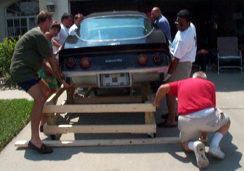

Just used the stame strap kit to pull the body off of my 70. The hooks go on the birdcage at the front & back of the doors. You may need to adjust the position to get the body balance. Here's a pic of what I did. Hope its not to large. [

My nose seemed a bit flexible as I was getting prepared. That's why I added the strap arround the radiator support. Just a little tension on the strap & everything lifted straight up. I also added a support to the dolley in the rear to hold up the tail. With a convertible the rear flexes down a lot. The support uprights wer cut to size once the body was off. I can even open & close the doors. :)
