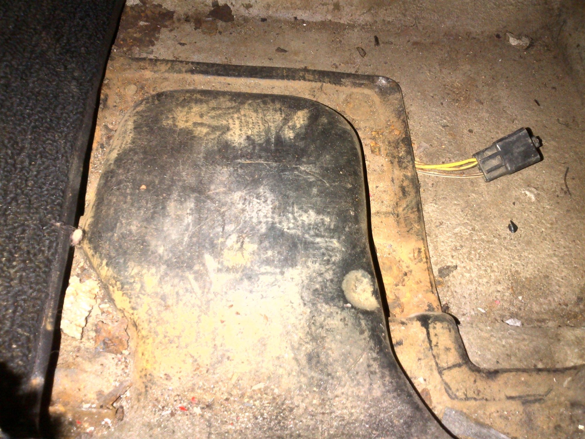

ok - Im a newbie and this is my first project. I have started to restore what looks like a decent 1973 corvette and will be needing help and asking many questions. (not sure if this post belongs in here or General).
I have started to gut the interior and have found a few things:
1) the screw heads to the seat belt cover is rusted away. can I drill this or should I try to cut? Same with the base plate under the chasis.
2) does the cover for the A pillar cover this gap? is this common or do I have issues with the bird cage?
seat belt cover - drill holes to removed?
Seat Belt plate - rusted. cut or drill?

On the seat belt cover, is there any of the screw showing that you could use vice-grips to remove. I would soak the screws with PB Blaster and see if
that will release the screws.
I can't really make out the bottom of the plate. It should look like this:
Use the blaster on the seat belt bolt. You may have to spray the PB blaster on the bolt under the tunnel.
The A-pillar is the same on mine. It just seems that your 73 may have been white (910) on the trim tag originally.
Also looks like you have a mix of black and saddle interior as the cover on the belt should be the same color as the carpet.

Thanks for the response - The car was white with Saddle interior, before being painted Cola Red and black interior. I do have the Main bolt showing under the body and im going to soak that and try to get that loose. The rest of the bolts are rusted and cant get a grip on them. Right now I cant even get the plastic seat belt retractor cover off.

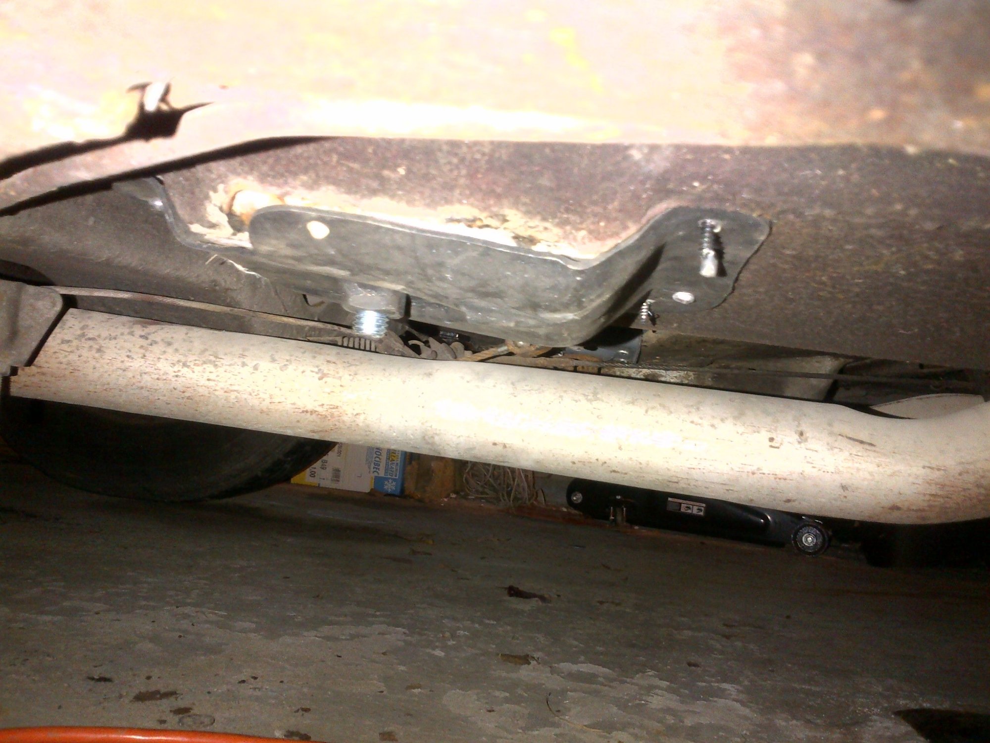

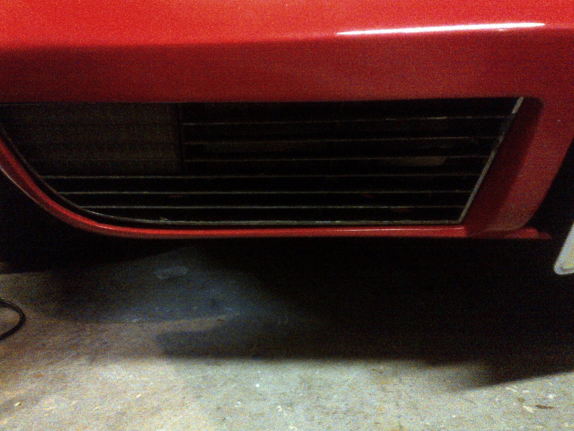

quick update - I have started to gut the interior. I got the new seat belts installed, new brackets for the tunnel and under the body, and new seat nut plates installed. I also got brackets made and got the Grille installed. next is to paint the interior, then lay new carpet (I got for the holidays). See Pics:
new Rivets for the tunnel bracket and inside belt
Reinstalled original Metal Grille
Grille Installed
New Seat Belt Plate

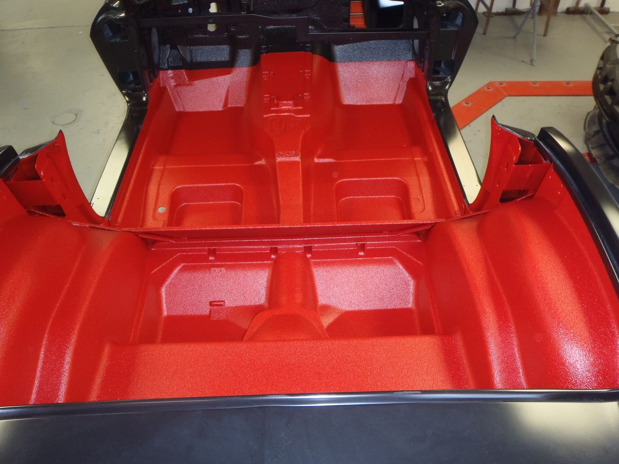

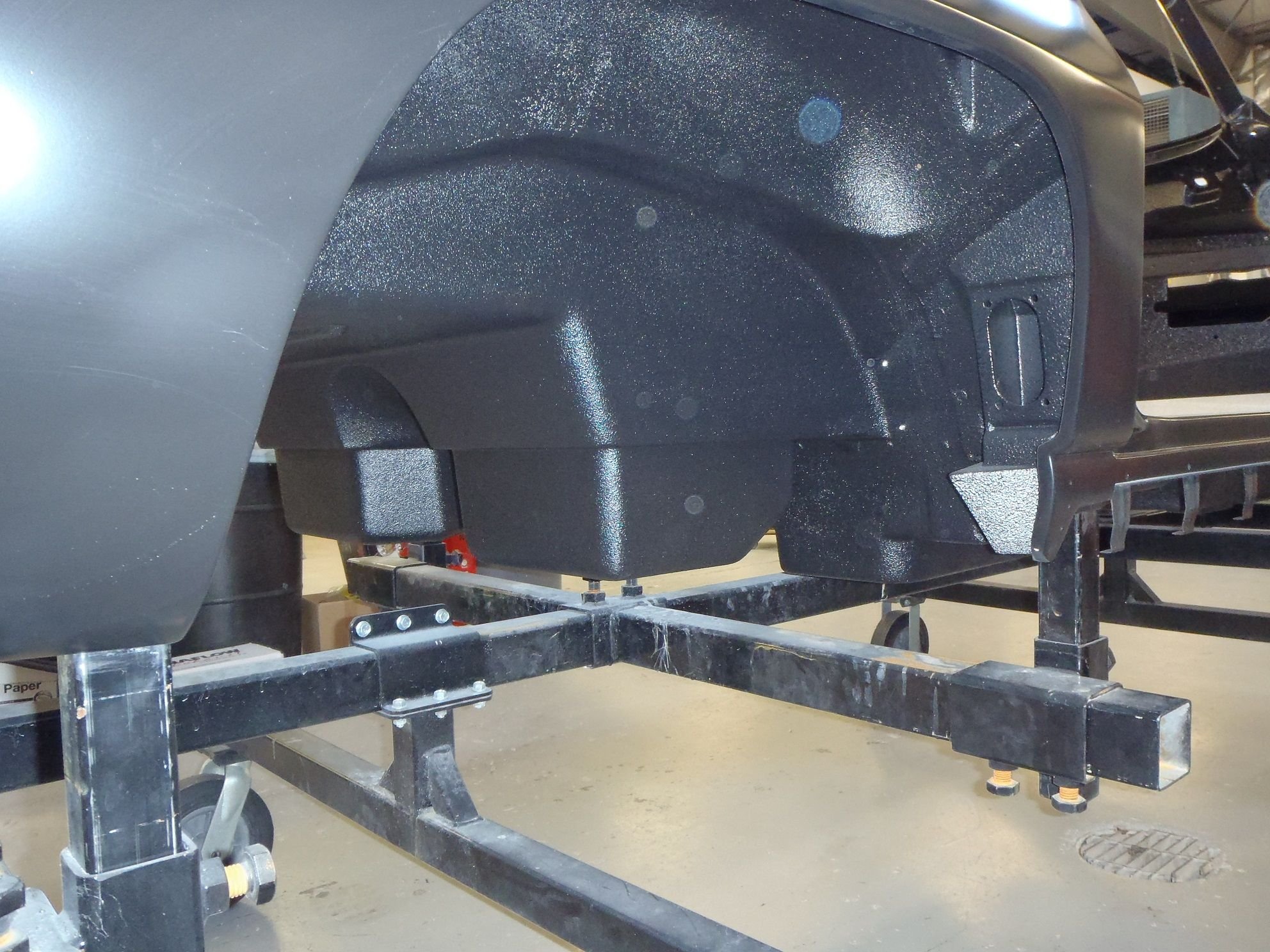

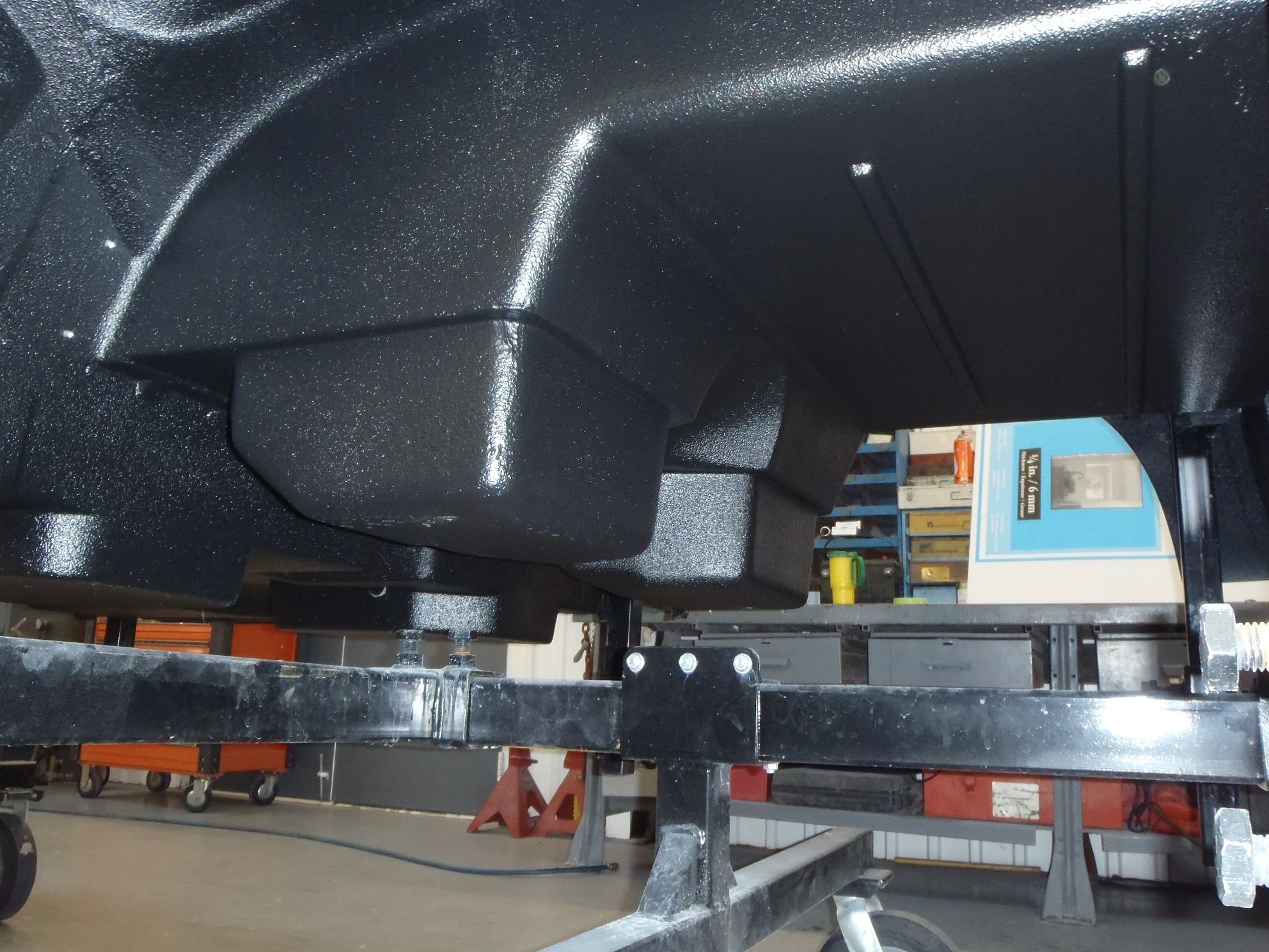

wowed777, I used a bed-liner material called Raptor on the interior as well as the entire underside of the body.
The shop I'm using has had great success utilizing this material to provide a barrier to normal road debris as well as adding substantial corrosion resistance to many of the vehicles they restore. We decided that the use of black "Raptor" on the underbody and red "Raptor" on the interior (because of the red interior), would not only provide protection to the fiberglass underbody, but add an additional measure of heat resistance and sound deadening for the interior. I think it came out looking pretty good and it certainly looks better than the red paint the factory sprayed on the interior.
The material goes on very nicely and it can be tinted almost any color you desire. Since the factory painted the body interior (quite haphazardly I might add) the same color as the interior would be, the "Raptor" seemed very appropriate to do in red. I believe that this was done to blend with the interior color in areas where the carpet or other interior parts would not provide complete coverage. Such as the rear storage compartment and the "tool" tray on the early '63's.
Good luck... GUSTO
