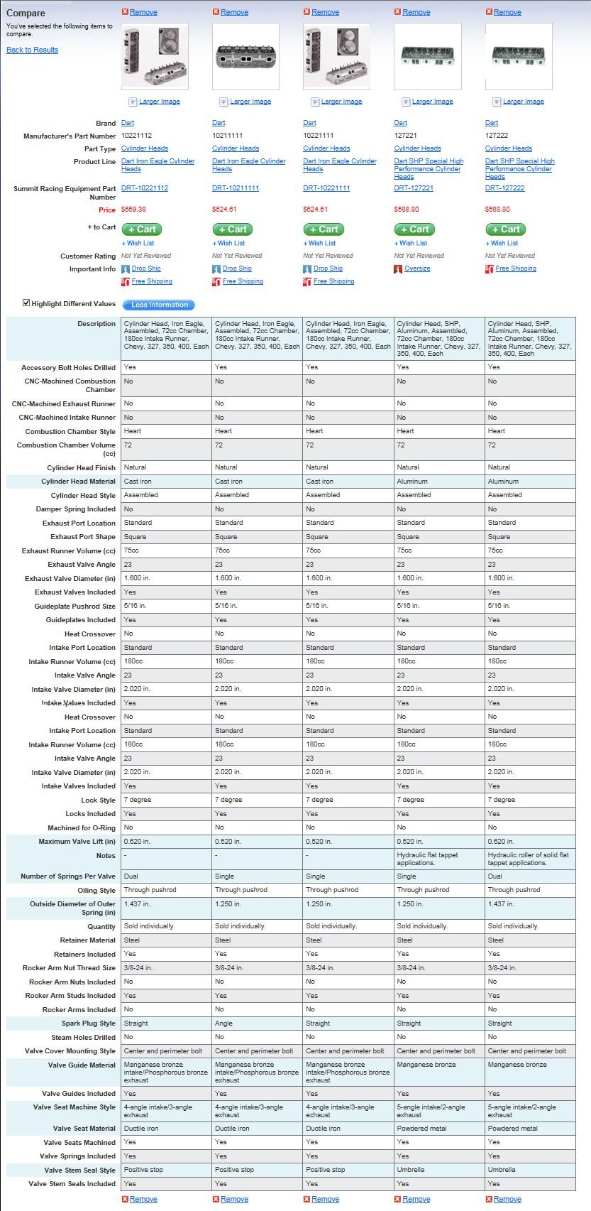

After reading up a lot on the fourms and speaking to a few head guys I came up with these heads over on Summit.
Im hoping to choose one of these for my new setup.
Anyone have any difference of opinion?

Your L48 has an actual compression ratio of right about 8 to 1 likely a little under. Your cam bleeds off a lot more more compression than the tiny factory cam, it needs 9.5 to 1 compression to realize the benefit of the increased lift and duration. The heads I linked get you there. The 72 CC heads you linked get you to 8 to 8.2 compression and the first one and the fifth have incorrect springs for your cam. The ones I linked have strong enough springs with enough lift capability and increase your dynamic compression (DCR) the correct amount to optimize your cam, flow better than the Darts, and have the correct port size for your engine. The correct DCR and most flow through a smaller port increases power across the entire operating range pyramidically. Combine with Felpro 1094 head gaskets to optimize quench. Your cam likely makes less power than the factory cam with your heads or the 72 CC heads. You need 64 CC or less chambers to even get back to stock power levels. You do realize the 2nd and third are iron heads and all are priced per head right? Dart runs big on the ports. Likely will CC at 190 or more, way to big of port for your operating range and combination and not enough compression for your cam.
Thank you again Mako,
I'm learning as I go with this. I have very little knowledge on head selection. I was just worried about going down to a 64cc or 56cc in your recommendation as I feared it would cause unnecessary knocking. I was aware the my 2nd and 3rd selection were iron heads, I selected them based on other members builds with the same cam setup and stock intake.
