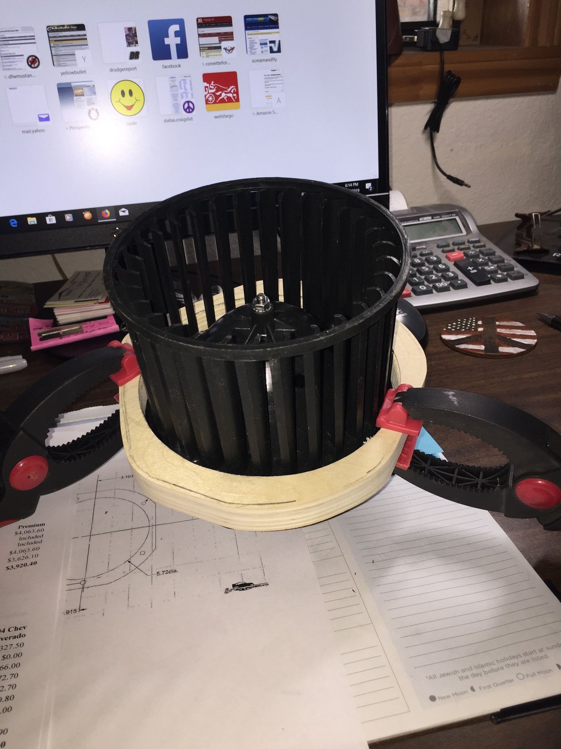

I did it on my '71 and my friend in Louisiana did it on his '81. We both used 3/8" plywood for the spacer and YES they move a LOT more air. About 50% more.
Old Jun 17, 2015 | 01:22 AM
toobroketoretire's Avatar
toobroketoretire
Joined: Apr 2009
Posts: 2,632
Likes: 112
From: Great Plains Iowa
Here's a picture of the 3/8" plywood spacer that is needed.

you don't need 3/4 or 1 inch .. 3/8 inch spacer is all it takes.with stock C3 motor and C4 wheel. . and a good ground wire...seal the box, they are known to leak against firewall. it moves a lot more air for sure
