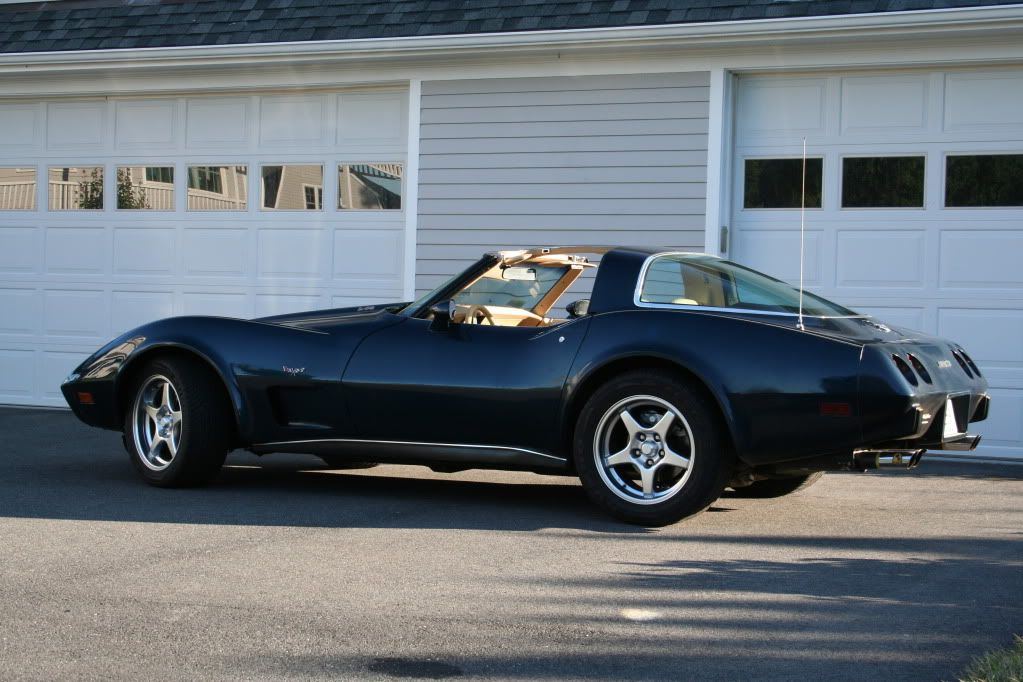

Your best bet as others have mentioned is finding a 17/18 rim that you can live with and will fit a C3. The tires for the 15 inch OEM rims are mostly junk and not even up to the performance standards of tires that are just about on any new car today. I went with SLP 17's (no longer made, ZR1 rims) many years ago on my 78 since I was fed up with the S/T rated 255/60/15 tires available for the C3's and have never looked back...255/45/17 ZR ultra high performance summer only tires. These tires transformed the ride, handling, and steering of my 78...They ride MUCH better than the old BFG 255/60/15 Radial TA's and the handling/steering response is superb.
