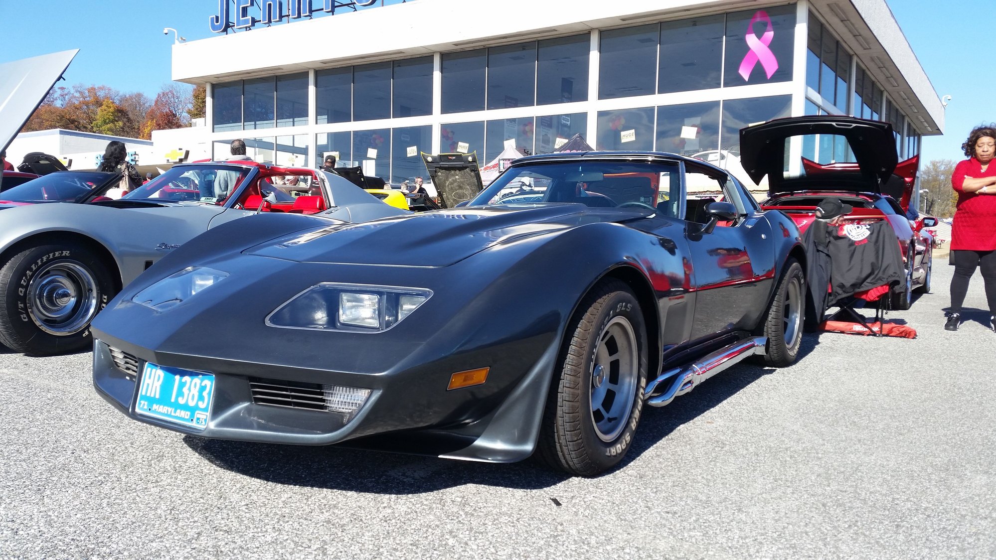

I think the clear plexiglass covers make my car look better. I tried without them, didn't like the look on my car.

[QUOTE=KrisB410;1591021899]I think the clear plexiglass covers make my car look better. I tried without them, didn't like the look on my car.
Otherwise looks a bit unfinished...
Yeah, it's not quite done yet. Still have to wet sand, polish the wheels, and a few other odds and ends.
Stop the presses you misunderstood me...I think your car looks stunning, I was trying to express that the recessed headlights without the covers look unfinished...not your car....

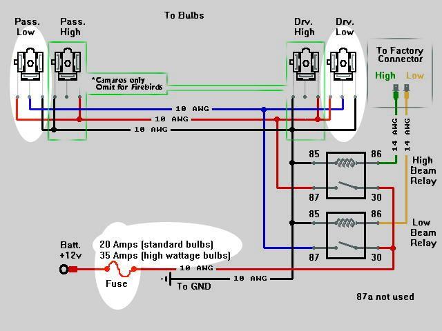

George, did u consider the LeMans style lights for C3: http://www.mamotorworks.com/Corvette...s-kit-642347-1.
They look better on the chrome bumber C3's but may look good enough on yours also. I think the trick is to paint them down to the lamp position. Also HID lights put out more light but need a starter and starter circuit also - fairly expensive.
