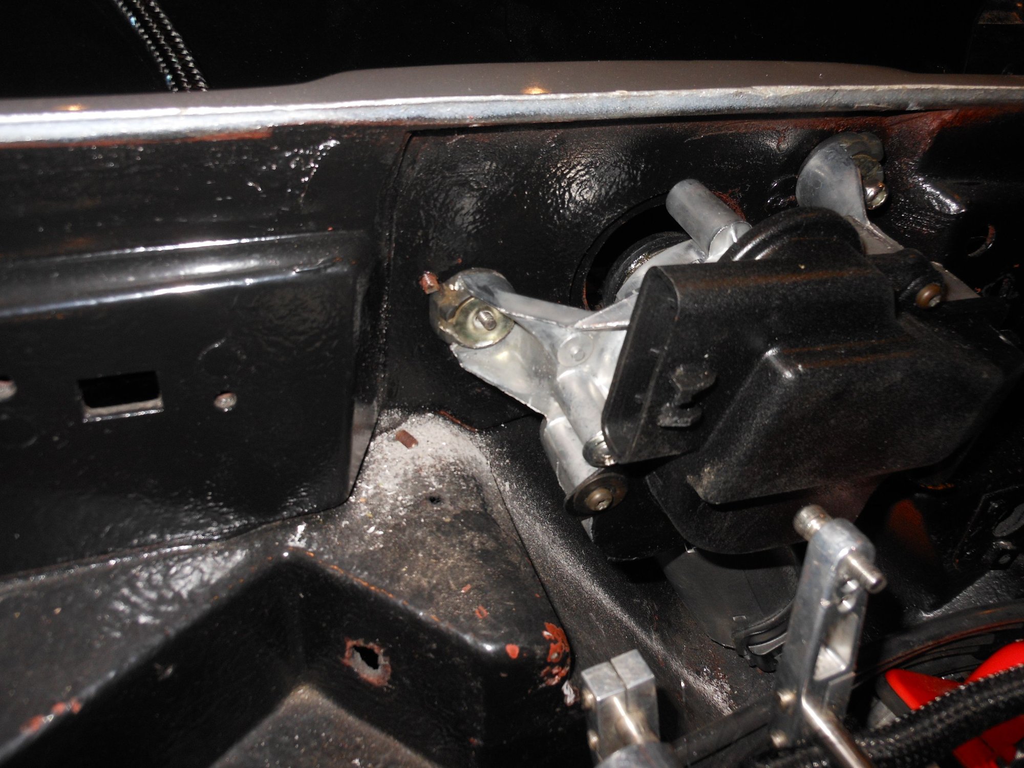

Looks like the C4 switch will work-but at almost a c-note for a switch?!!!
My original thoughts on putting this system together was:
the most- available- newest - reliable.
That's why I went w/ this particular set up. At the junkyard there were at least 25 cars that had this motor/set-up. You can buy the motors on eBay all day long for less than $35 w/ the delay board.
The third gen - Its not as new a technology and more collector-not as many and cost more.
There are several ways to skin a cat.....

Thank you...my approaches often are not very orthodox!!!
The park solenoid is too large to fit inside the 72 and earlier. You could cut the edge of the case as you only need a 1/4 worth of clearance...or just use a later motor. Wilcox has them brand new for around $100.
Richard

Hey Kevin-
The wiper motor "sees" 12v through the wiper door switch from the service switch under the dash and then to the fusebox. Red/white wire.
The ground is how the motor is controlled -and uses a "shunt" AKA large wire wound resister to ground for the slow speed.
If you could shoot me your email - and I can send you a way to control the motor using the 12V side and a couple relays.
richard454 at comcast dot net

Look at a C4 motor- It's positively switched- doesn't have a shunt - much stronger- and will park the wipers correctly. To do the wiper door would just require a relay.
And don't tell the C4 guys- that a 88-90 Cutlass Supreme wiper motor is the SAME as a Corvette. I got one NOS listed as an Olds for $45!!!! I just got the part number and did a google search. The control module(basically ALL the electronics are in the cover)is around a $100 for a Vette...don't know about the 'Olds" piece. I used a modded Cadillac cover as I am using a Caddy stalk on the column to control the wipers. In the second pic- the white is +12v and the black off the bottom of the motor is ground- works fine as a standalone-the blue and red control the washer pump. The motor just has two power sources to control it-
Since you have the outboard washer pump- you are halfway there. get a hold of a C4 switch and run it stand alone - the motor is clocked correctly-and just required one hole in the firewall as two of the three holes lined up. Even the motor output is the same size as the C3!!!
