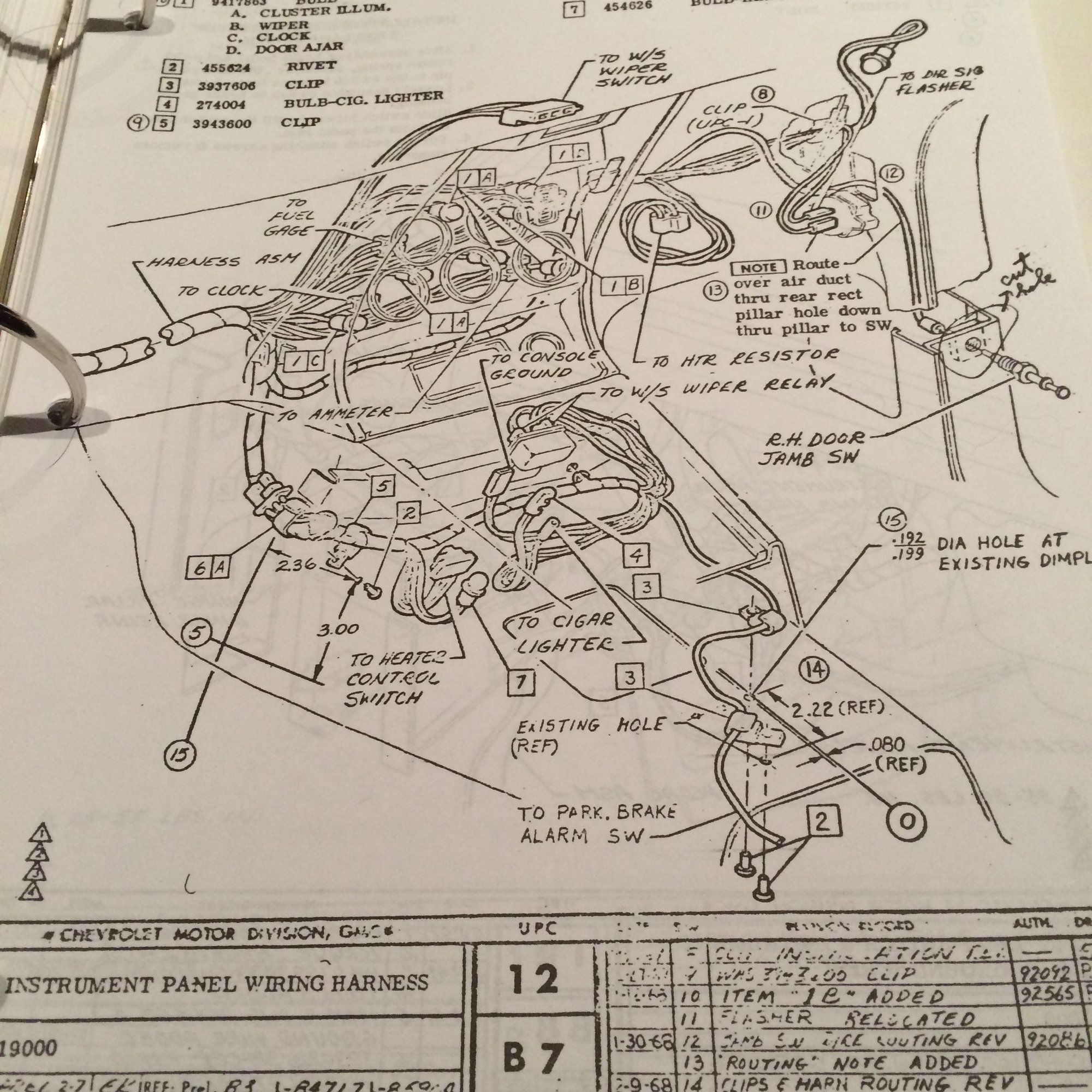

From the 68 AIM. UPC 12 B7. Pretty much in the center of the diagram. My 68 has the same one.

Originally Posted by sullyman56
The relay is for the windshield wipers.
Bingo...
