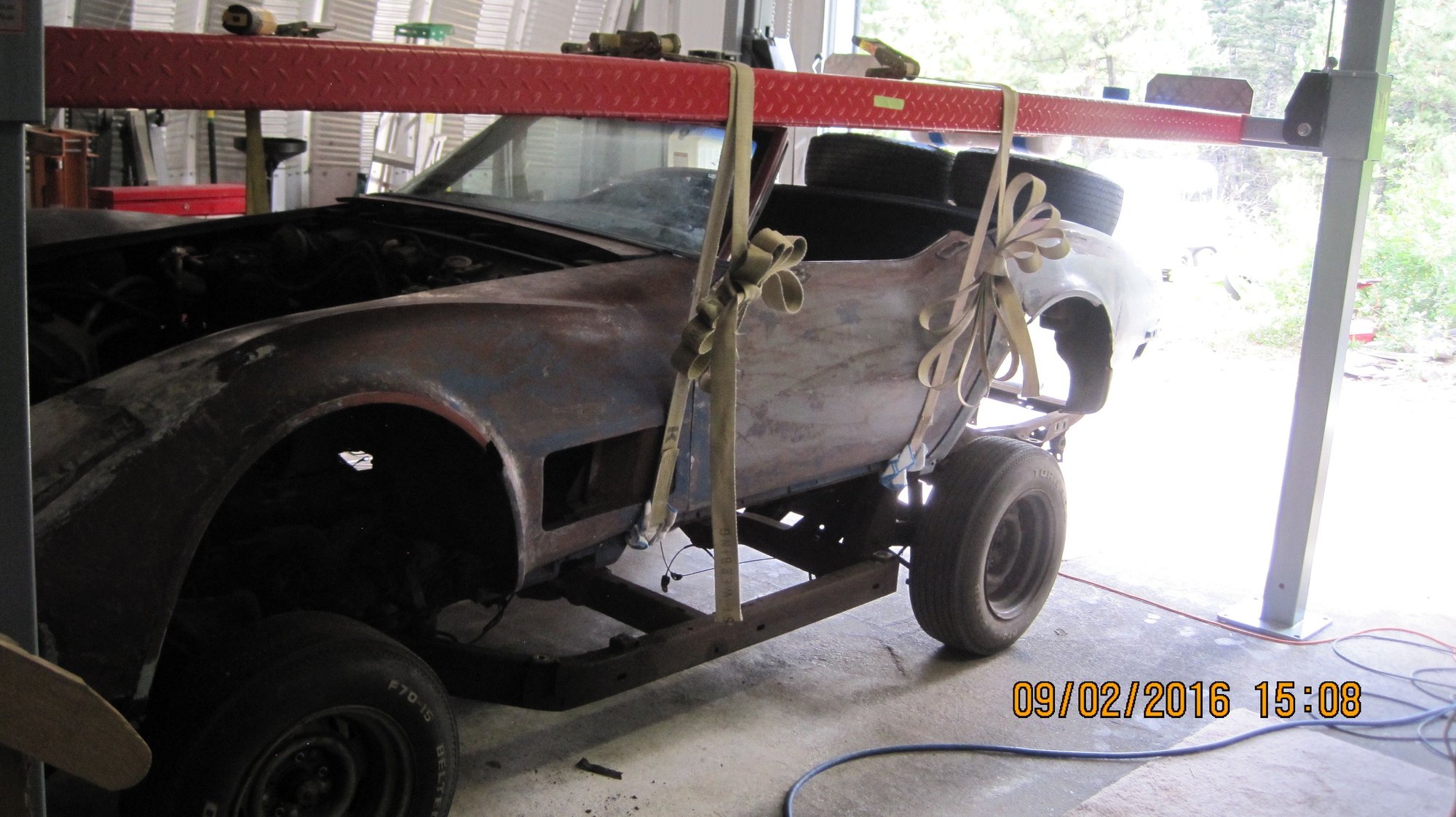

I am doing a frame off restoration on a 1970 convertible , 4 speed manual . I was wondering if the frame was suppose to have a removable crossmember or was this just with the automatic's?

Just the automatics, although there is a conversion kit to allow you to make the crossmember removable. This makes it so you can access the transmission without pulling the engine.
I'm adding a removable crossmember to my 'new' frame before I make the swap.
