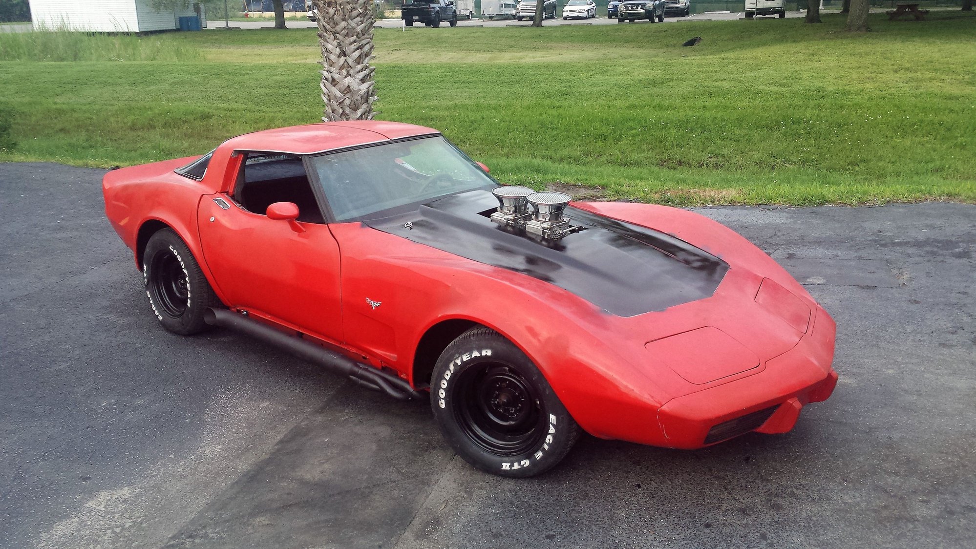

I'm using this shroud and fan set up on this engine in my 1978. It's a fairly stout engine and so far no cooling issues here in Florida. They accepted my offer of $129 delivered for it.
