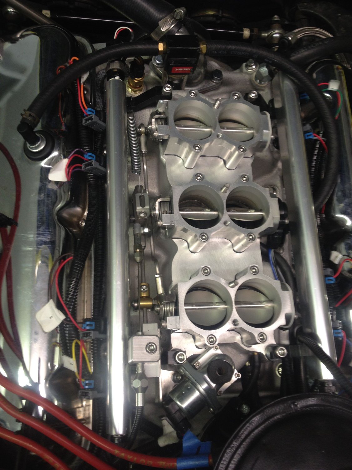

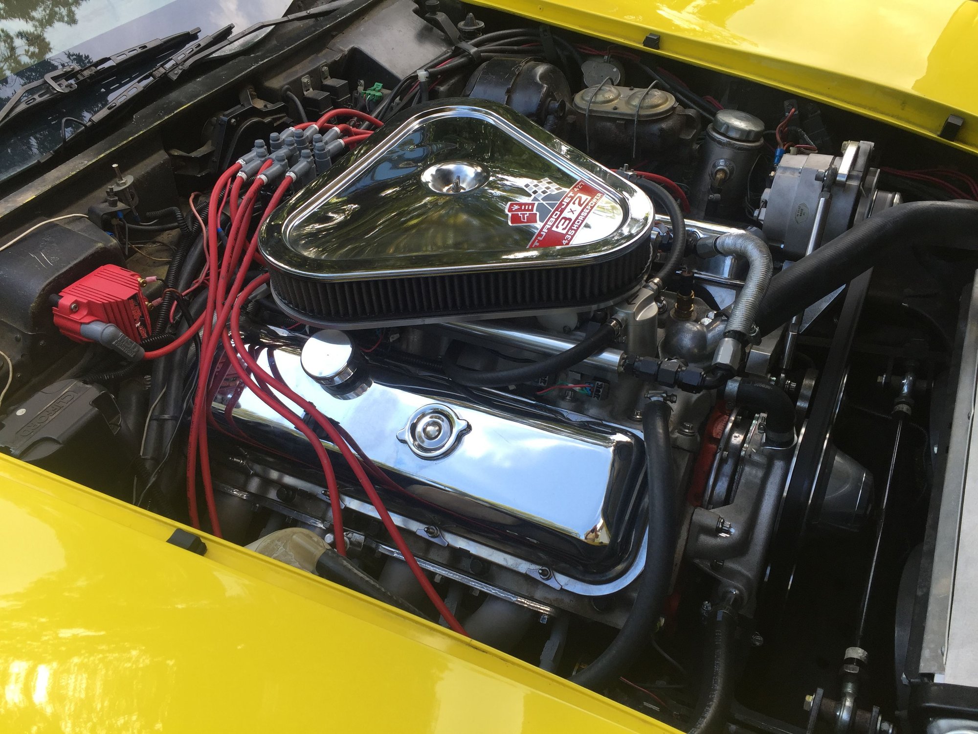

My 3x2 EFI was fabricated by Bruce at F&B. I know of two cars with the setup. One was a magazine car, and the other is mine. It was not cheap but workmanship is first class. Bruce was also great with the followup. He and I even worked together on fabrication of a new air cleaner base for the setup.
The manifold is based on an Edelbrock Dual Quad that Bruce welded up and remachined for the 3x2 throttle bodies. He also welded up and remachined the ports for my heads. The throttle bodies have a progressive linkage for the two end ones. With my stock 75 hood, I run a 3/4" taller than stock filter and still have ~1/2" of hood clearance. With an L-88 hood, Bruce could have used the Edelbrock Air Gap Dual Quad as a basis.
With my 496, ~245 @.050 hyd roller and ported heads (Dr. J Airwolf), I am putting down 413 rwhp. Tuner said I was restricted above ~5500 rpm by the sidepipes and STS baffles. Car drives great.
Manifold.
Completed install.
Dyno.

No pics of the welding, just some of the port work. Basically, the whole top was machined off, welded up, and remained for the new throttle bodies. You can see how the whole top is smooth on the first pic.
