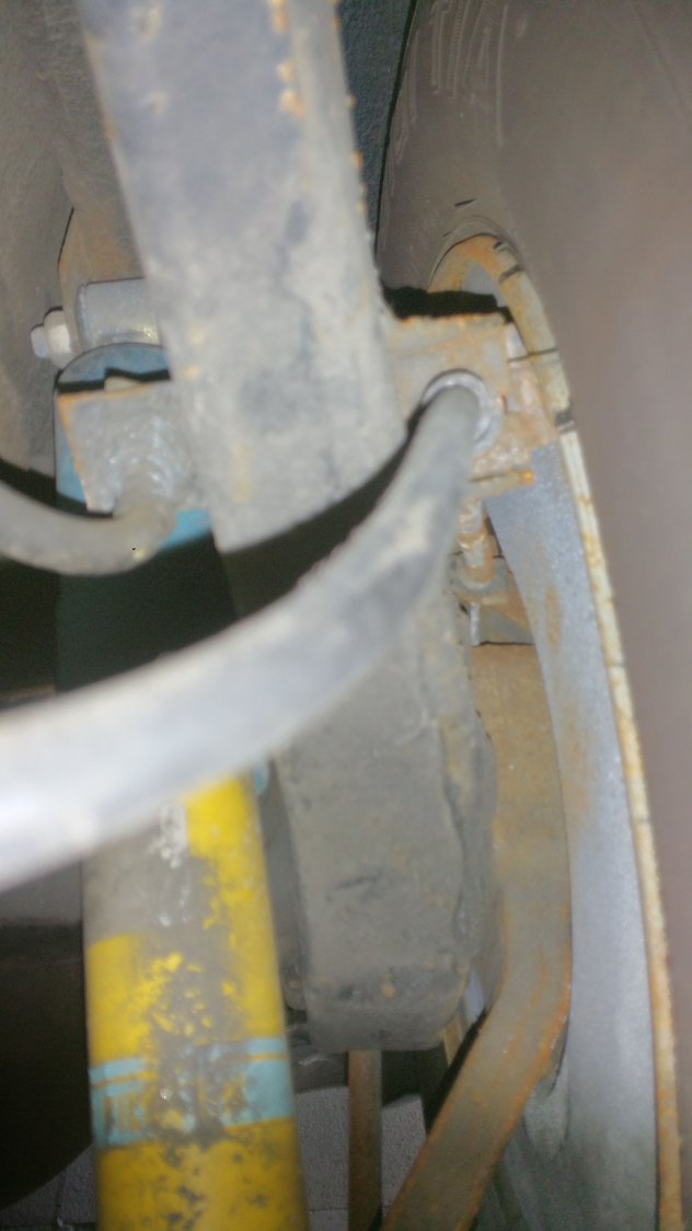

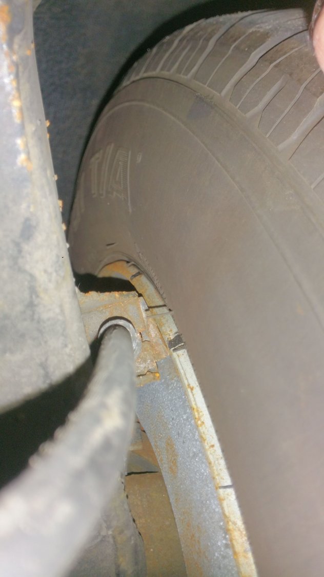

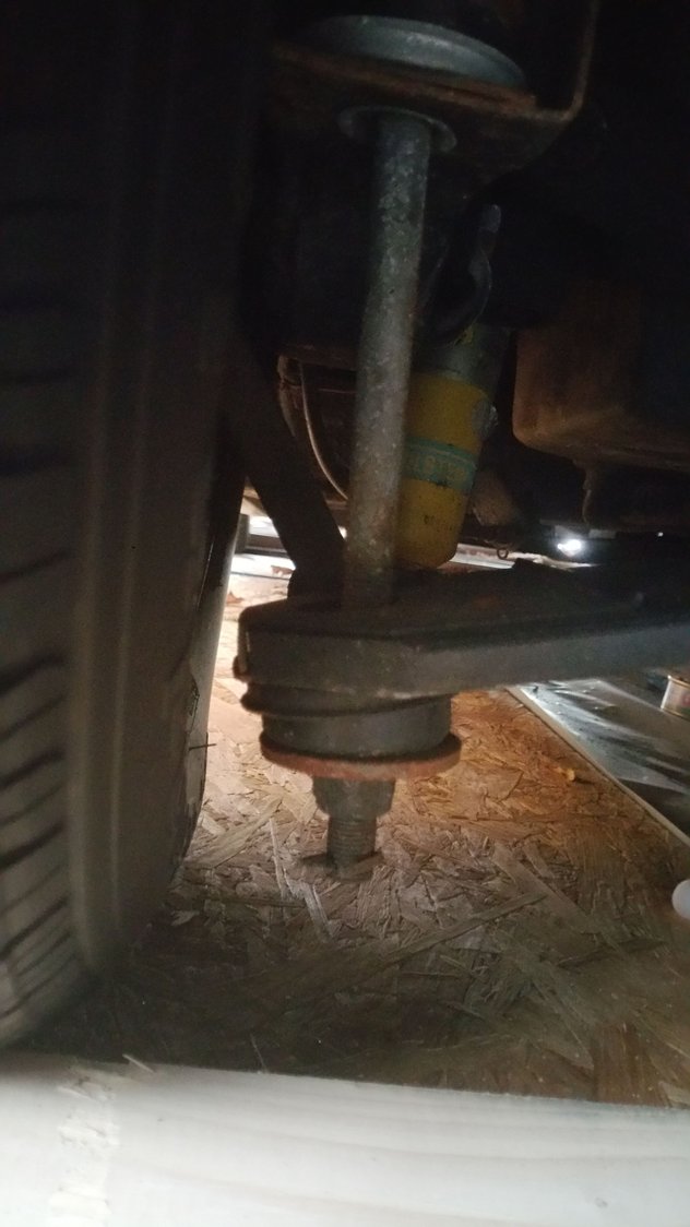

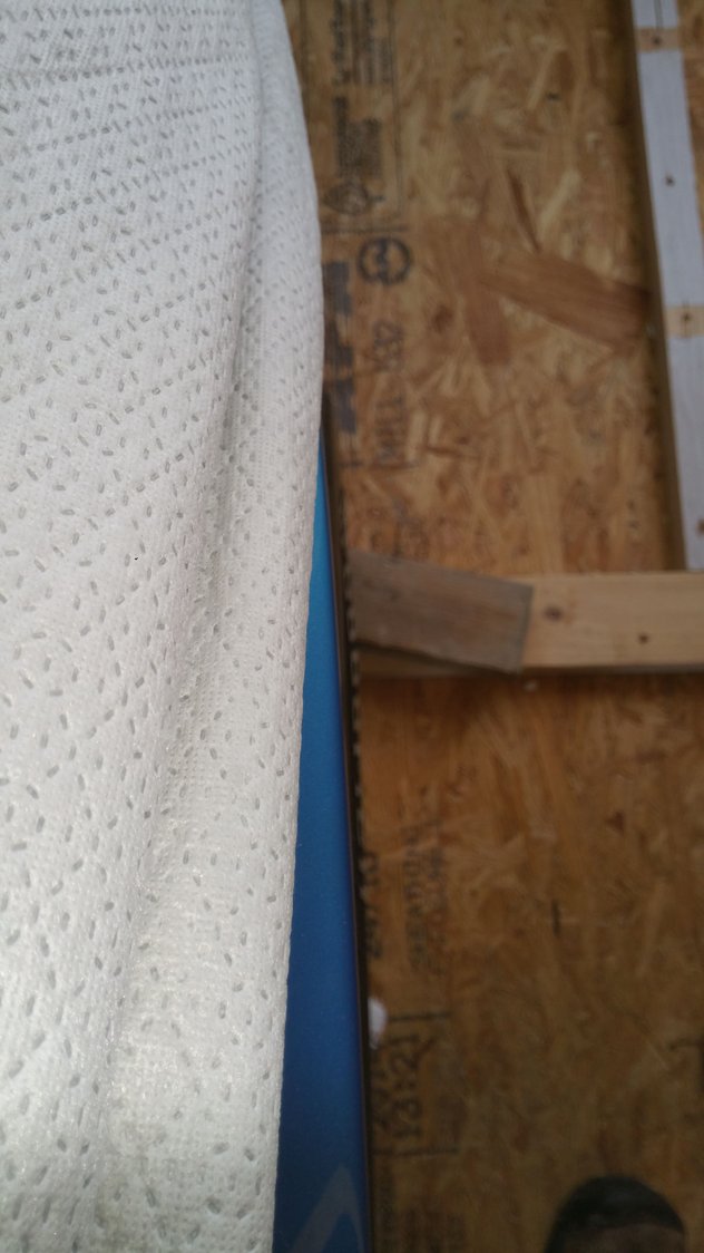

235/60 15 tire on 8 inch oem rim
tire even with outside of fender
spring space
clip from bracket almost hitting
Your rear wheel will be 9.3 inches wide so with a spacer they will look close to the pictures, but they are an inchtaller than stock so your speedo will be slow
