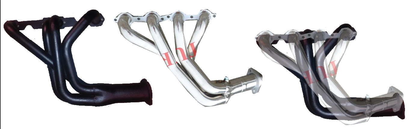

From looking at this pic which would most likely fit? There top left is ARH , below them the Melrose which hang low im told and next to them 3 ebay ones.
https://www.ebay.com.au/itm/A-G-Body...247526676?null
https://www.ebay.com.au/itm/361891389630?ul_noapp=true
Anymore pics of your exhaust and looking at the shapes of the others which would most likely fit?

those two ebay links , just watch the firewall clearance as they seem to come back a fair way.

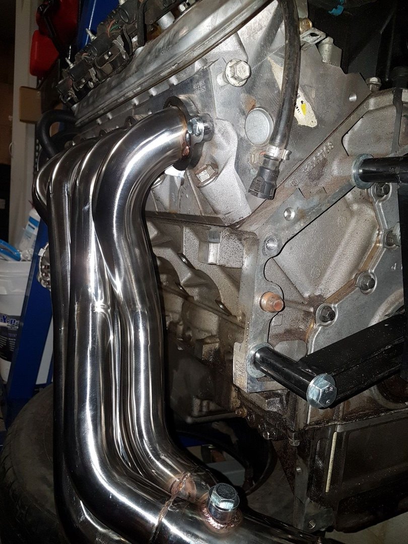

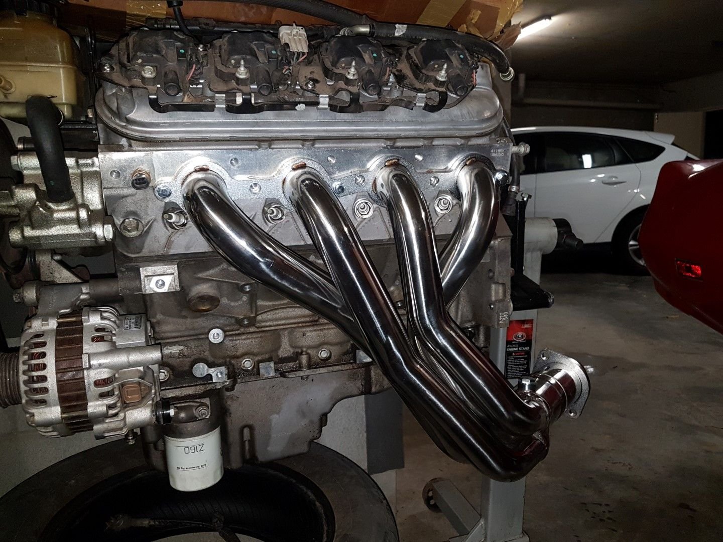

Now I'm not so sure, here's some pics of mine with my new HSV shorty type headers on .
left side ,
right side,
left side from a different angle ,
the bracket in the foreground is the gear selector ,
don't you have the engine mounts that move it forward ?

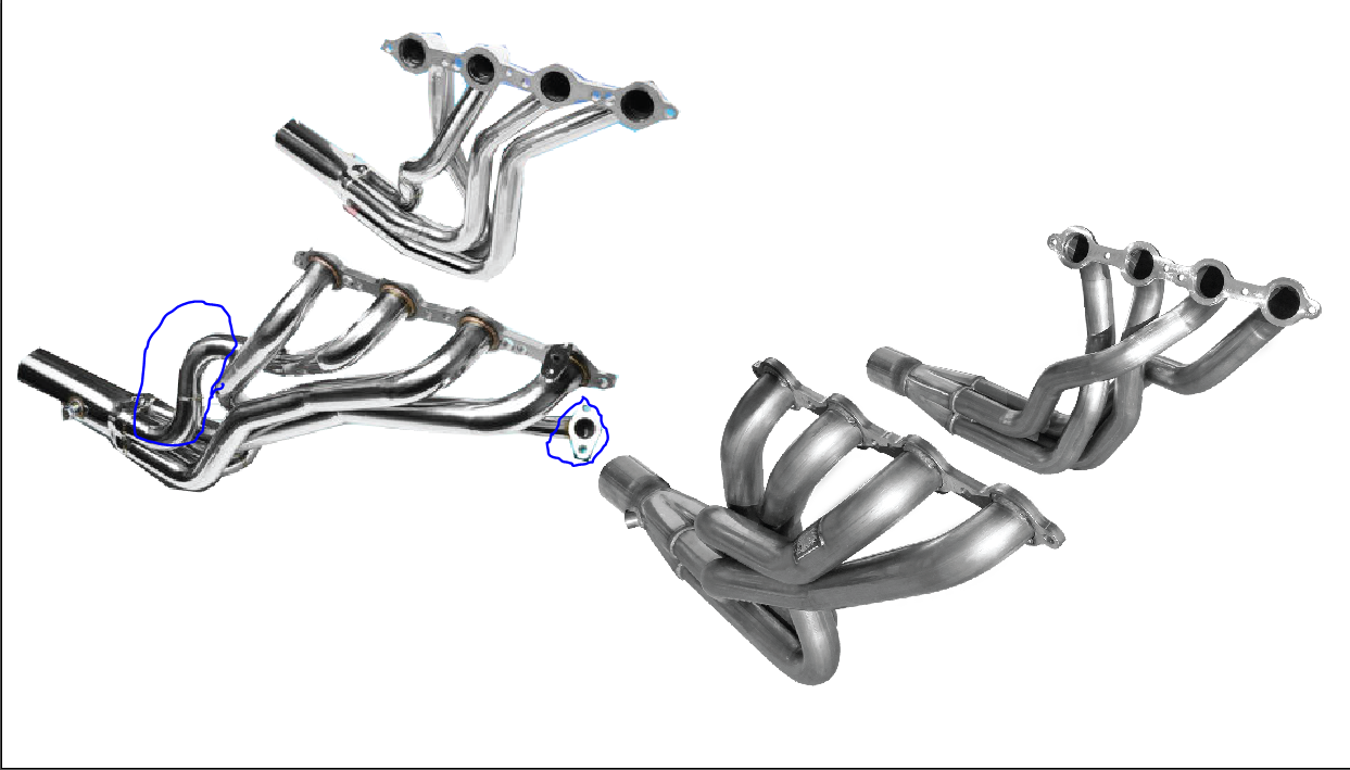

Based on my current 305 long headers the drivers side at least is very similar to the 97-04 corvette long heads.. i think i will try these
The DNA 98-02 camaro look very similar to the ARH headers but they have these EGR valves or what ever they are and also the pipe i circled may have issues with heater box ??

Angle of the collector on those looks just like the Kooks on the LS6 on an engine stand in my shop. They were on a C5, I'm hoping to have them tweaked to work on my swap, I can't see how they would clear a transmission or bellhousing.
thanks for the reply. So all c5 long headers lile kooks and these will need to be cut and re welded ? I looked up c5 4l60e trans pics and they have tgis bubble at the front which is a different shape to the regular 4l60e.
