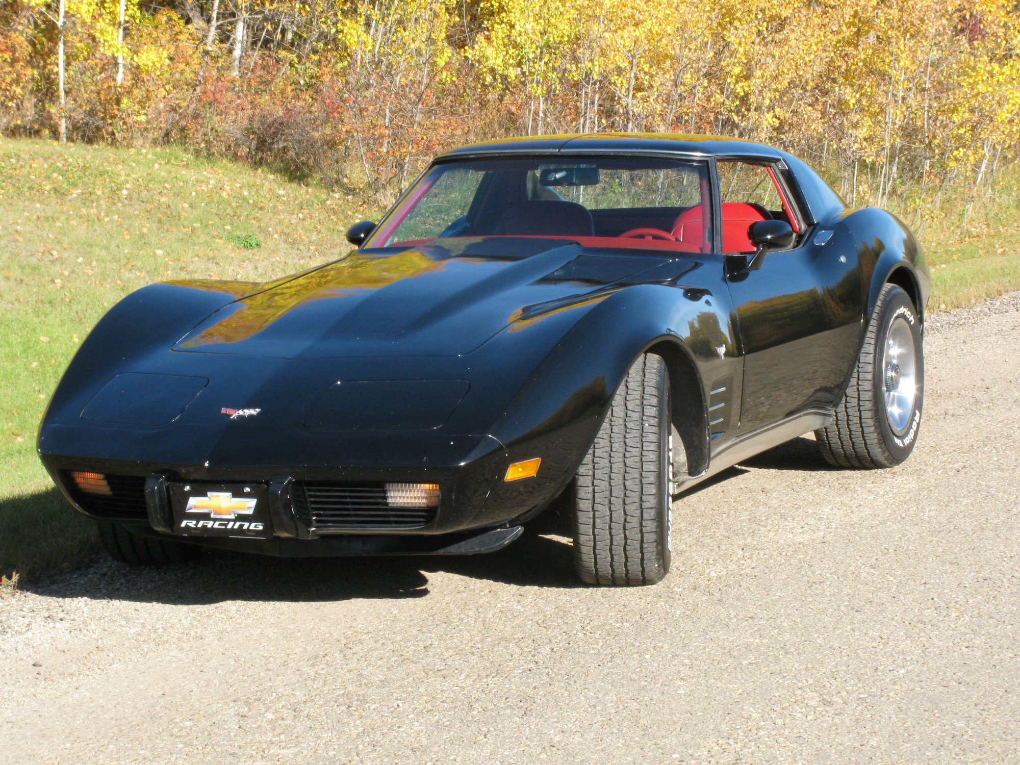

I have 255 / 60's on the front of my '77, and only have a rub on the inside frame rail at full lock....i just back it off a touch when making a sharp turn. No rub at all on the front lip, and my car is lowered about 1 1/2"
I have standard steel wheels and trim rings on mine
255-60-15's
