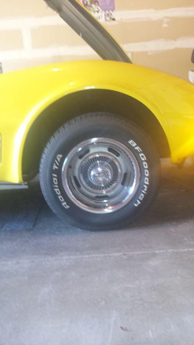

Aluminum intake, cylinder heads and shorty headers. Car sits 3" higher measured from floor to center of fender lip compared to the old stock 293lb. springs. Going to take them out this weekend to cut them. Searched and read all the threads in regards to this issue and it appears I will need to cut at least 1 to 1 1/2 coils to get it back to at least the original height which was 26 3/4 inches. Just asking what those who had this problem how much of the spring did you cut to drop it. I really would like to do this cutting just once. Have poly control arm bushings in upper and lower control arms. Car has been driven about a hundred miles and camber has gone from negative to positive. 245/60-15 tires.

Thanks for your reply. I'm hoping others who had the same issue will chime in on this thread so I can get a better idea on how much to cut.
