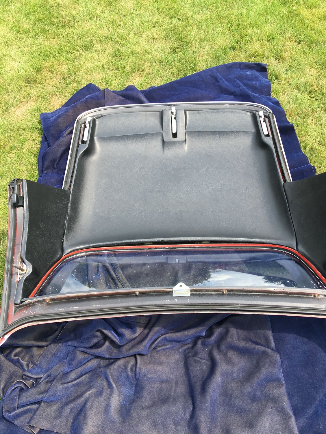

Well, I just purchased a 72' top for my 68 and it has the center bolt mounting plate. This top has all the original hardware and inner head liner.
From my investigating they all should have the center bolt, chrome end tips after /mid 69. On my 68 I had to change the studs( long all thread rod ) that went into the soft top slots on the deck lid to the ball type on the soft top to make it work.
Also the deck lid needs to have the side bolt retainers in the sides of the deck lid behind the seats. This must be done-
Side bolt that mounts inside sides of rear deck lid
And no matter what you do- you will scratch the inner deck lid with the mounting taps from the top- it sucks I know
There will be a big gap between the top and deck lid if there is no center bolt.
All original 72 top, I bought from the second owner of the car, the hardtop was on the car when he bought from the first original owner. Center bolt mount is riveted to top.
But man it makes the car look so much more classy
