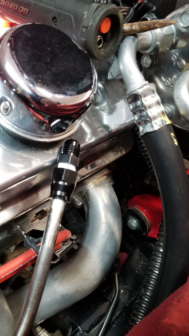

Thats right.! I stopped ny my local muffler shop and purchased a bung and had it welded in place. I drilled a 1" hole and it fit properly on the lip of the bung. Although I didnt try them, the clamps for the included O.Sensor plate seem too small to wrap around the sidepipe collector..
Quote:
Originally Posted by wendellp601 View Post
That no-weld bung does not appear to have the correct radius for 4 inch side pipes.
This is what I used to cut the 1 inch hole
