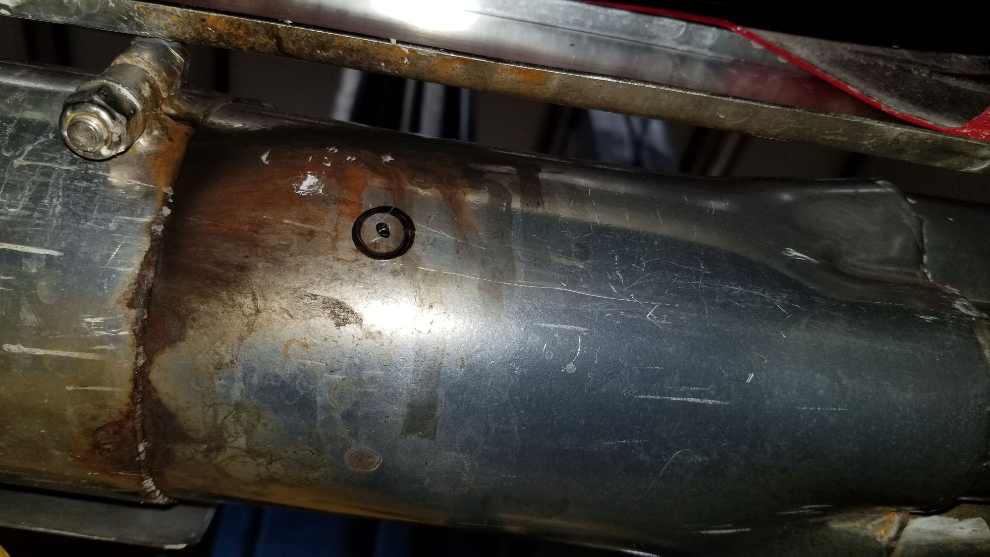

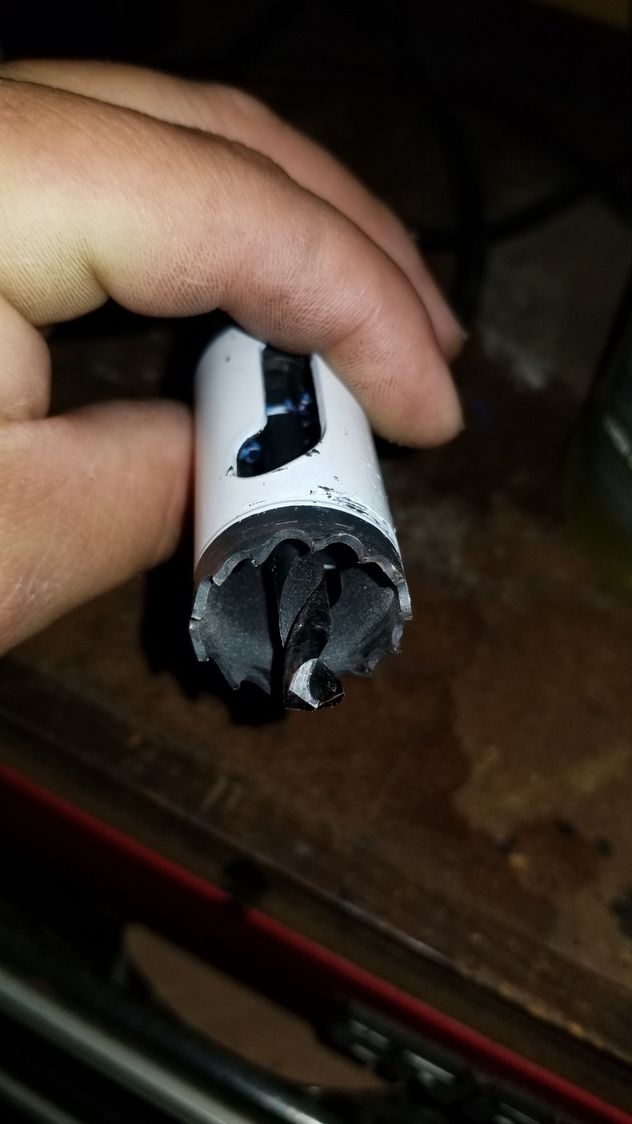

Thats right.! I stopped ny my local muffler shop and purchased a bung and had it welded in place. I drilled a 1" hole and it fit properly on the lip of the bung. Although I didnt try them, the clamps for the included O.Sensor plate seem too small to wrap around the sidepipe collector..
This is what I used to cut the 1 inch hole

Could you post a clear photo showing where you located the sensor on the side pipe?

I can take more pics later , but the seam to the upper left side is the sidepipe and the upper right is the frame.
