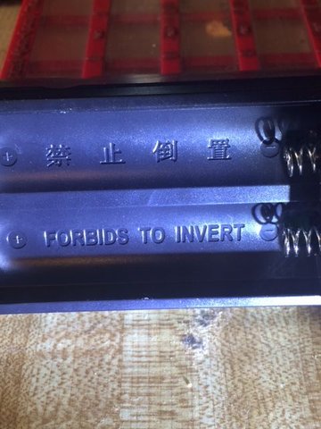

I got sucked in initially by the low price-$199.99- and was hoping the rods were a name brand direct from the mfgr to lower the cost.
I can't think of an engine part more vital than the rods, so why chance it? Some Chinese stuff is OK and is often fair to good quality, if you can tolerate the poorly translated instructions, such as these on the battery charger for a tactical LED flashlight I recently bought.
