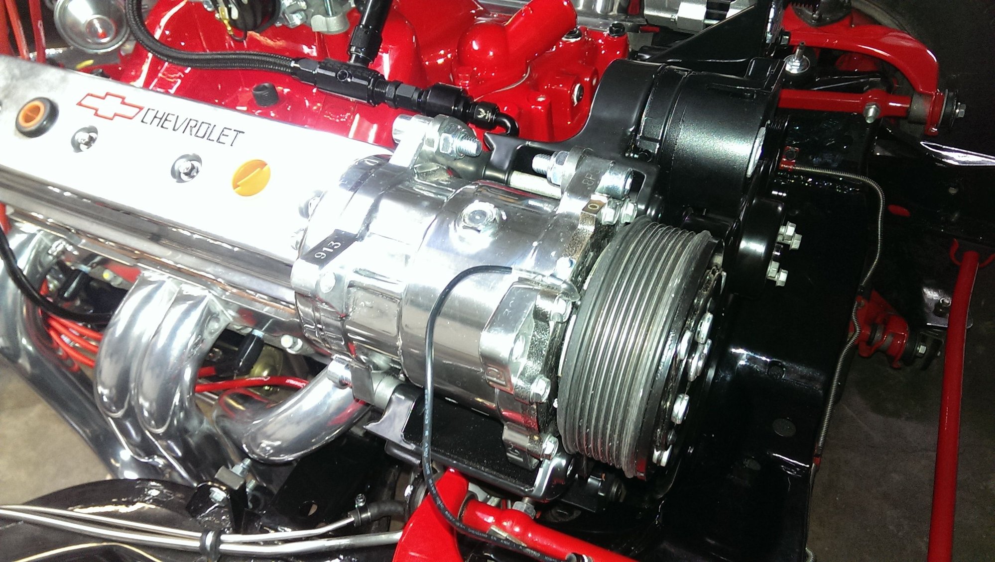

How did you get it to fit with tall valve covers? Or did you have to use stock height?

This is as high as it went with centerbolt covers. and I had to get the adaptor plated for compressor to fit serpentine system.

Thanks redcruz1120, I have the adapter kit & picked up some cheap-o stock height covers for testing. Appreciate the reply.
EDIT - Test valve covers came in and stock height works great, even clears my Comp Cams valve train, plus gives the connector on my alternator more room too.
Win-win

What is this adapter kit? I have the same setup but could only get the R4 compressor to fit. I would like to get the Sanden as shown, thanks

Vintage Air has one for about $70 & Dirty Dingo has one for $50. I bought the Dirty Dingo one because I'm cheap.
https://www.dirtydingo.com/shop/prod...oducts_id=1622
http://www.tbiproducts.com/index.cfm...prod/prd20.htm
https://www.jegs.com/i/Vintage-Air/960/141805/10002/-1
