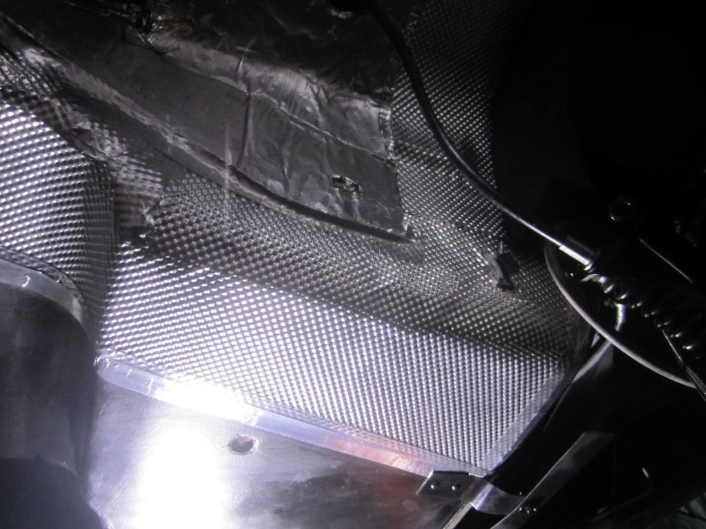

Tim, I have a question.....
DEI offers a variety of self adhesive heat barriers/reflective materials. If someone were line the exterior of their floorboards (under body) which of your products would work best? Are they best suited for 'track only' applications or do they hold up well (stay stuck) when used for daily drivers?

Hi Jim,
Check out our Floor and Tunnel II material. It is a 3/16" thick dimpled aluminum facing with glass mat backing, and uses an aggressive pressure sensitive adhesive. It will fold, bend, and hold shape. It also cuts pretty easily with tin snips or a heavy duty pair of scissor. This material is designed to be used on the under side of vehicles. We have had it on everything from motorcycles to trophy trucks with great results. http://designengineering.com/floor-t...e-heat-shield/ . Please let me know if you have any other questions.

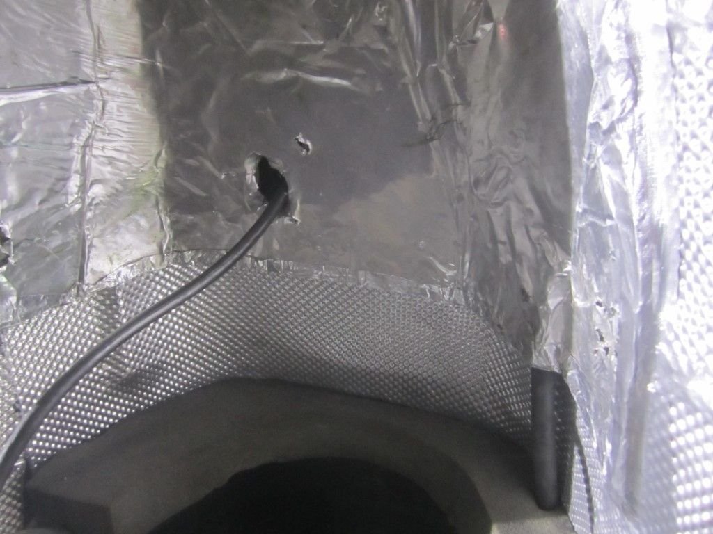

http://designengineering.com/product...ive-materials/
(I've wrapped under body wires with Cool Tape)
I put a layer of the Floor and Tunnel II above the exhaust pipes and along the tunnel where the factory insulation wasn't a year or two ago and it works very well, installed easy and 2 seasons later it's still firmly in place.
I also had the section of pipe from the firewall back to the floor kickup wrapped in the lava whatever (don't recall the brand, may have been DEI) and it made a difference in the heat as well. Aluminized pipe and when I removed it to take the transmission out two years ago there was no indication of corrosion on the pipe and different than anywhere else. That said I don't drive in the rain if at all possible and the pipe in those areas don't have any collectors or pockets to trap moisture...
