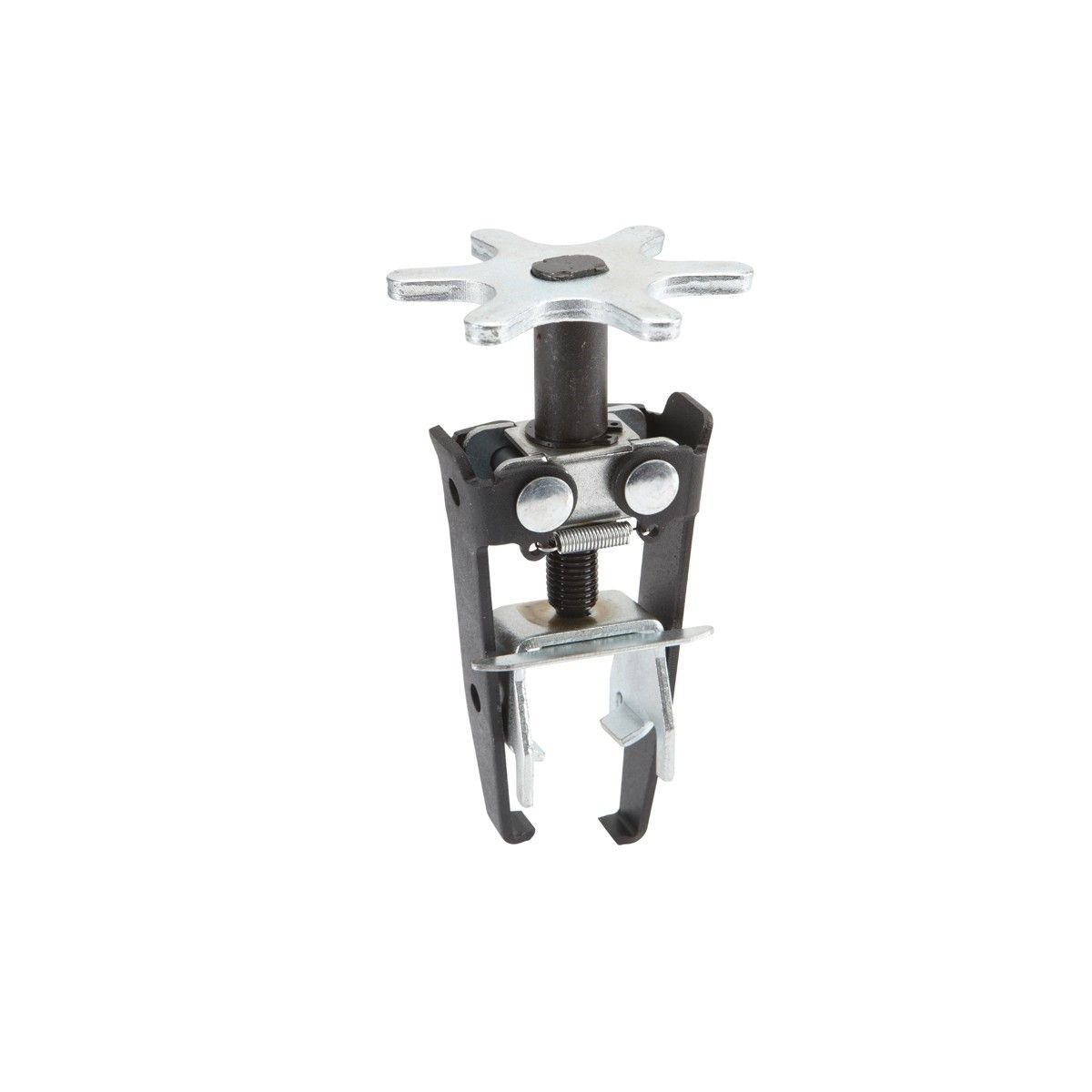

I use a tool like in post 8. Once the springs compressed lightly wack the top of tool with hammer to drop the spring down n away from keepers. At this point remove keepers by hand, After hitting top of tool if valve drops its simply a matter of grabbing the tip by hand and pulling it back up. At 150 psi I had no issues with valve drop.

That valve spring compressor shown in this thread works ok, better for single spring applications but a a pain for dual spring apps.
I would recommend one like this.
