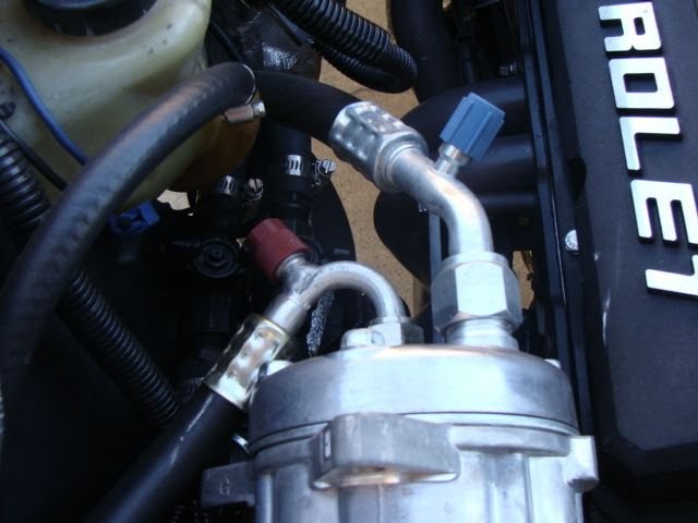

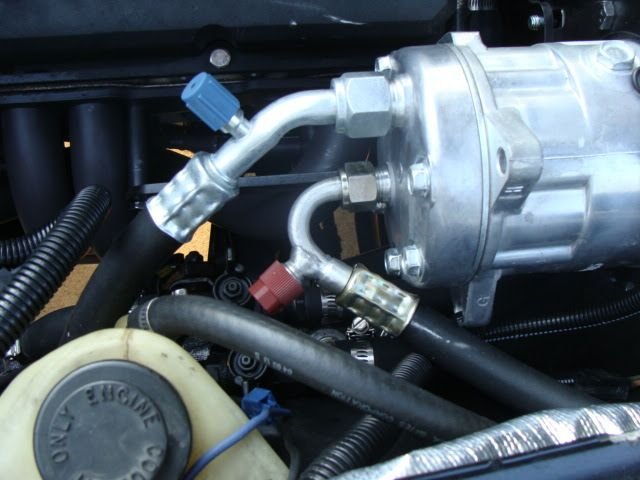

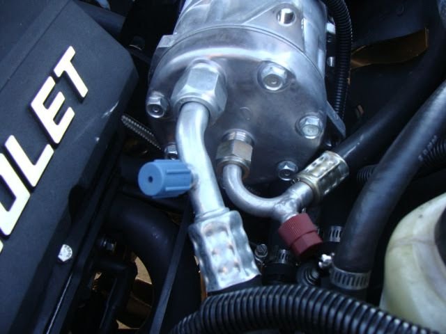

Hey Jebby,
I put a Classic Auto Air kit on my '81. It had factory air but the hoses were shot (and everything else). The kit uses the Sanden type compressor. It came with new hoses that had to be made up. I went to a local garage and had them made up. The kit used different brackets than the factory to mount the compressor. It cools great in my black on black Vette. Even here in the brutal Central Texas summers.
Craig

Very cool...thanks for that.......were you able to tie into the factory reciever drier and evaporator lines? That is my worry....my system is in excellent condition and do not want to pull any of this stuff out.
Yes it is brutal here some days......why I want it up and running......do you have any other detailed pics?

Yes. The lines came with the correct fittings to connect to the factory condenser and the accumulator. The accumulator was quite a bitch to connect due to the location. I went in from under the car to get to it
You may just need to splice into the hoses that you have. Wouldn't that be nice? Example -
http://www.airsept.com/Products/Details/38
We need to get together before then Jebby. I'll try to get down there for a show soon.
