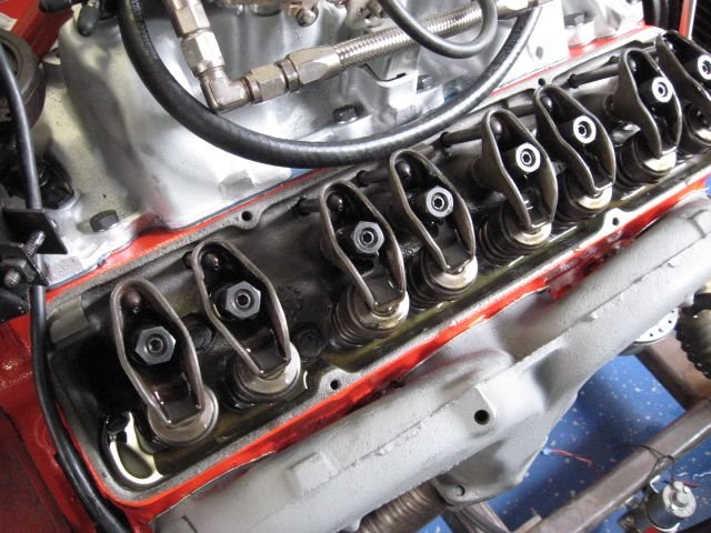

As far as priming....use the Proform SBC/BBC primer with a strong cordless drill on medium speed........spin the drill until oil comes from all rocker arms and rotate the engine periodically while priming.

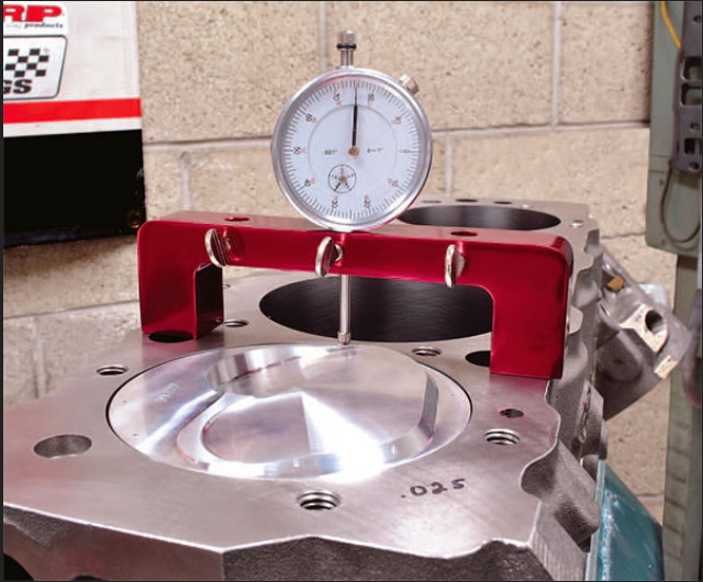

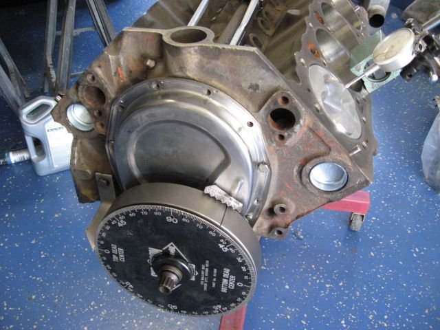

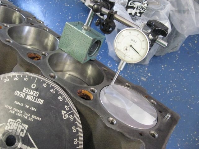

Top Dead Center is determined using a dial indicator on the #1 piston and a degree wheel on the crank. The crank is rotated until the piston, as determined by the dial indicator, is at a noted distance from the top of the bore, and then rotated until the piston is at the same distance back down the bore after passing TDC. TDC is the exact halfway distance between the two as noted on the degree wheel:
Dial indicator set up to determine piston position in bore:

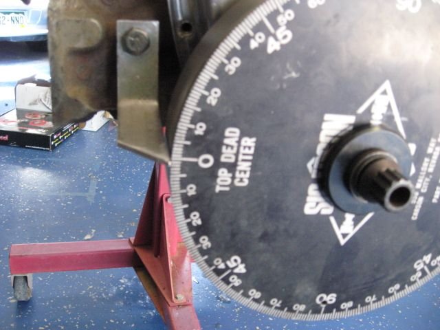

Degree wheel attached to crankshaft and used to determine TDC based on piston position:

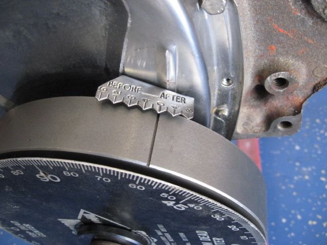

Stand-alone pointer used with the degree wheel to determine TDC:
TDC verified to agree with the factory timing tab:

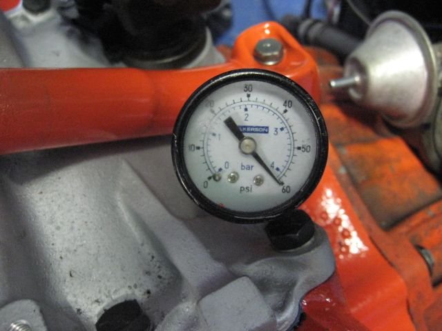

The engine is oil primed using either a special tool that simulates the distributor body in the block, or by using an old distributor housing and shaft with a drill motor:
Spinning the oil pump with a drill motor (using the distributor housing tool) will generate full oil pressure:
While spinning the oil pump with the drill and tool, the crankshaft must be turned over, since many of the lifters will be in a position that blocks the oil flow through the lifter at any static position. Once the engine has been rotated 2 times with the oil pump turning, all of the lifters will have seen throughput of oil, and oil will be discharged at the rocker arms:
