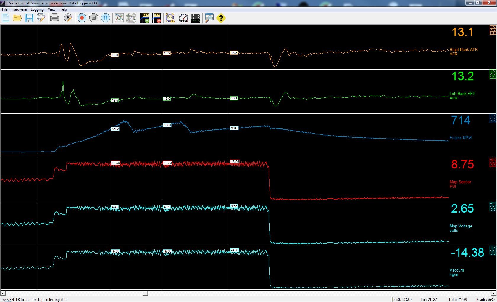

Here is the brand I am using. Zeitronix. I have a ZT2 + ZT3 since each unit works with 1 channel. They now have a Entry level ZT4 for both (Dual setup)
http://www.zeitronix.com/Products/Zt-4/Zt-4.shtml
I
don't have a constant display running but more important I can connect to the laptop and data log the inputs. Here is a example of the data
The use the ZT2 so I can connect other inputs such as RPM , Map Sensors (Vacuum / Boost), Temperature sensor etc. This is showing a WOT Run 1st thur 3rd gear. I marked 3 points to display the AFR , RPM @ that given point. You can move the cursor to any point to see what the rears are to analyze what is happening at any RPM / LOAD.
