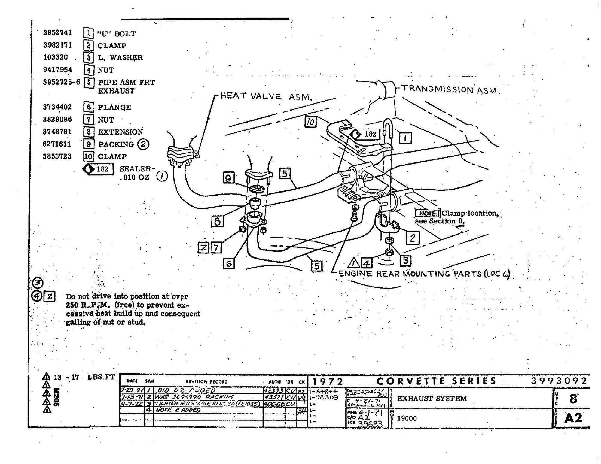

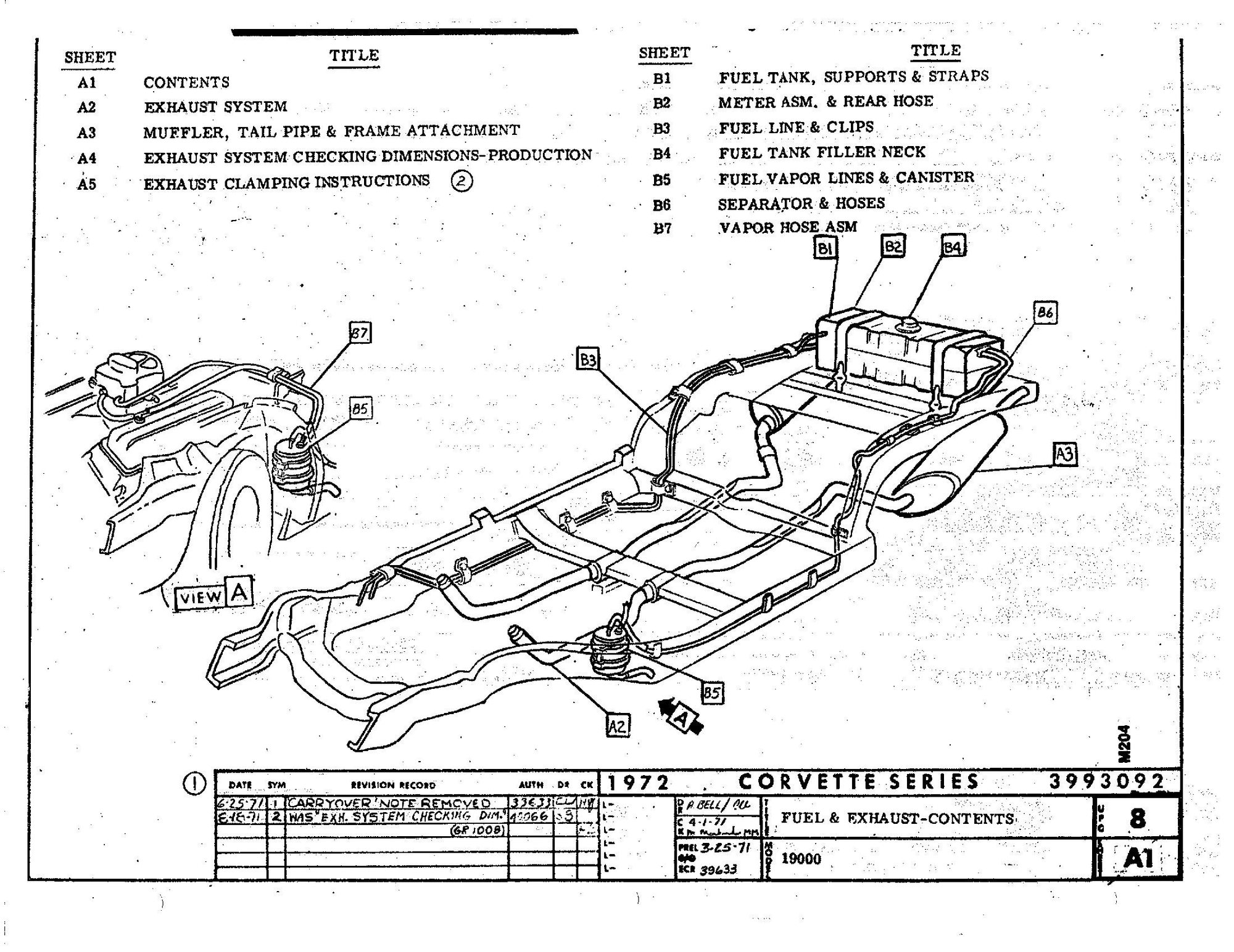

Yes it did. Here is the exhaust system from the assembly manual. This manual, also called the AIM is one of the books worth to help you figure out how your car was put together.

Yes, all LT-1s had the heat riser. I removed mine and blocked off the exhaust crossover through the intake manifold.
