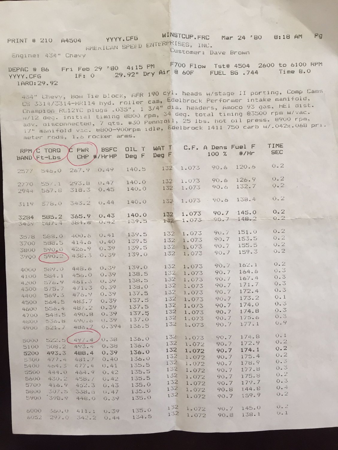

Originally Posted by platinummaker
I would have to echo Gkull with exception to the ultimate potential head flow difference favoring the BBC. Here is my dyno sheet from my Bowtie block 434 SBC of 15 years ago.. Built for street in a heavy XJS Jag. 590 ft lbs of torque at 3900 rpm. Will be changing cams and putting this in my 72. Funnest street engine I've ever had.
That is some impressive torque for 434 CI, I wish you were closer my 460 BBC Tri-power puts down 481 to the wheels (N/A) I'd need a rolling race tho (4 spd car, so non-sticky tires are required to prevent breakage). I am complimenting your motor by the way, 15 year old and still impressive
If the dyno sheet is RWHP ignore the following and see me paying homage. Do you think the heads are holding you back or did you cam it on purpose just for low end? I ask because I only calculate 1.14 HP/CI and my AFR 265 460 is at 1.21 HP/CI with the Tri-power (1.3 with a Dart S/P and 850 Holley)

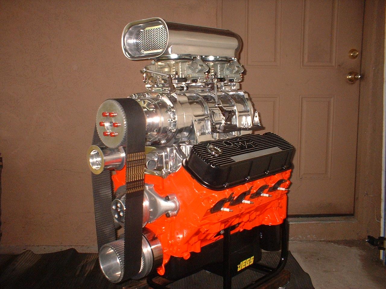

Originally Posted by Little Mouse
Who builds a 454 bbc anymore a restorer. Lol. Like how many people build a 327 anymore. Lol
I still build 454's and I'm not a restorer. Here's the one I'm putting in my '69:
Don't knock it until you've tried it, lol....
With the blower on my 454 I can make the power of a huge cube big block without having to spend the huge money needed to build one...
And you cant deny the awesome look of an 8-71 blower...
As for how the car will handle around corners with it that's a different story, I'm not building my 69 to go fast around corners...
Badass! 👍
