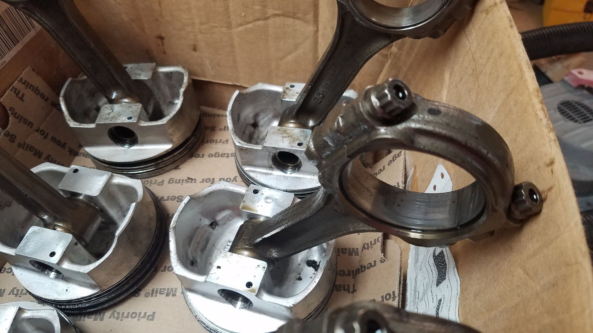

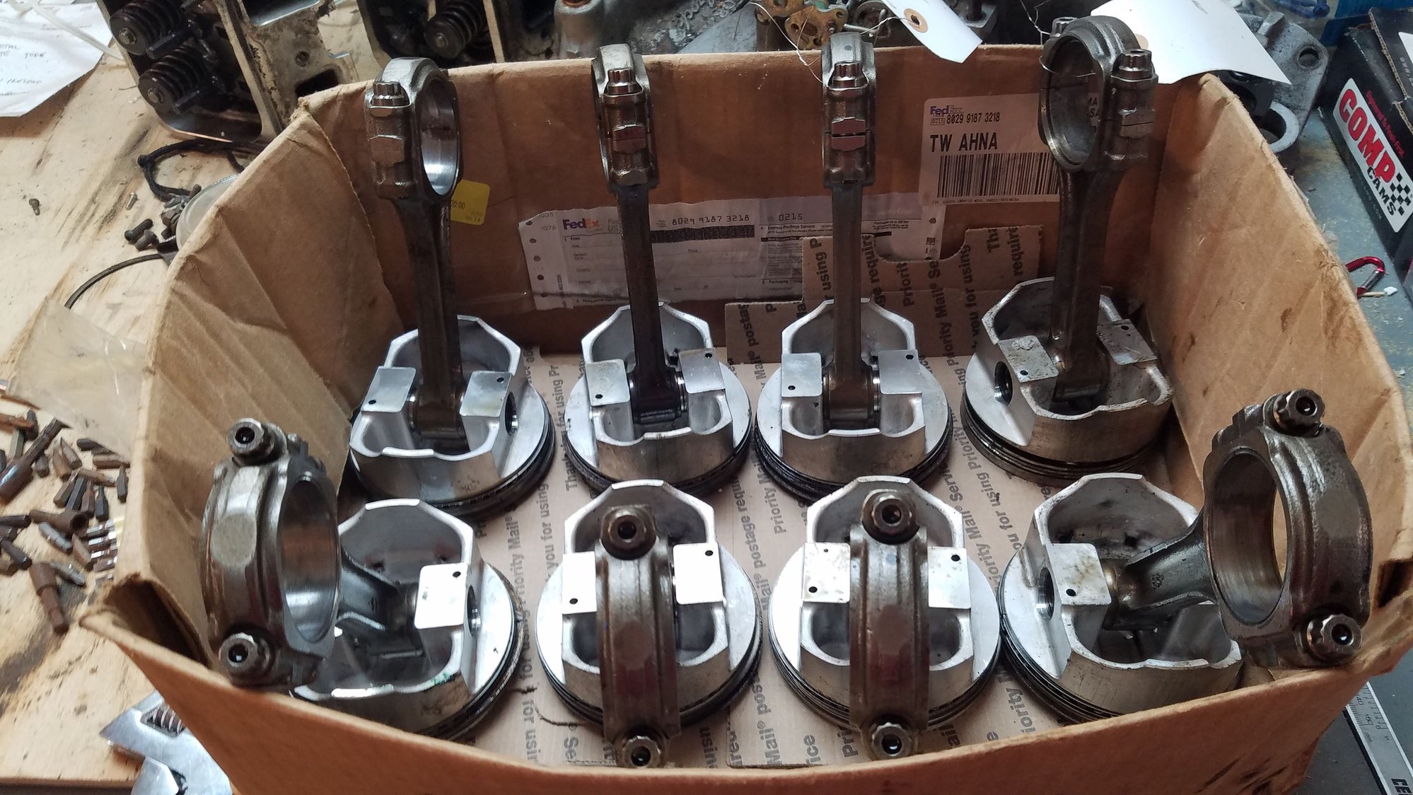

Pistons are Probe forged but no markings/id #s so hard to identify.
They have a mild dish across the entire top....see pics
No way to figure CR unless I can do further measurements like piping the top with a burette for the CC displacement and measuring the compression height. Rings are 1/16-1/16-3/16
May or may not be reusable if this block needs to be bored out .040 over but could use them in 2nd build of 421 and the new Dart SHP block I have.

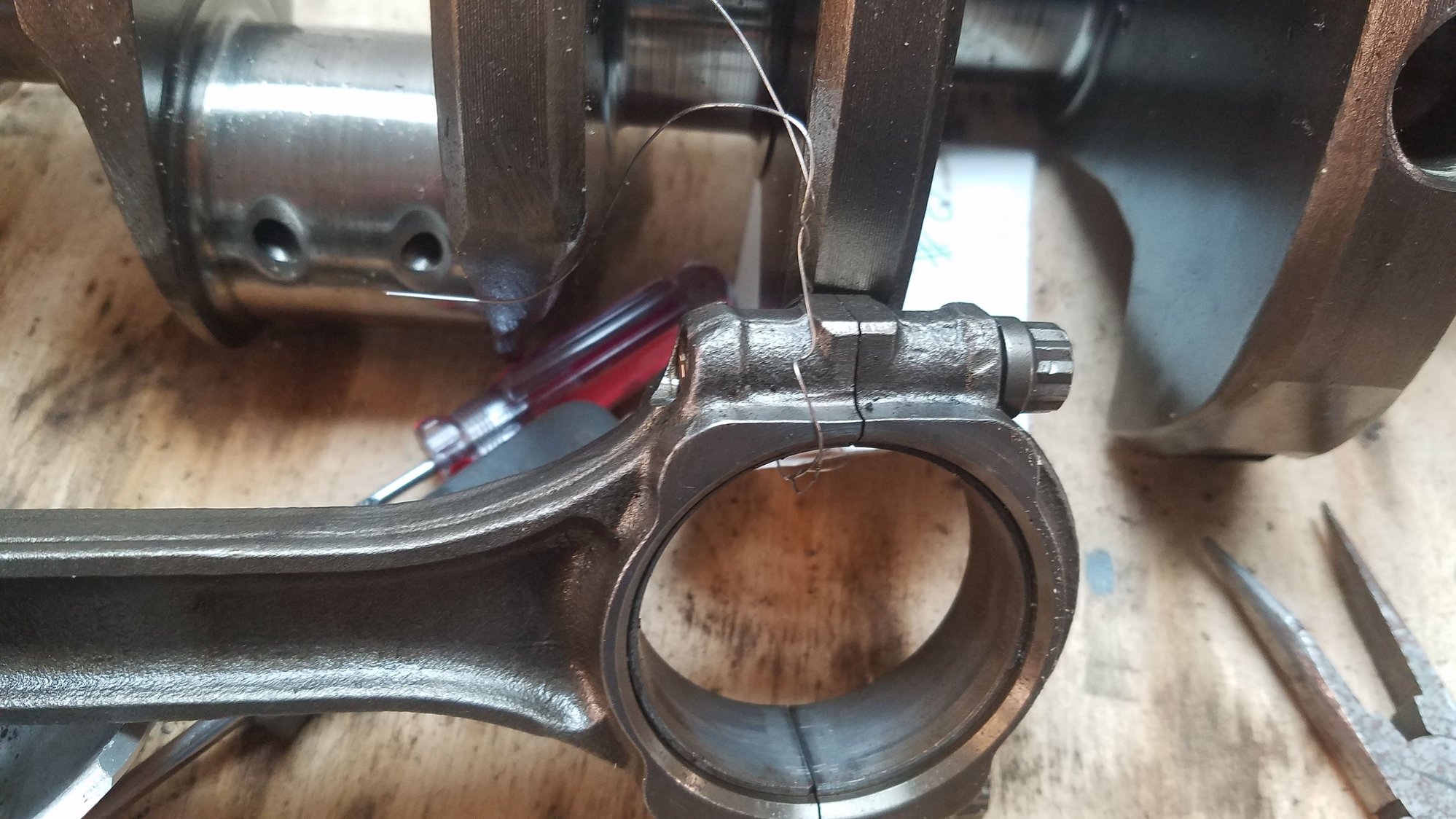

Now the rods are Eagle SIR rods with ARP cap screws but no identifying marks other than ES and Eagle on the cap screws.
My main concern is that there was a lot of grinding on the bottom of a couple of these.
Have not taken one off a piston to get accurate length measurement.
No easy way to tell if they are 5.7 or 6.0 length or even some other length.

Those pistons were orginally flat tops... someone machined that dish in them on a lathe removing the PN which is stamped in that area of the top. You will have to cc one with a burrett or since its round, its easy measure the OD and depth of the cut... then do a little math to figure the volume..... add 7cc for the valve reliefs.
The rods are 5.7" which means 1.425 compression height pistons.... its easy to tell the differece because a 3.75 stroke and 6" rods use a 1.125 compression height and the wrist pin is in the oil ring groove, which yours is not.
As for the grinding on the rods.... done to equalize the rod big end weights during balancing. Very common and nothing to worry over.

I had planned on using 6" rods with an internal balanced 3.75 stroke crank...so this rules out using these pistons also.
Or go with Scat 5.7" rods.
I don't want to use the Eagle rods either way.
So basically I have an internal balanced 406 sbc setup for use in a 400 block. Complete with cast crank, Eagle forged rods and Probe forged pistons.
Fully balanced (I saved and marked each piston by position when removed).

Default your conrod length quick check
OP
pin OD ~ 0.927" ---------------------------------------- 1/2 that ~ 0.464"
rod journal OD ~ 2.100" ------------------------------ 1/2 that ~ 1.050"
0.464 + 1.050 = 1.514"
6.0" - 1.514" = 4.486" between bottom of pin and top of rod shell = 6" rod
5.7" - 1.514" = 4.186" between bottom of pin and top of rod shell = 5.7" rod
saw a pic with pistons on rods with shells in bore.
reach in there with a steel rule or caliper & measure from top of shell to bottom of pin. My bet's on 6.
it'd also pay to get a cheap, small graduated cylinder and cc piston top; also measure compression height.
