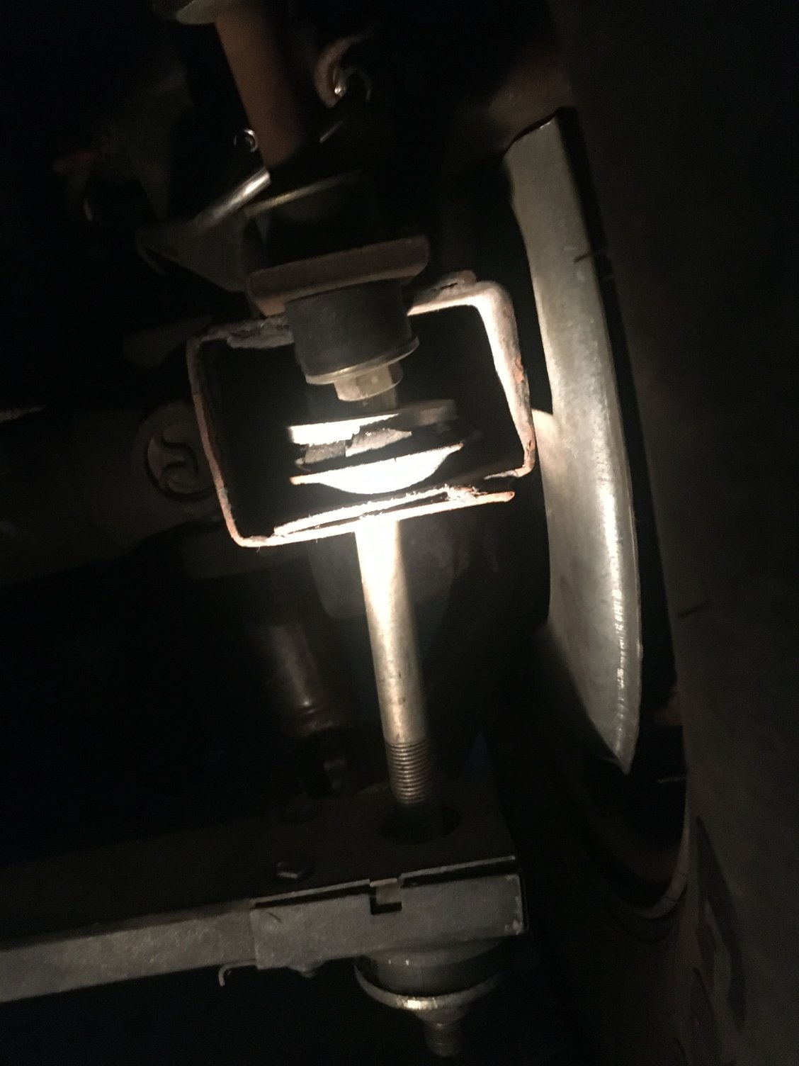

I just took some poly bushings off the rear spring bolts that had been on there for about 10yrs ago and were from vbp. They've seen better days.
bluegtp
is this the way they came out of the rear arm? Mine have another set of metal plates between the bushing and the frame and spring
if you have the front spring is it the same?

Originally Posted by monstr
bluegtp
Yes that's what vbp sent over years ago. The washers on outsides, poly bushing, and the monospring and t arm has a cup/washer that is attached. Looks like what your pic shows at the spring, I'm not sure what you have going on with the t-arm side or maybe they were different through the years? Mine's a 79. I didn't have a front monoleaf so i can't help you there.

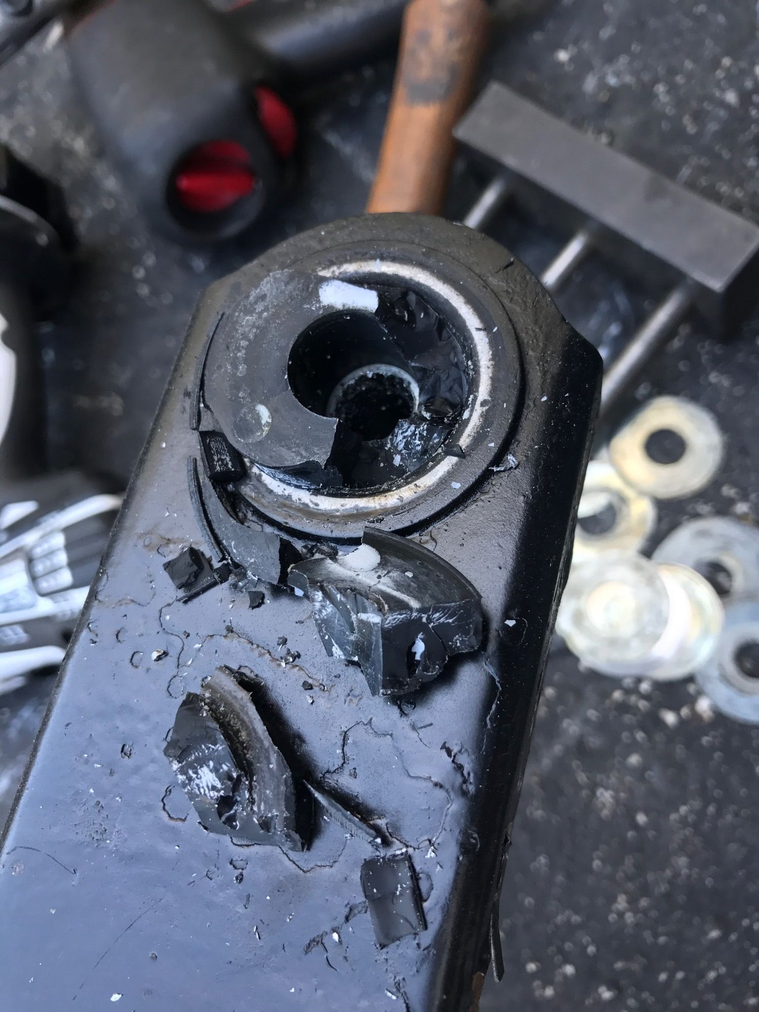

Originally Posted by H8 mondays
I installed the poly bushings and had a 4 wheel alignment done to the car and it drives like brand new no more wandering in the lane and feeling like I was always chasing the car is gone. Only time will tell how long they last but as a weekend car they will a long time. I can't beleave this was resurrected from June and everyone is still arguing about it. This seams almost as bad as what oil should I use. Ha
Have a great day all and thanks for the help.

2024 C3 of the Year Finalist - Unmodified
This is why I would not use poly on the TA's
