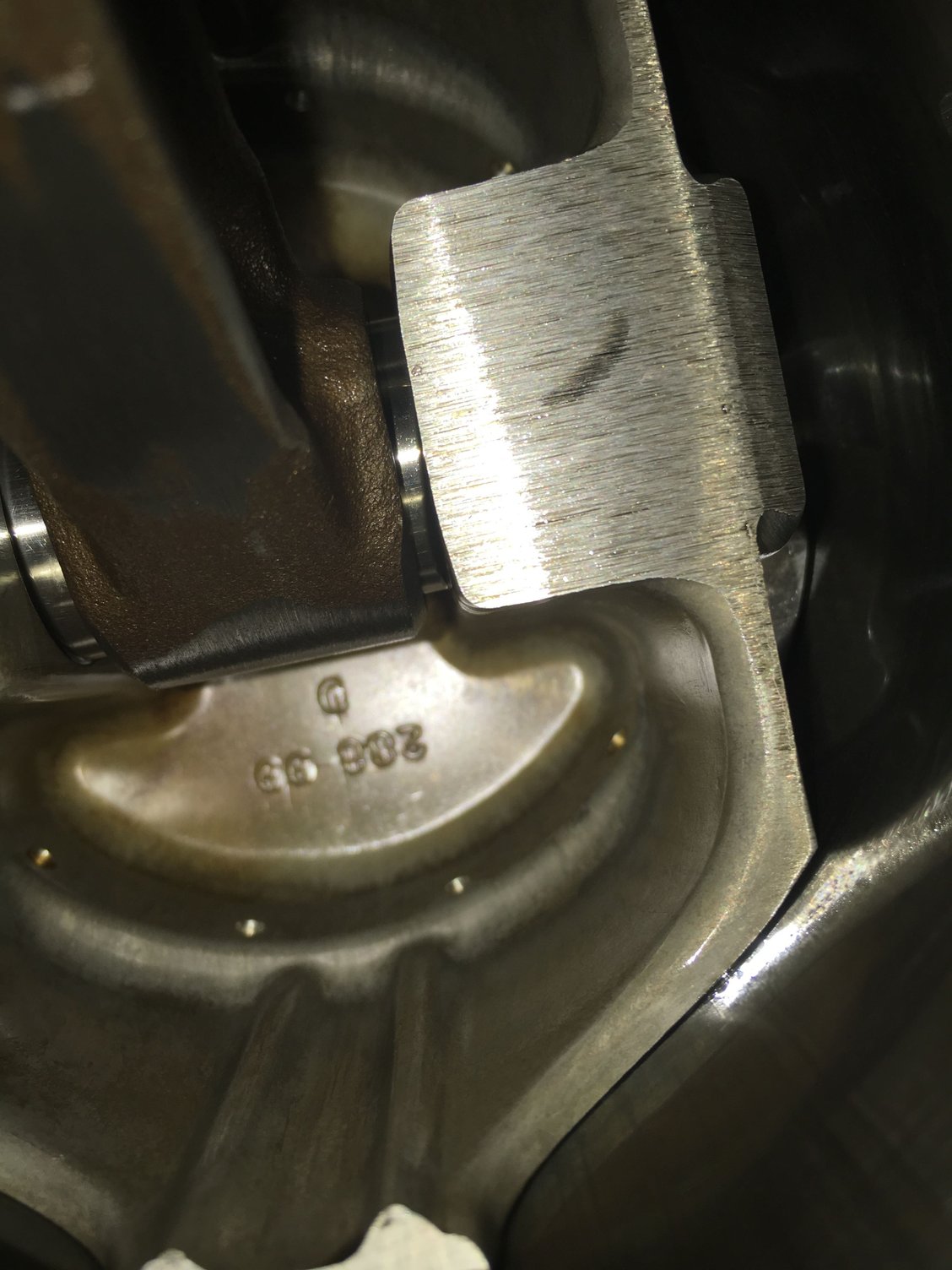

ok thanks I will get the head casting number and try to borrow one of them scopes to send down the spark plug hole. really didn't want to pull the heads yet but I will if I have to. Can I just measure the thickness an diameter of the springs? where is the casting numbers on the pistons.
I have a number from inside of the piston when I was looking at the crank will that work it is 238-99 or 288-99 with a D under the number.

Here is the piston from under side

Piston Part number may be stamped/laser etched into crown.
fwiw, piston looks like it's a TRW/SpeedPro Forging.
When full closed, measure spring OD (OE's about 1.22-1.23") ... height from head to bottom of retainer (OE's about 1.7") ... wire diameter. (OE's about 0.17-0.18")
Cam ... measure both intake & exhaust lifts at lifters or at retainers
