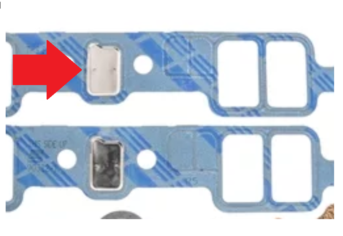

AND Bubba hasn't installed these-

Another possibility is that the cross over in the intake is plugged and so no heat? Pretty typical back in the day on all low use small block cars.

And it's not so much the question of whether you are using a gasket which blocks off the crossover channel, or not; that is only of secondary importance IMHO.

But if the OP really wants to see if the crossover is blocked he can remove the choke housing and use a coat hanger to probe down the intake towards the head and if if blocked it will stop at the gasket or go further into the exhaust crossover on the head if open.
How exactly is this "Bubba" if it has been proven that blocking this off solves more problems then it creates? I would deal with the longer warm up rather than the extra 100 degrees the miserable heat riser setup soaks into the manifold WAAAAY after the choke is warm.....in fact in Texas, if I reseal your manifold I absolutely will not install an open gasket.....if you insist on it, take it to someone else.
To the OP....you are in SC......and it appears you have a nice original setup, so the choice is yours but I know it gets pretty hot out there in the summer.....
Also.....have you verified the stock choke stove/actuator is even working properly?
