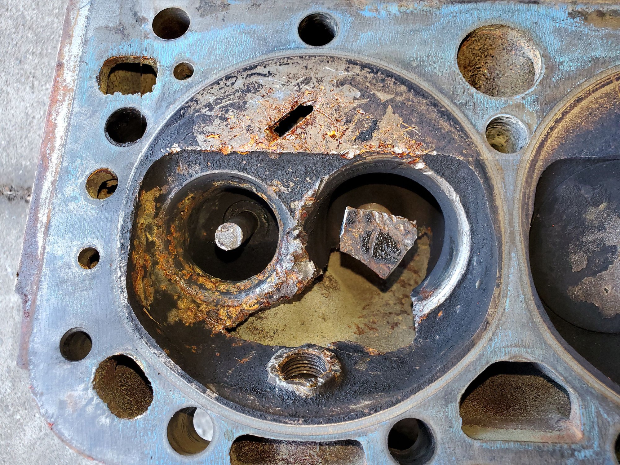

My 882 heads:

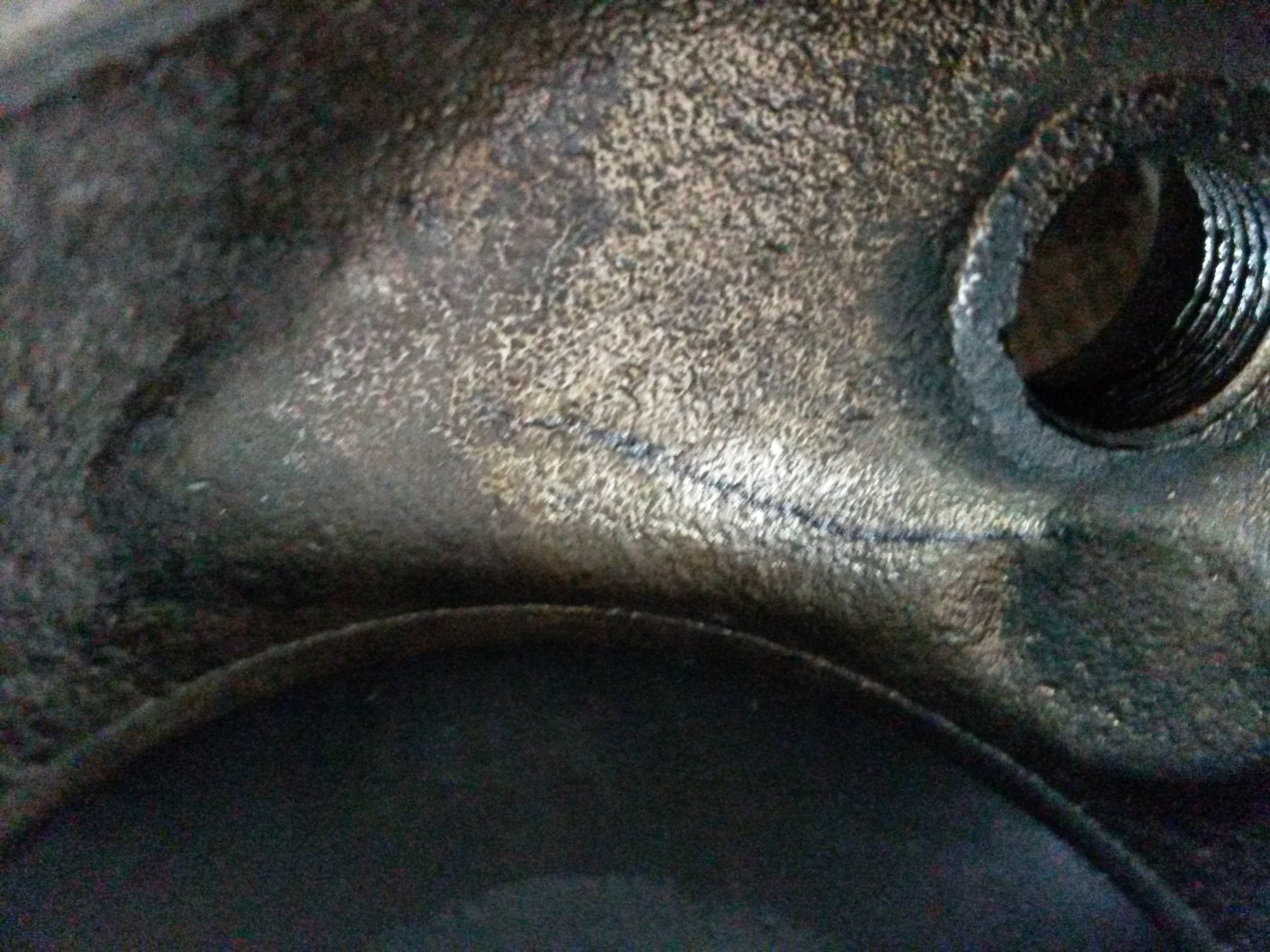

Heck I can do better than that. Here's mine!
