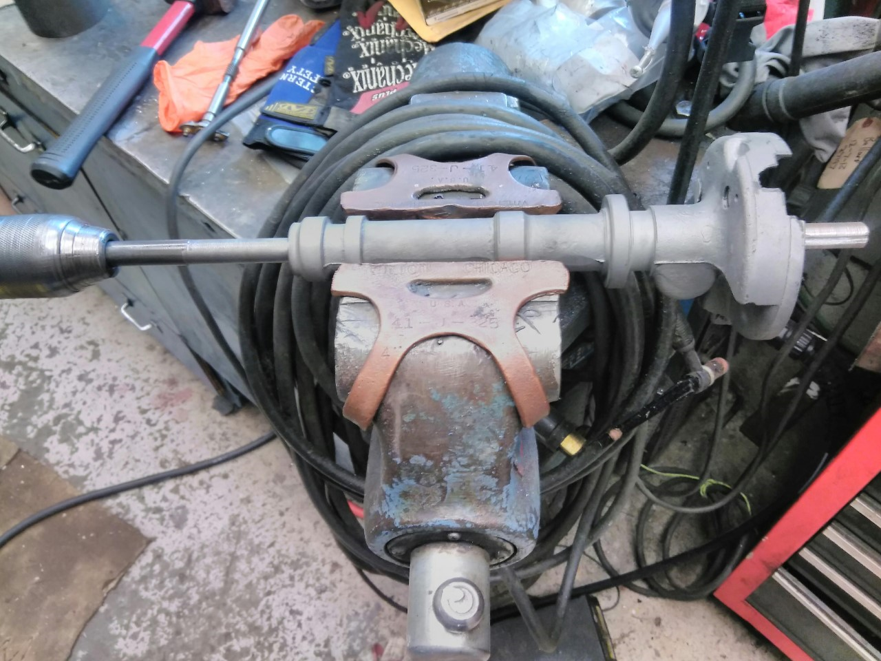

Old Apr 17, 2020 | 10:04 PM
Gale Banks 80''s Avatar
Gale Banks 80'
Joined: Nov 2008
Posts: 3,717
Likes: 551
From: Seattle Washington
So this is how I did mine. The new Bushings were tight on a new shaft right out of the box. They were snug when pressed in the housing. For the most part the Shaft really didn't want to go in at all at first. I took a piece of round bar and turned it down on my lathe until it was loose to fit. Then I took a Cut of Wheel and scored a line down the shaft 3 inch's or so. Then with a Drill Motor turning the Mandrel the scored line acted as the cutting surface and it slowly opened up the bushings. The bottom of the top bushing where the 1/2 moon is cut out needed the most attention. It took about 30 minutes of Honing a little at a time to open things up. If I was to do this for a living I would get a real Mandrel.
