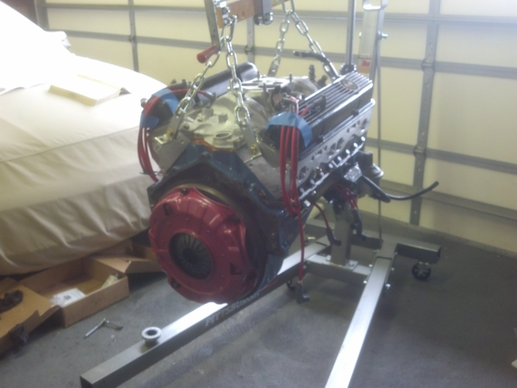

If you cannot get the tranny to slide into the clutch easily especially for the last couple of inches despite your best attempts at aligning the 2 components using the alignment tool (DON"T USE THE JUNK PLASTIC TOOLS THAT COME WITH THE CLUTCH KIT), then hook up the clutch linkage to the clutch, have a helper go into the car and step on the clutch pedal which will release the clutch from the flywheel, magically, allowing the tranny shaft and the clutch some movement and they will easily slide together. I am astounded you rarely see this easy tip mentioned. The toughest part of the clutch replacement is getting the 2 components to mate together once the new clutch kit is installed. The rest of the procedure is pretty straightforward.....
This step should be stated in every clutch kit instruction and it is NOT.....................

Although with this trick you can actually make the junk plastic tool work - it can get you close enough if you are careful with it. I have an old input shaft I use with a Muncie/Sag. With my Tremec I had to use the plastic junk. Just use it to get it as close as you can - it takes some feel - and then do as JB78L-82 describes to get the tranny to seat.

I used the plastic alignment tool that came with my kit and spend hours trying to get the tranny and clutch to slide the last 2 inches. I even pulled the engine out once to make sure the clutch was installed correctly (I rebuilt the engine at the same time).
Not one person mentioned the stepping on the clutch inside the car after hooking up the linkage. I found the tip on a suburu forum, of all places, searching the internet. Forget about all the other ideas about using long bolts in the bell housing etc. Just do this^^^^^^^^^^^^^. The tranny and clutch slide together once the clutch pedal was pressed on. I was SO PISSSED no one told me that tip..........

Unfortunately for me, I tried the 2 guide bolts suggestion as well on my install and no go...the only thing that worked was stepping on the clutch pedal and sliding the 2 together........

Engine was out for the rebuild and changed the clutch at the same time. When I could not get the tranny to slide in BEFORE the engine was bolted in and all hooked up, I decided one time to pull it back out over the front fender to check everything was correct with the clutch, pressure plate, throwout bearing, flywheel etc......
