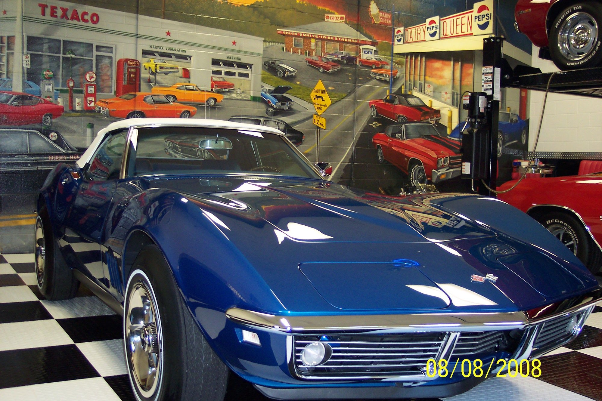

I have a 68 L79 .. fully restored .. after warm up, oil pressure @ idle reads 0-5 psi .. @ 2000 RPM reads 30-35 psi .. I checked the actual oil pressure with a remote oil pressure gauge, and it is fine .. removing/rebuilding the oil pressure gauge is quite a chore .. question: what do others see on their gauge @ idle? (I'm assuming my gauge is in need of rebuild ..) thanks for any comments
